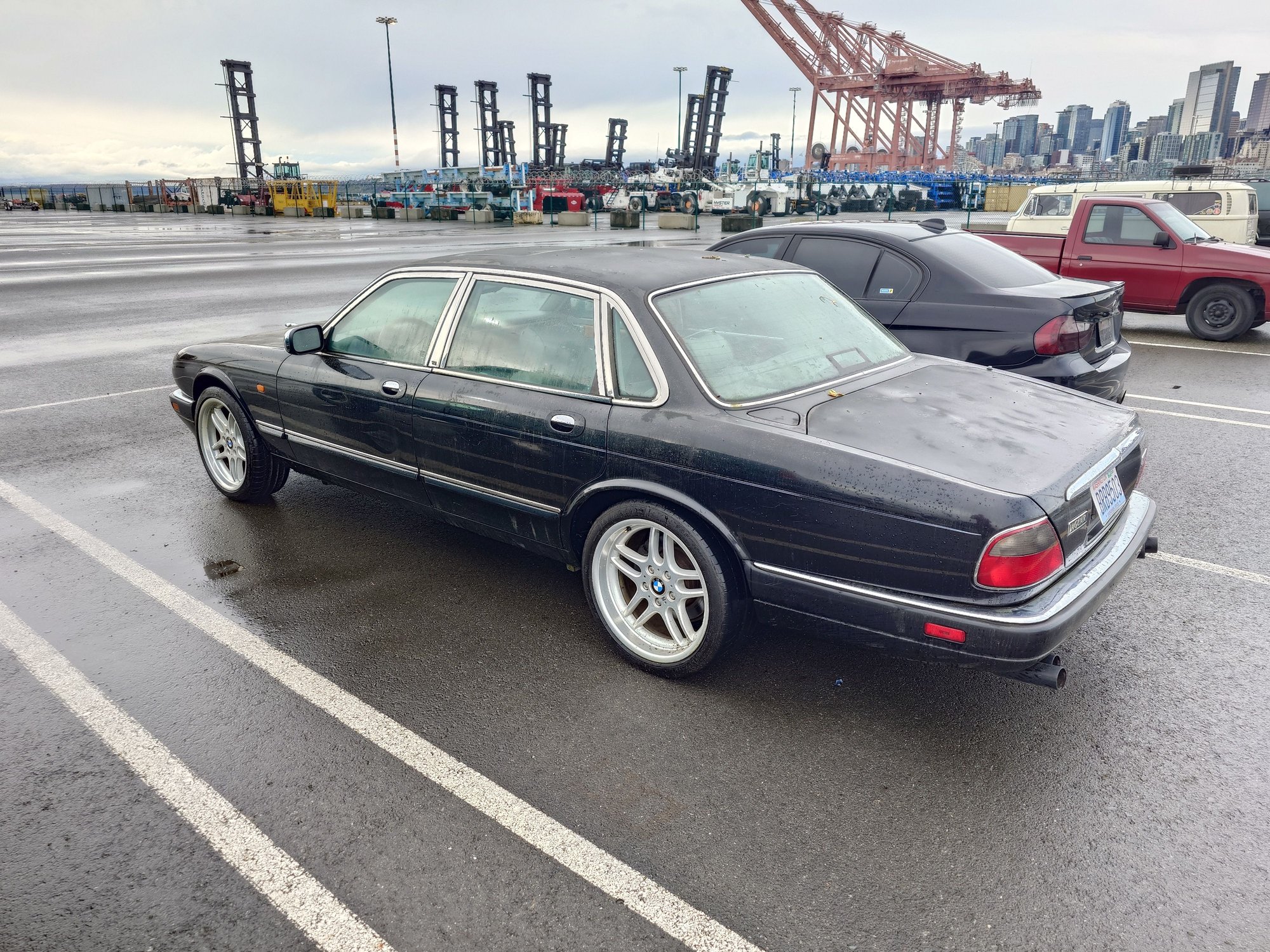

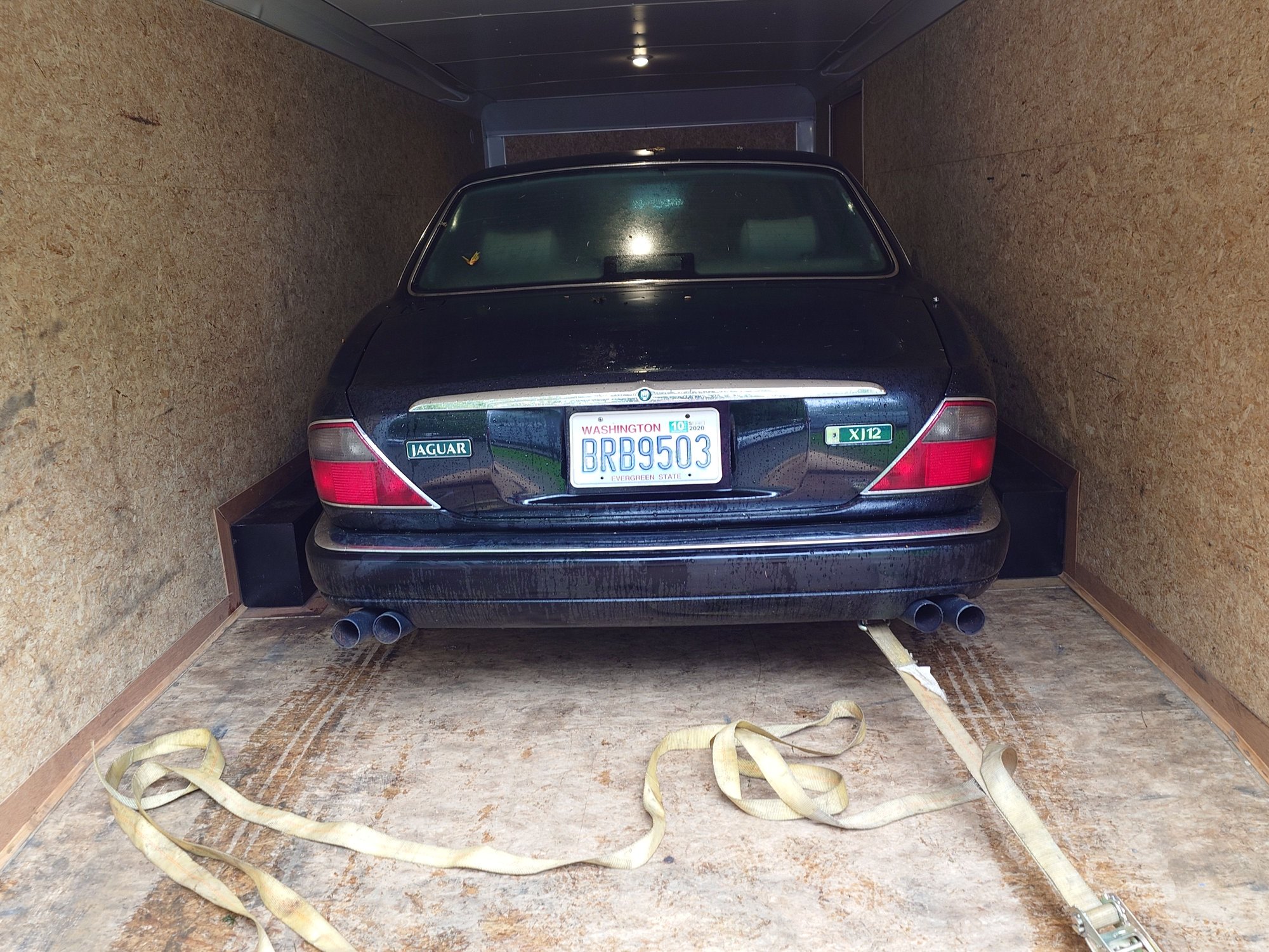

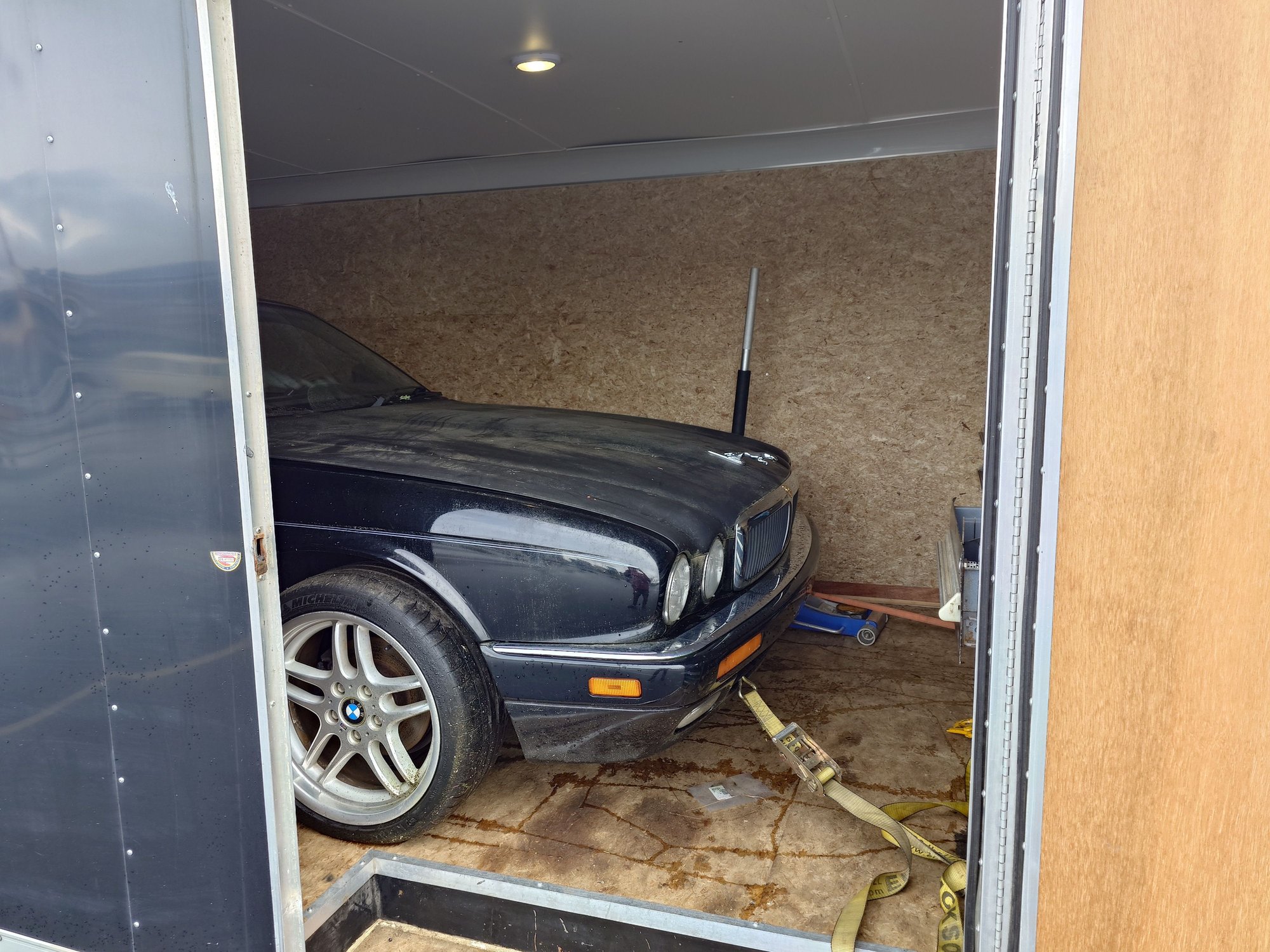

unfortunately I don't have many photos. The car went right to storage for a month while I am away for work. I will get to fiddling with it when I get back.
I do have photos from the ad.
Then from loading it into my trailer.

Curious about your experience with the 5x120mm BMW wheels on 5x120.65mm hubs.
Old Apr 14, 2025 | 09:42 PM
MTBMax's Avatar
Joined: Apr 2025
Posts: 4
From: Sequim, WA
not a clue, came that way and I haven't dug in. I am curious as well
