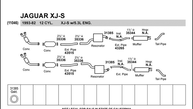

BTW is this the correct exhaust diagram for the 1992 XJS Diagram attached.

did the exhaust ever change? I would assume maybe it did for the 6.0, but I don't think it changed for the 5.3, so that should be all correct.
Basically the same but there are two types of joint, spherical joint and slide joint. I think yours has slide joints, so if you are going with the OEM ones, it would be better for you to make sure that you are buying a correct exhaust which has correct joints.

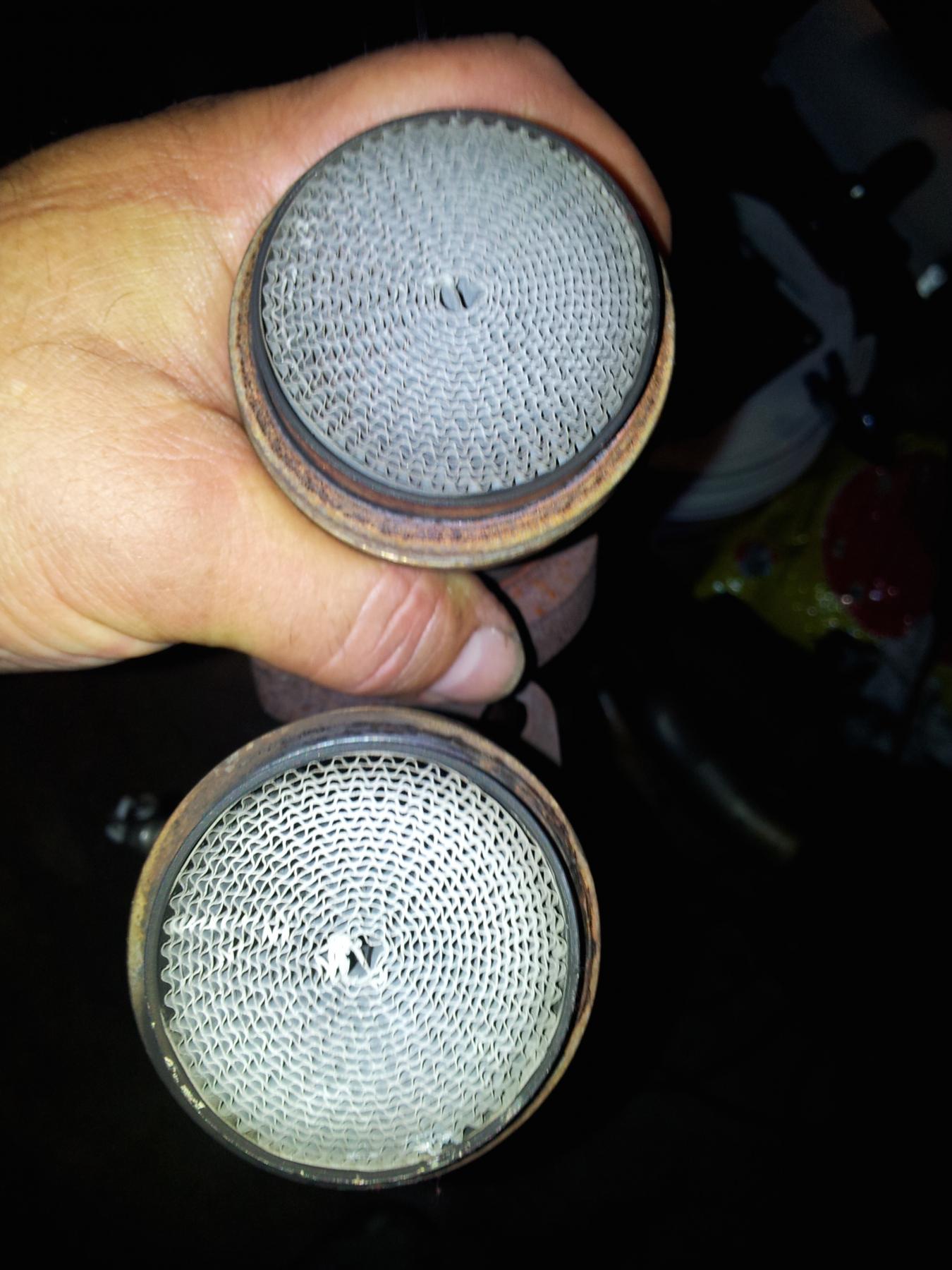

There are also honeycombed inserts at the top of the downpipes which need to be deleted. These have become commonly known on various Jag forums as "preheaters" for the cats (see photo). They're very restrictive and can clog in portions. The downpipes must be removed from the manifolds in order to deal with them. If I understand you correctly, you are going to have the cats in the downpipes replaced with high flo cats. Make sure the muffler shop welds them in such a way that you have (relatively) clear access the the studs on the manifold, for future removal and installation ease. Also make sure they leave you plenty of clearance to access your oil filter. The stock cats are pretty large diameter, so, access there is tight.
