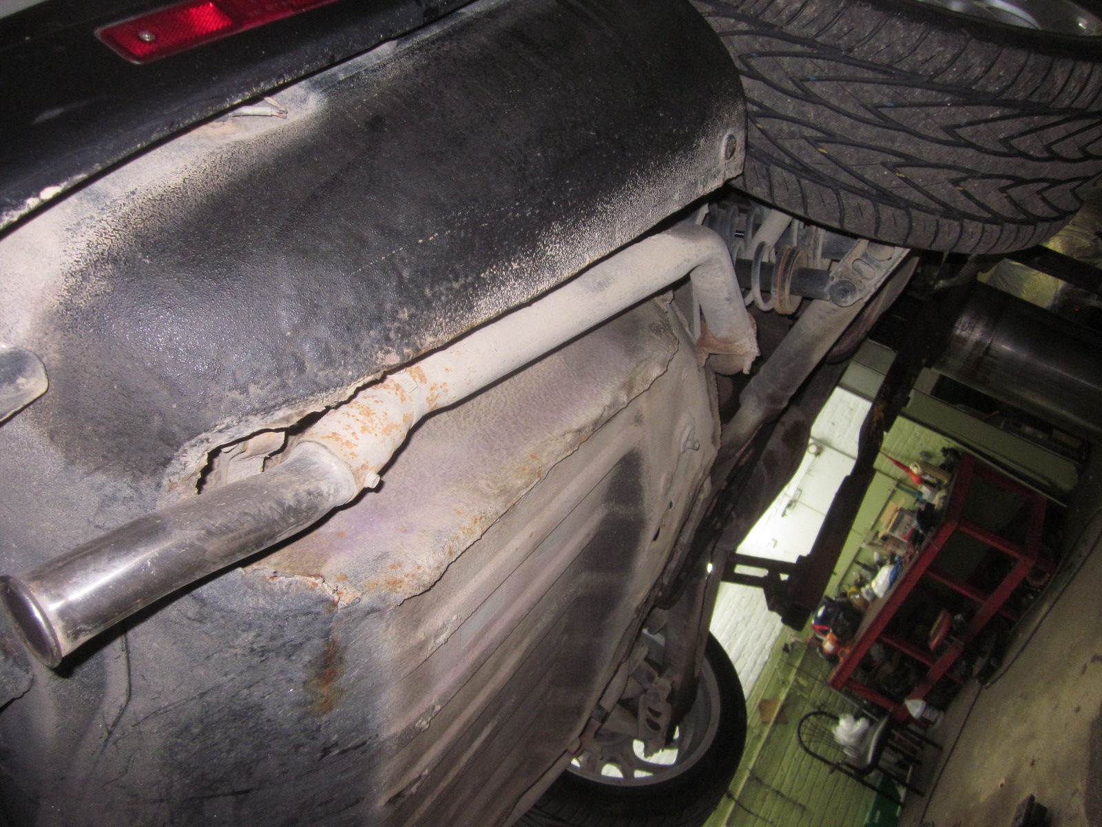

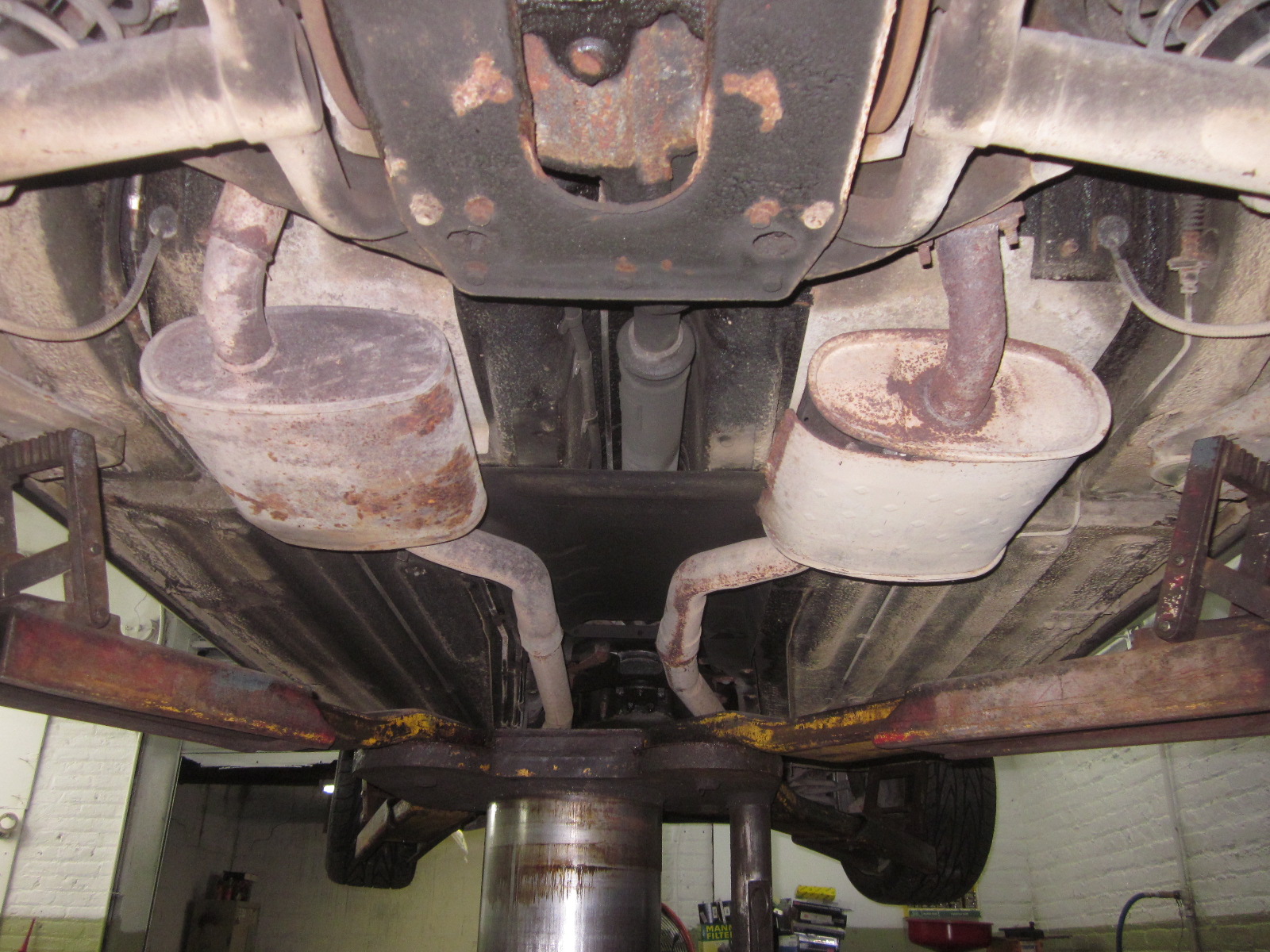

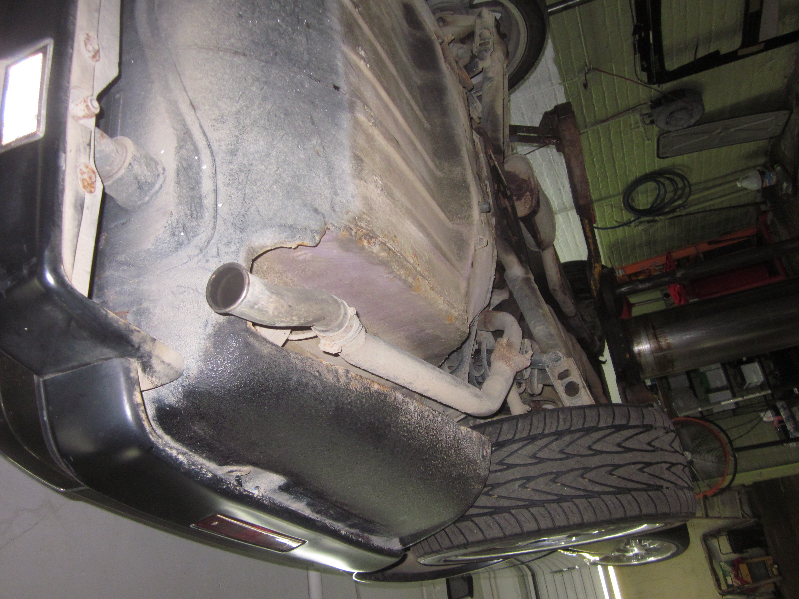

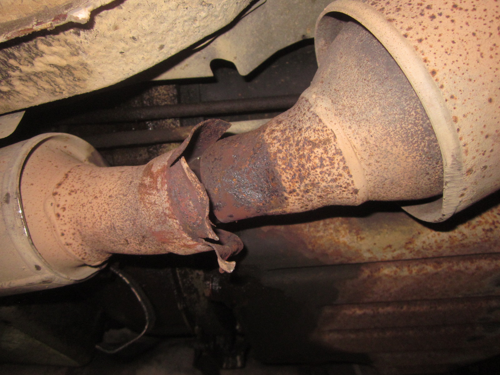

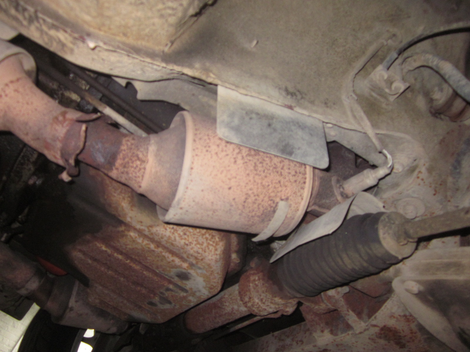

I didn't really have too much time to shoot or get deep inside the exhaust but here is a shot of how bad it looks now.
In one of the pictures you can see the ruptured part of the Cat. This happened while I was driving.
As I just noticed today as I haven't looked under her too many times the resonators have already been deleted.
Attached is also a picture of the car outside of the mechanic shop while I was waiting to be towed. She's not so ugly as what's currently under her. haha

Guys so about to get the work done. Buying my own parts mostly but the muffler shop I went to that is doing the custom piping is asking for almost $600 in parts in labor for just pipes alone.
That includes the exhaust pipes running back from the Cat to the muffler, the delete pipes for the tail pipes and the tips.
So parts and labor for this section would be $250 for exhaust, $250 for tail pipes and $100 for chrome tips.
Doesn't factor in my Cat and Muffler. I'm buying those myself and they'll just be charging me for labor. They're using aluminum or aluminjzed steel for the pipes.
Is this too much for those type of pipes?

wow, that certainly took some backpressure to blow out like that. Will probably run completely differently after.
soo its 600 plus your decision on cats and mufflers? So depending on what you get it will be around 1000 give or take a bit? Those tips can probably be cleaned up if you still want them, but if you are getting bigger diameter pipes maybe you don't want them....
Consider checking ebay and craigslist for mufflers. Many people buy them and move on to louder ones or quieter ones and sell theirs with little wear. Don't buy used cats.
You can also take your pics and estimate to another shop to see if they can give you a better deal, without having to tow the car again.
Even if that is it, compared to buying any other system, the minimum is usually around $1300 for an XJS, uninstalled, usually without cats. So you are saving at least $500 if not more. That is quite a bit of savings. A grand probably feels like a lot right now, but it is an old car in a northern state, and after this you won't need to worry about the exhaust for a very long time.
