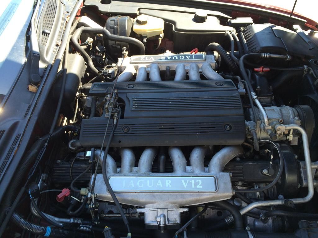

Unplugged the MAP sensor to see if it was throwing off the computer enough to cause no power. Nope, ran just the same. Had the car towed on a flatbed 50 miles home. Once there, I looked around everyone more closely. Opened and closed the throttle linkage, checked for movement everywhere. I noticed something strange. It seemed like there was more movement on the LH side of the engine than the RH side when the throttle was operated.

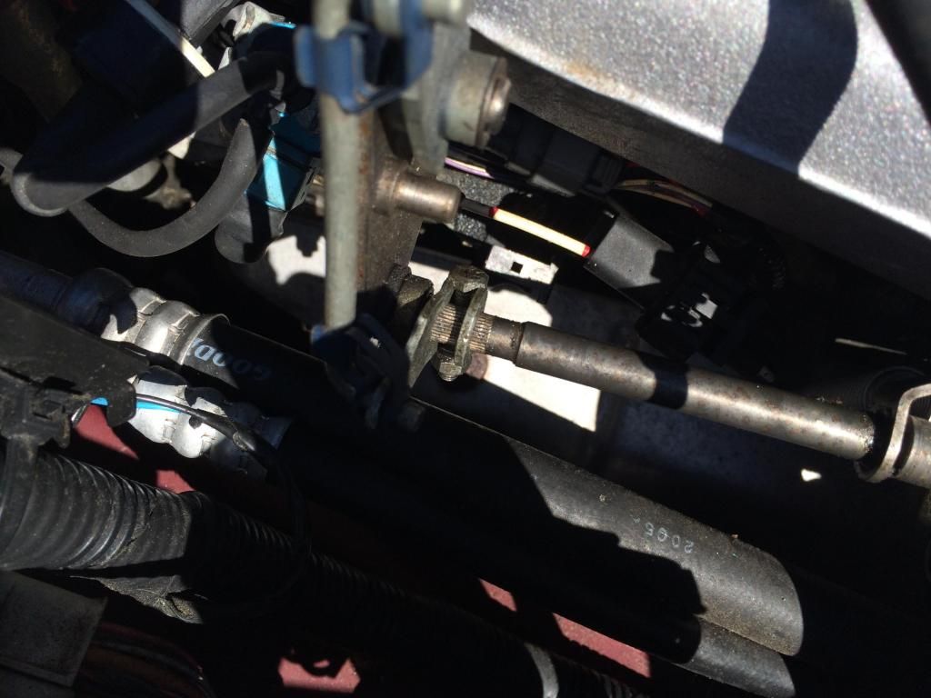

Looking closer revealed that the "throttle lever" clamp, which is tightened down on the splined throttle shaft on the RH side throttle body, was just spinning on the splined shaft when the throttle was operated. Bingo! Tightened the locknut with an adjustable wrench, and in ten minutes, the car was reaching 5000 RPM and had life in it again.
The LH throttle was opening as it should, while the RH throttle was always closed. This is the cause of the MAP P0106 code. The throttle position sensor was telling the engine that the car was at WOT at times, while the MAP sensor was seeing very high vacuum instead of very low vacuum, like it should've been if the throttle was wide open. Reset the CEL and it hasn't come back on ever since.
It's funny how a stupid little 8mm nut can bring a big mighty V12 down on it's knees. It was even worse than just running on 6 cylinders, it was more like running on 3. I put the car in Drive after the nut tightening, and stomped on the gas, which chirped the tires a bit. That put a big smile on my face. On the drive back home after leaving the tow driver to his thing, I was thinking what did I get myself into. It's all SO worth it now.
And this is the throttle linkage that was loose. The little "throttle lever" (as it's called in the parts diagrams) was loose, and just spinning on the splined shaft, instead of twisting it, leaving the RH side bank at idle all the time. Drove the car on the highway after getting the car registered, drives just fine at 65mph down the road, transmission shifts silky smooth now that the engine is running on all cylinders.
