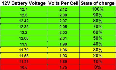

I would start with a simple battery test.
There are shed down relays in those series cars.
Is your battery new? Do you keep it on a charger?
Anything less then 11/12 volts, the car will do strange things.
If the battery is over 4 years, replace it with a acid standard battery, NOT AN OPTIMA, they do not hold up well.
Good luck.
Also ground and moisture issues but start with the battery.
GTJOEY1314
CLEAN THE GROUND CONNECTION AT THE BATTERY AS WELL.

OK will do checked bat v 11.77 v. cleaned terminals 850cca about 2 yrs old..thanks keep suggestions coming

A fully charged battery is 12.75 volts

Ok I will put charge on it and load test thanks for the information
