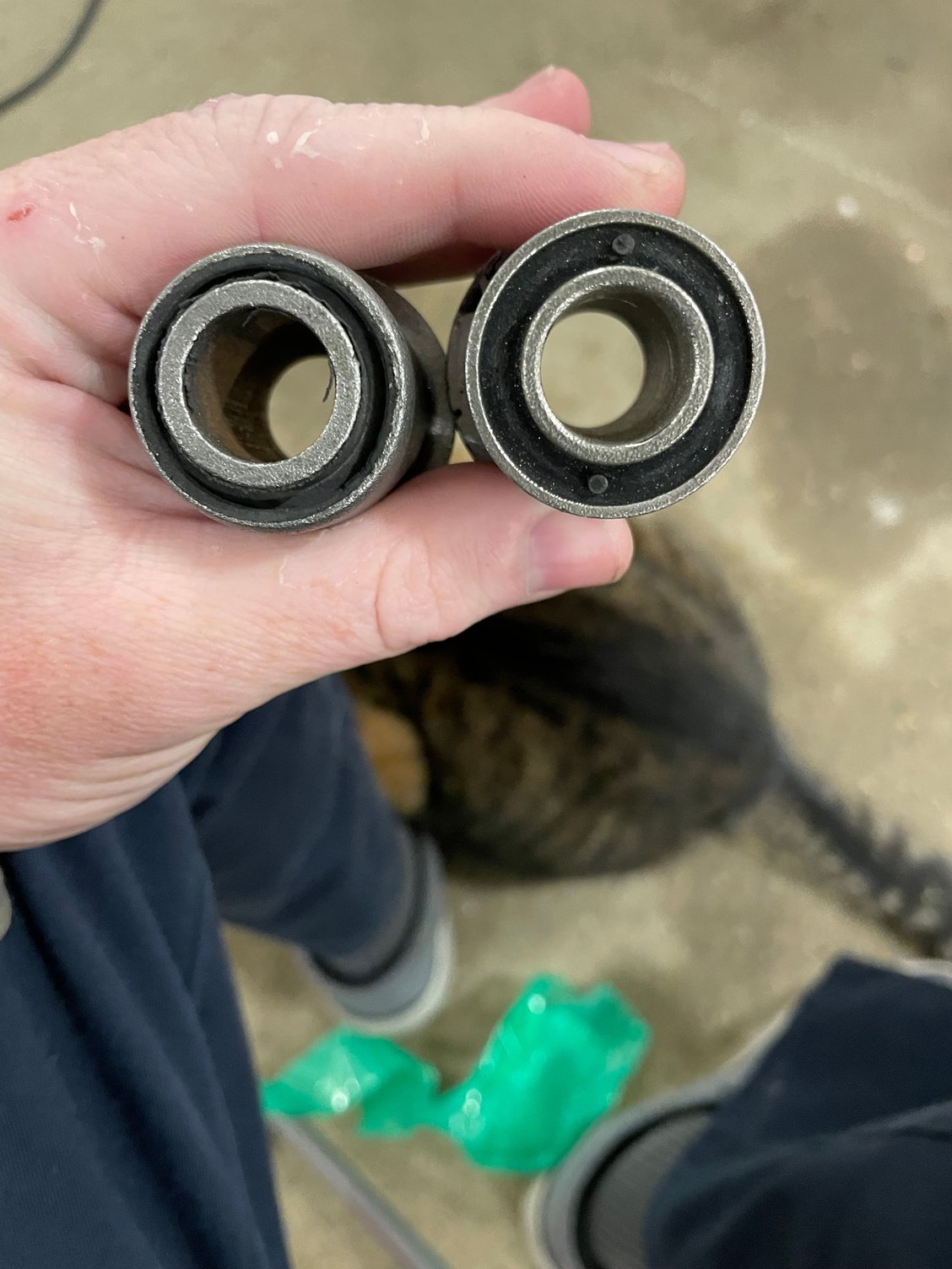

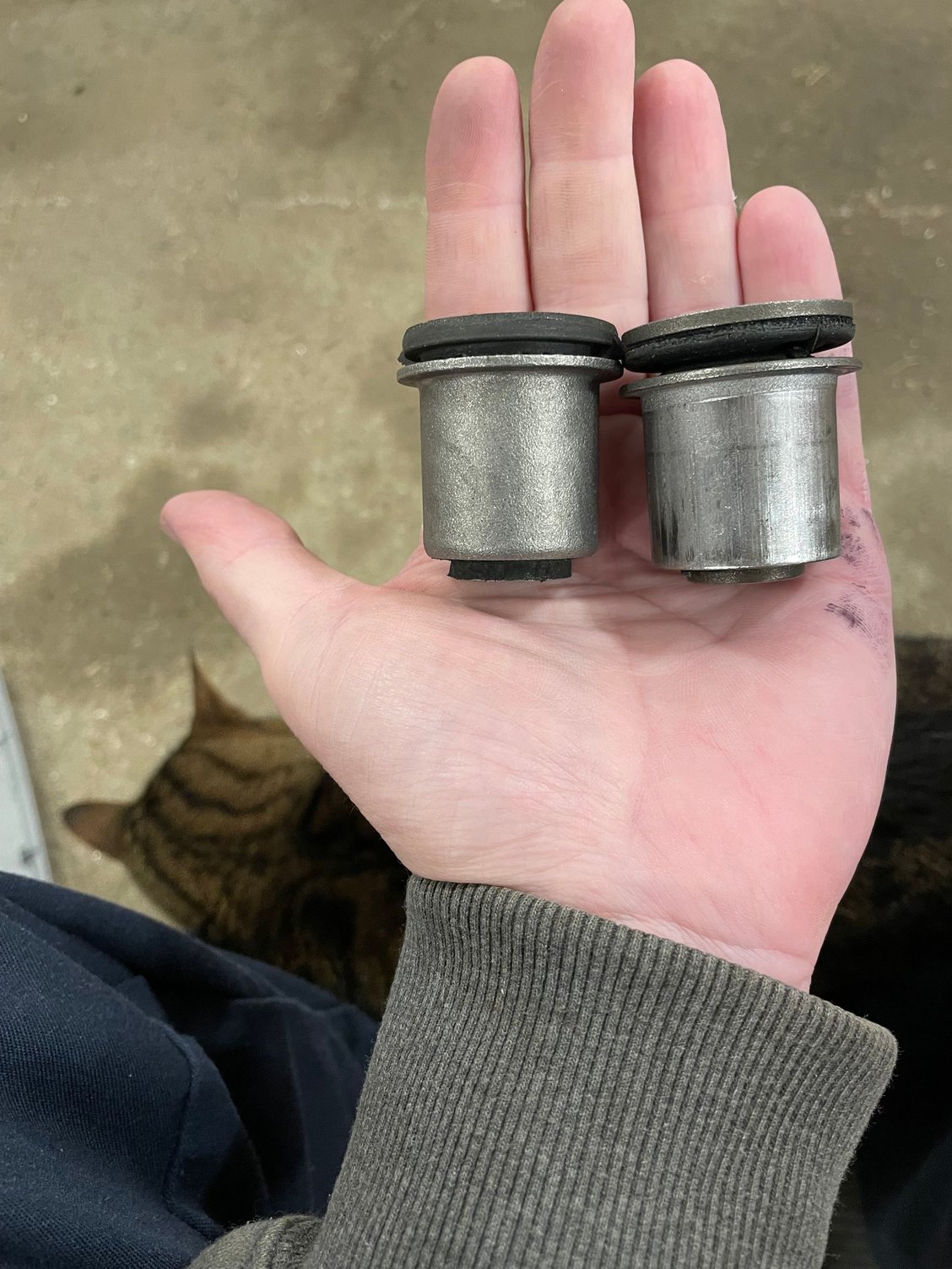

Old Sep 27, 2023 | 06:17 PM
Jagsandmgs's Avatar
Joined: Mar 2017
Posts: 699
Likes: 415
From: Jaffrey, NH
Genuine in Jaguar bag on right, repro on the left. The only bushings marked Metalastik was the lower shock bush. Overall length of these upper bushes are the same, but Jaguar version has more sticking out the top and less sticking out the bottom.

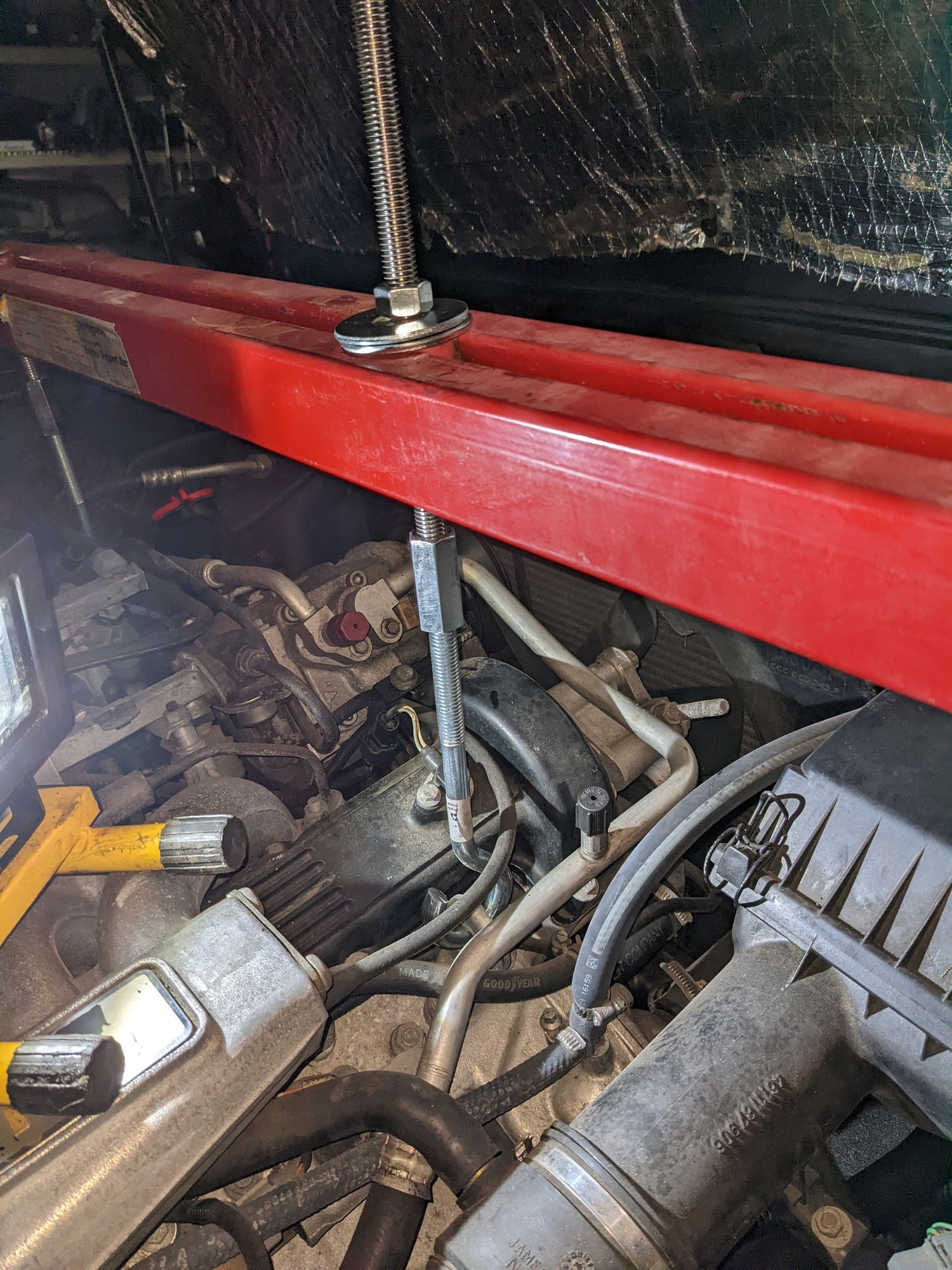

Originally Posted by 944play
Maybe not as buried as engine mounts, but you do have to drop the subframe (and support the engine somehow). Not sure about the details, but I know it was a very expensive job when I paid to get mine swapped.
Harborfreight engine bar. Perfect fit.
in second pic you can see how I made the hooks to support engine mount attachments. Don't use chains.
Old Sep 28, 2023 | 06:02 PM
Jagsandmgs's Avatar
Joined: Mar 2017
Posts: 699
Likes: 415
From: Jaffrey, NH
I like the crossbar. The one I have is not nearly as nice. It only has one central threaded post, so I had to use chains.
