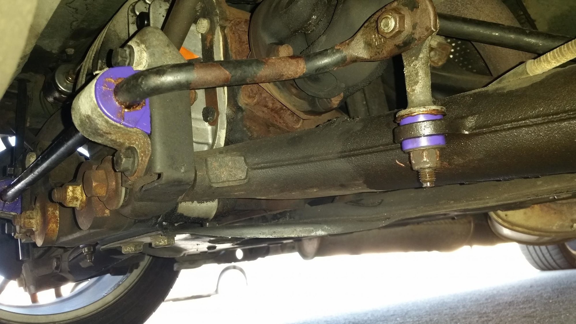

Oliver ,
I get confused when the term sport is used on the X300 series
Does it refer to the stirpped down " Executive " model in Europe ?
I hear the term sport used in reference to owners referring to US models
I do not own a V12 version but a normally aspirated inline 4.0 liter AJ16 in a Sovereign
To go into detail from what I understand and what you are trying to obtain venturing from the original factory package . Since you are dismantling the components you might consider Andy links for the front suspension and the upgraded rear suspension Bushed differential strut used and obtained from the later X308
https://parts.jaguarlandroverclassic.../brand/jaguar/
Hit the small box icons for the part # and notice the different bushing densities ( notice the sport and comfort terms ) if it makes much of a difference in a central suspension geometry component , the bushings can easily be replaced and available
I have not installed my X308 rear differential strut on my X300 yet but the upper mount bolts are different and has a clip nut vs. just a nut . Whether this make a difference on installation I have not determined but others have gone through it in posters like " cdma " so grab the hardware at the salvage yard
https://www.jaguarforums.com/forum/members/cdma-143139/
The mass of your V12 being heavier has a consideration on your suspension components like the bushing densities close in geometry into the engine mounts in my opinion which may include the Vee mount bushing
https://www.jaguarforums.com/forum/x...rience-130749/
Rear sway bar

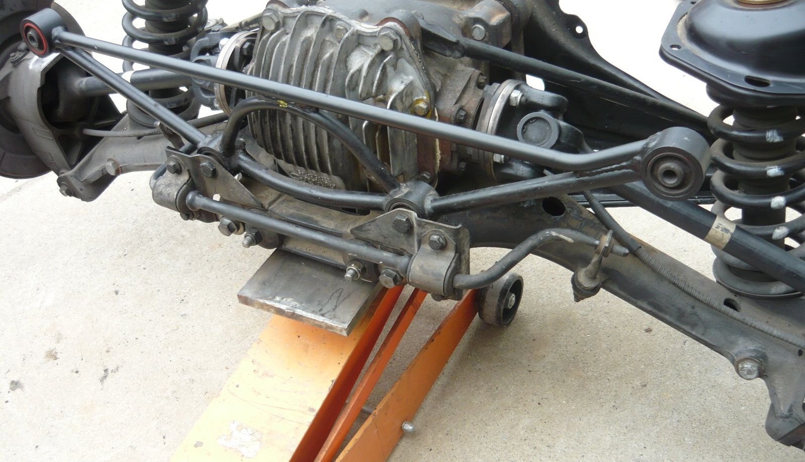

Hello,
I've watched this post drift into suspension types.
I think I have a good idea now what to do with this '96V12 I picked up. The shocks are toast, and car rides like a boat on water.
I first thought about swapping on all 4 shocks from a parts XJR6 I have. Then here, I found the R has better (stiffer) springs too.
Then the rear away bar was discussed.....Hmmmm.
So, I think the way to go is to put the whole rear suspension from the R in, and swap in the front springs and shocks.
The front sway bar is the same from both cars I believe.
Am I missing anything that would make this big car handle better? I've had good luck swapping parts on earlier models, such as V12 sway bar on a 6 car etc.
Thanks for helping me get this right.
Cheers,
Rob
Old Sep 1, 2019 | 02:44 PM
Robert Laughton's Avatar
Posts: 554
Likes: 190
From: Ontario Canada
I see that the XJ12's came with 3.58 diffs, and the XJR6 3.27.
I wonder if it's worth swapping the diffs so I can keep the 3.58, if changing the IRS complete from XJR6.
I'm guessing it is worth swapping, but that's more work.
Rob
