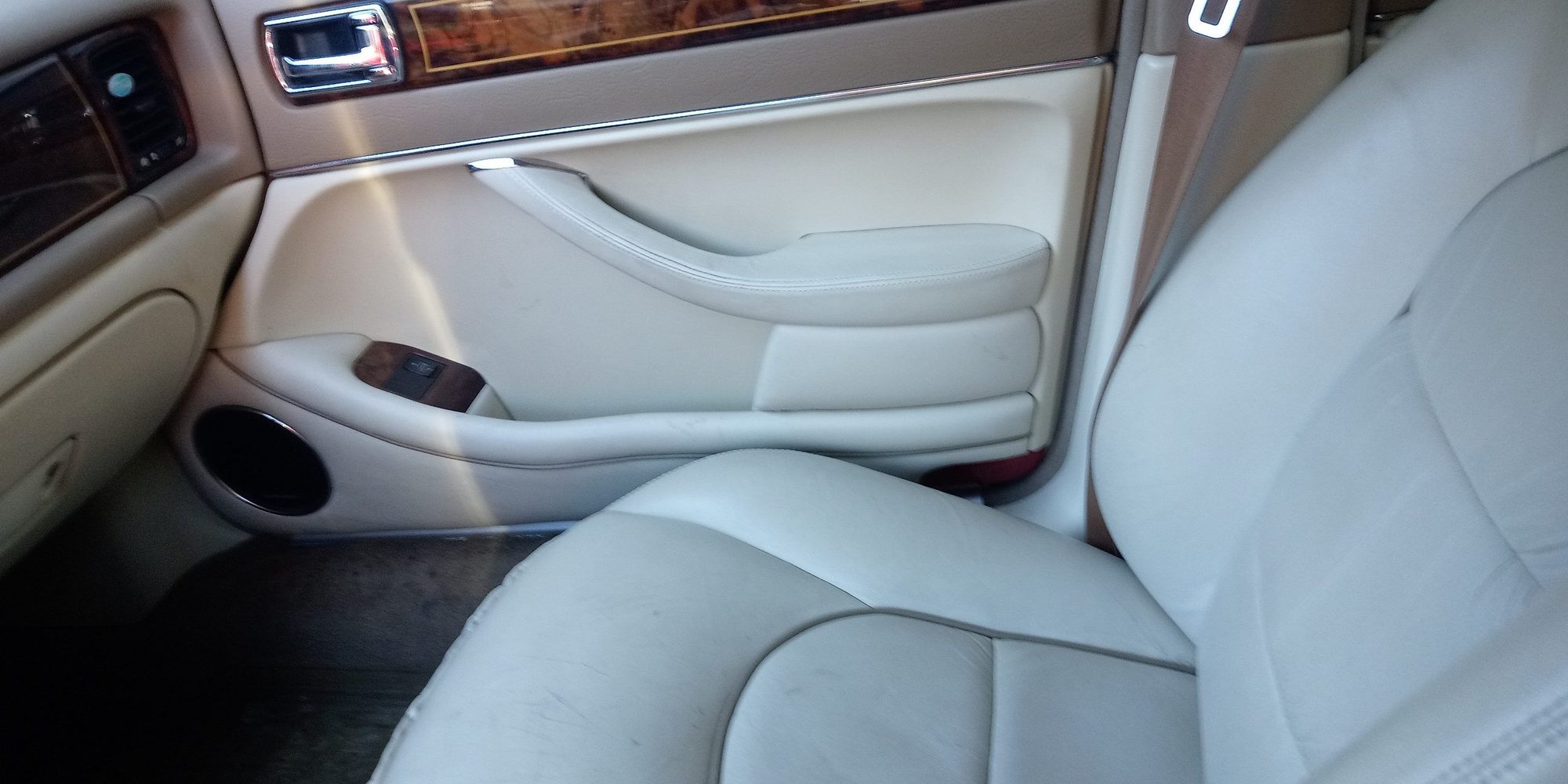

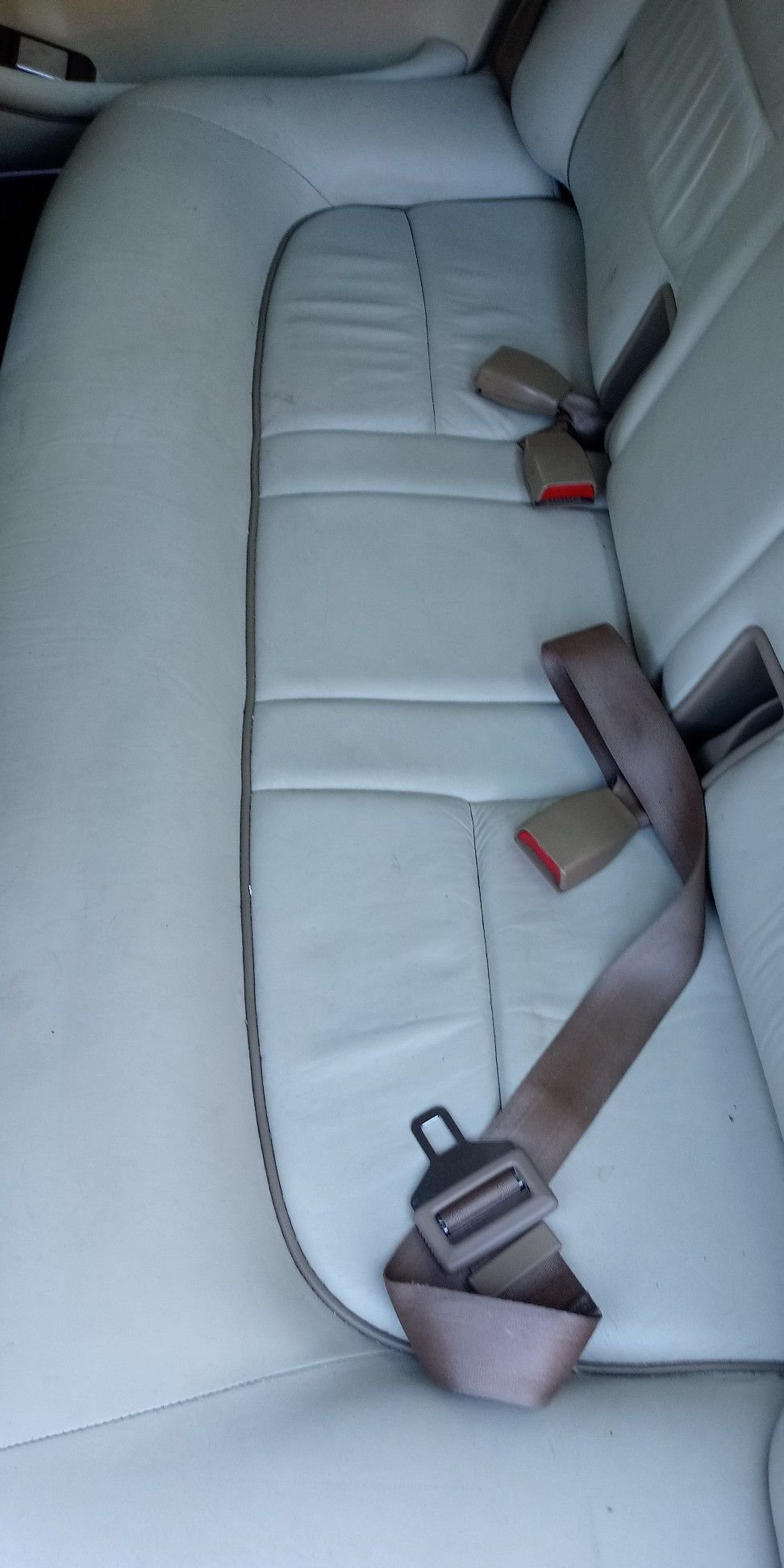

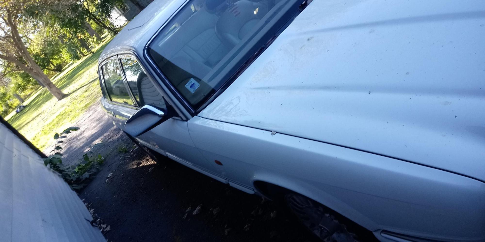

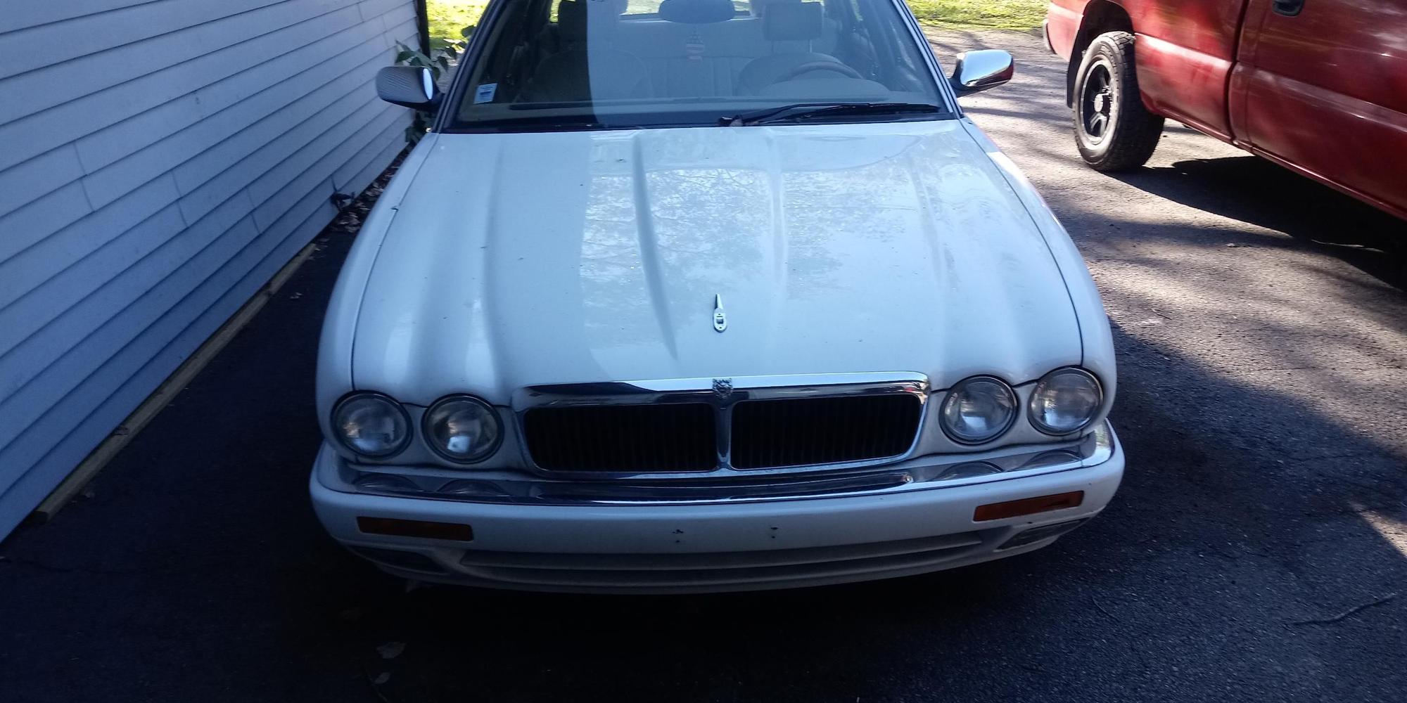

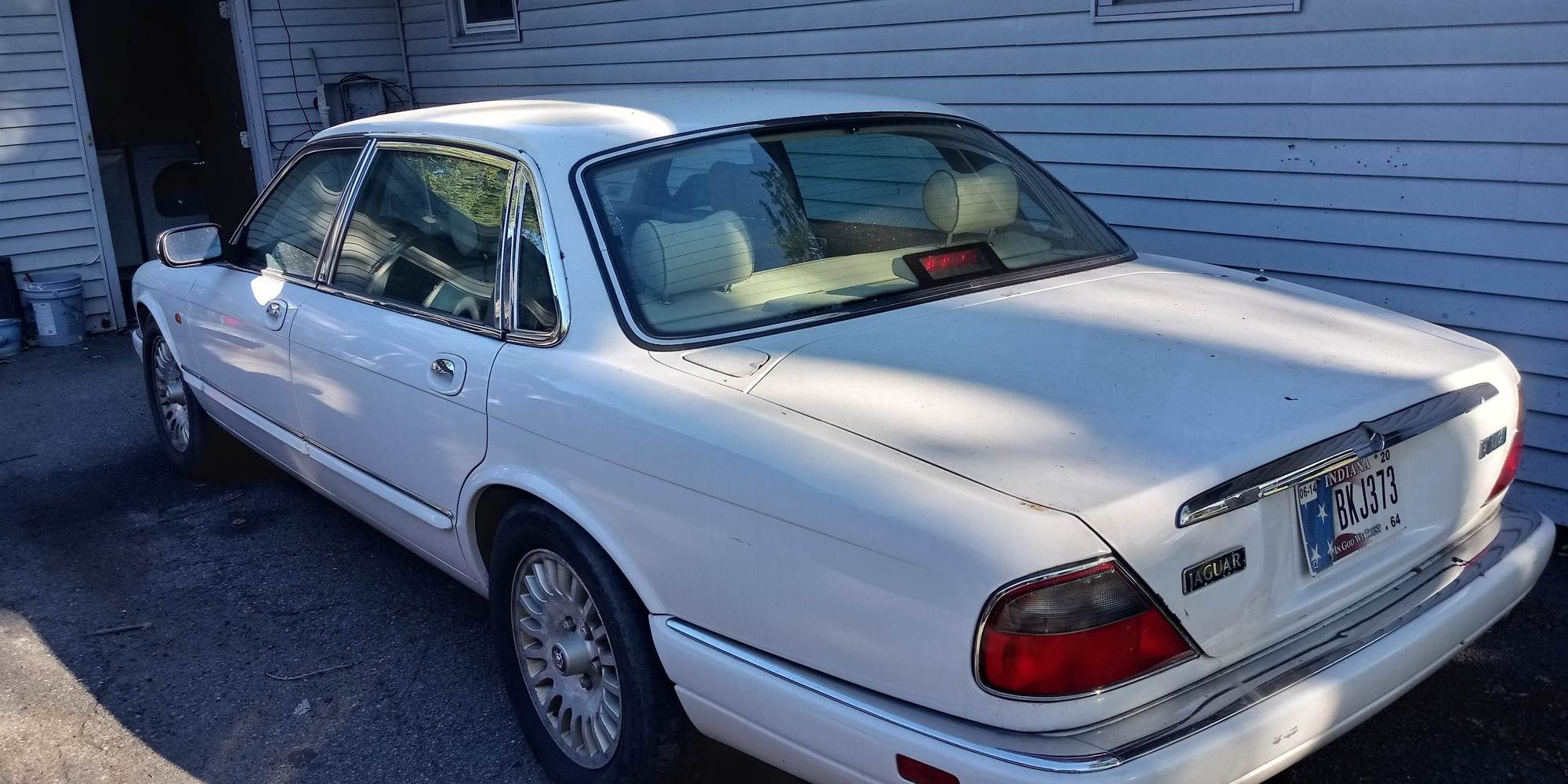

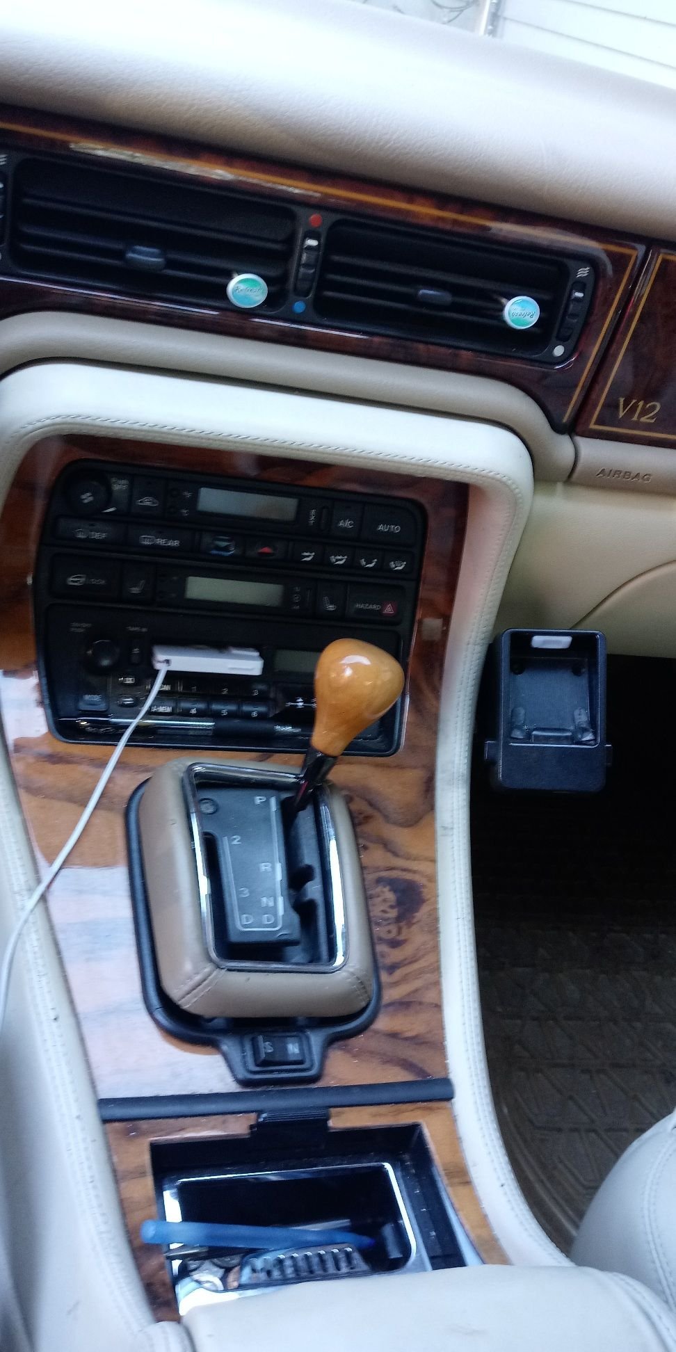

Hi everyone. I have been a forum member for some time but this is my first xj12. I have an xjs and xjr and have owned several other jags.
I purchased my xj12 in need of repairs which are underway. Not a perfect car but still a nice car with 110k miles.
I couldn’t pass it up I was faulty certain the non starting issue was something relatively simple
and it was. Turned out a tossed belt broke the cps wire. Bad harmonic balancer tossed the belt. So the balancer is off for a rebuild once I heard the engine run.
