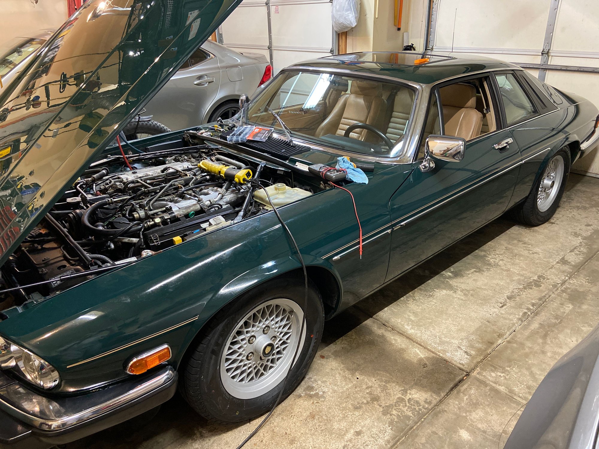

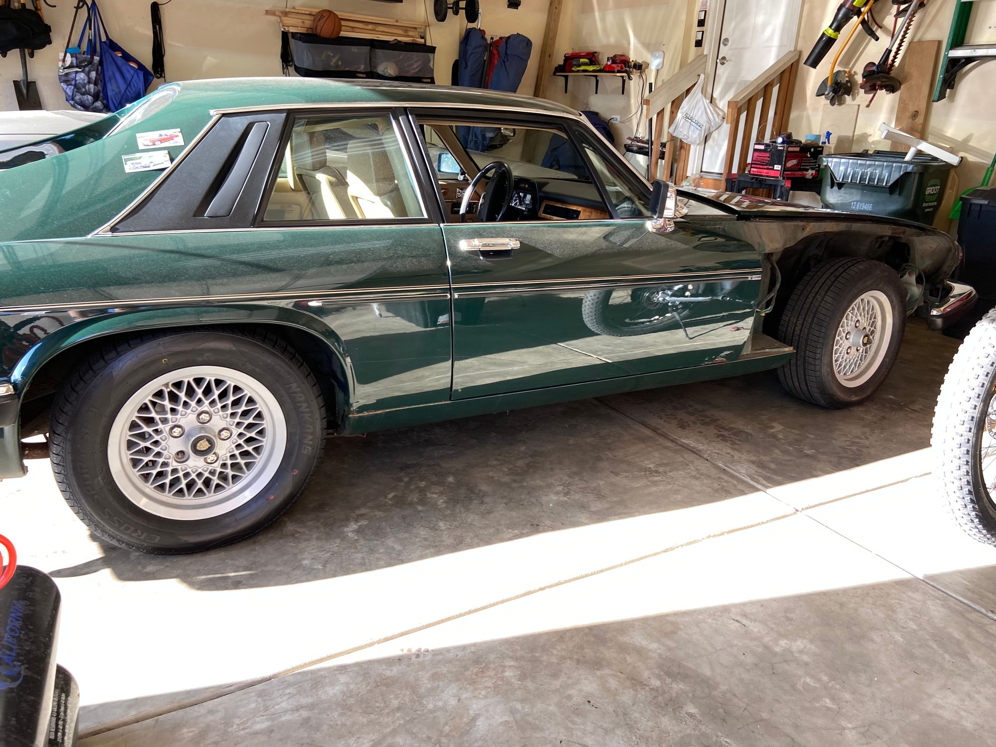

In the meantime I have my recent xjr acquisition and in going xjs project to contend with.

Oh, neat X308R! Love those rims. And I understand the allure of the classic series XJ-S versus the facelift. The 6.0 with the 4L80E is a good combination and would probably be real nice (better?) in the classic.
