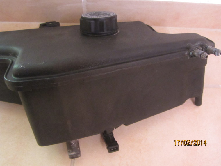

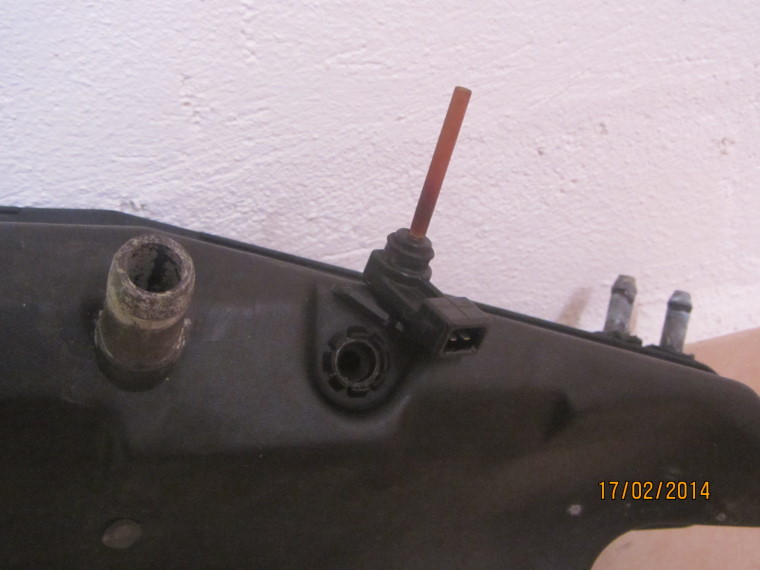

Hello Martin,
no, its not a unit. I just attach two pics, the one showing the reservoir from the bottom with the sensor standing above the hole to plug it in and the second showing the reservoir sideways with the sensor in the hole. (but not yet in the correct position!). Ensure that the nose on the sensor sits on the little notch and then snap the sensor into place. Thats all.
Best, Harald
Best, Harald
