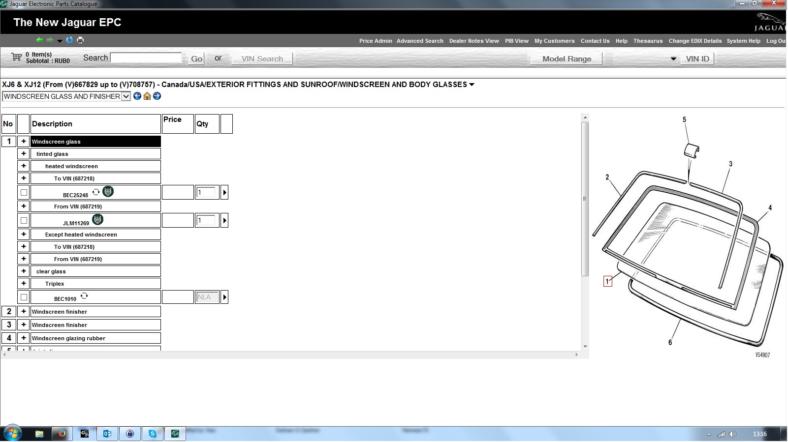

I just uncovered my car after years of sitting in garage and found the broken windshield. Not many places have this model, is there a good substitute or do I have to pull the frame and get replaced? Thanks for your help.
Old Jul 15, 2014 | 07:36 AM
Likes: 17,004
Welcome to the forum b4chicago,
Although the 12 cylinder is a rare model, the clear or tinted windshields are the same as the more common six cylinder XJ40 so it shouldn't be too difficult to source a replacement:
If yours has the heated windshield, it will be very hard to find now and you may have to compromise with a non heated one.
