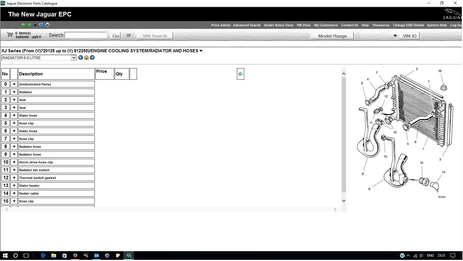

Andrew,
I followed that it's one of the 50 V12 Daimler Century vehicles produced to commemorate 100 years of Daimler at Coventry and that the task started with removal of the Radiator Fan Switch (item 11):
After that I can't work out whether you're asking about a PAS fitting or an AC fitting .......
The above extracts from JEPC show what is listed for both PAS and AC. Availability can be a different matter.

Hiya,
In the first picture you can see on the radiator the temperature switch (number 12).
Just above that are two aluminium threaded connectors. The top one is fine but the thread on the lower one is damaged.
The hose (which is part 5 in you middle picture) I have managed to salvage. Part of the aluminium thread was embedded in the thread of the connector (my guess is the thread simply just broke away when my Dad was undoing it). Using a tiny Dremel bit I've managed to remove the metal from the thread.
As I say a bit of a pain because my guess it's just a case of corrosion, I suppose if I was doing the job I may have sprayed some WD40 or similar on each connector beforehand (being the rad is at the front of the car and obviously gets all the abuse from the weather and elements). Unless it was done slightly wrong at the factory.

I see the relevant part now. Unfortunately not available from Jaguar who just buy in complete radiators.
Not a difficult job for a specialist radiator repairer and there's plenty on the mainland if none located in Guernsey.

I can think of worse ways to spend a day than driving around Guernsey.
According to JEPC, the original Radiator P/N CCC6168 is NLA and has been superseded. This suggests the later Radiator (P/N MNA4190FA) will fit the entire VIN range.
