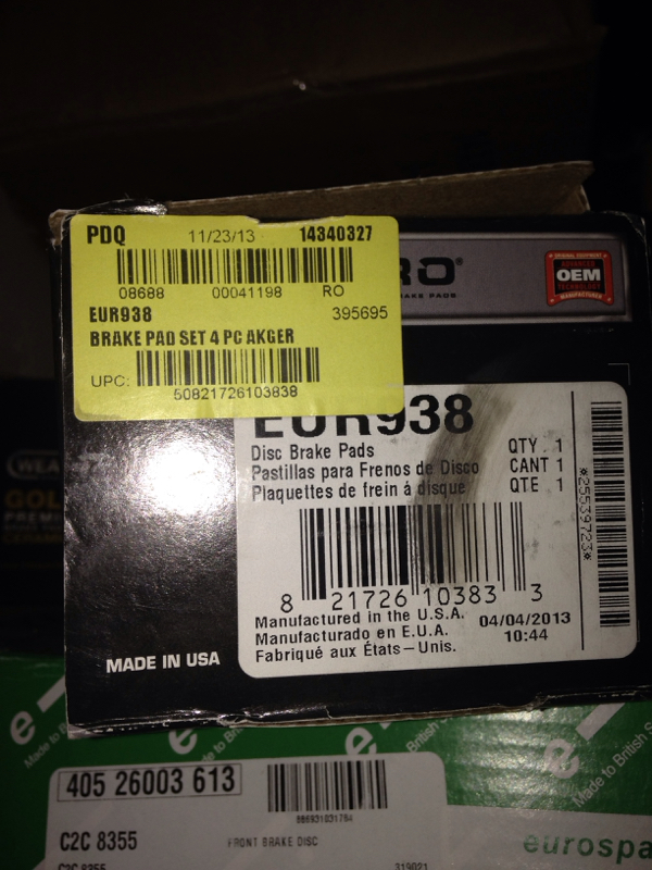

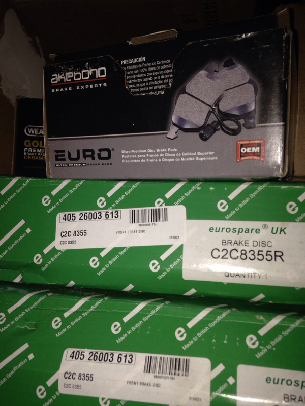

Thanks all.
1. I went ahead and ordered centric high carbon- had good experience on other car before.
2 Pads- went with Redstuff- I had yellow stuff before on other car with mixed result.
Transmission shifting has improved a lot. But still had transmission fault twice. But much less than before. I suspect that i need to do one more fluid change. The car probably never had any transmission fluid change.
Thanks all.
