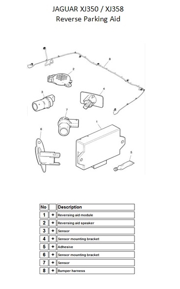

The system is quite straightforward but your XJ differs slightly from the thread Steve linked for you which was aimed at the XK8. The modules are a different design and location. Here's the Parts Manual diagram showing all the components:
If it doesn't turn out to be sensors, trace the harness from the module (item 1) which will be concealed behind the luggage compartment trim back to the power feed an on to each sensor.
