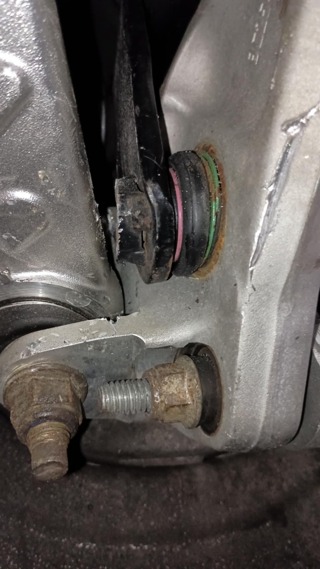

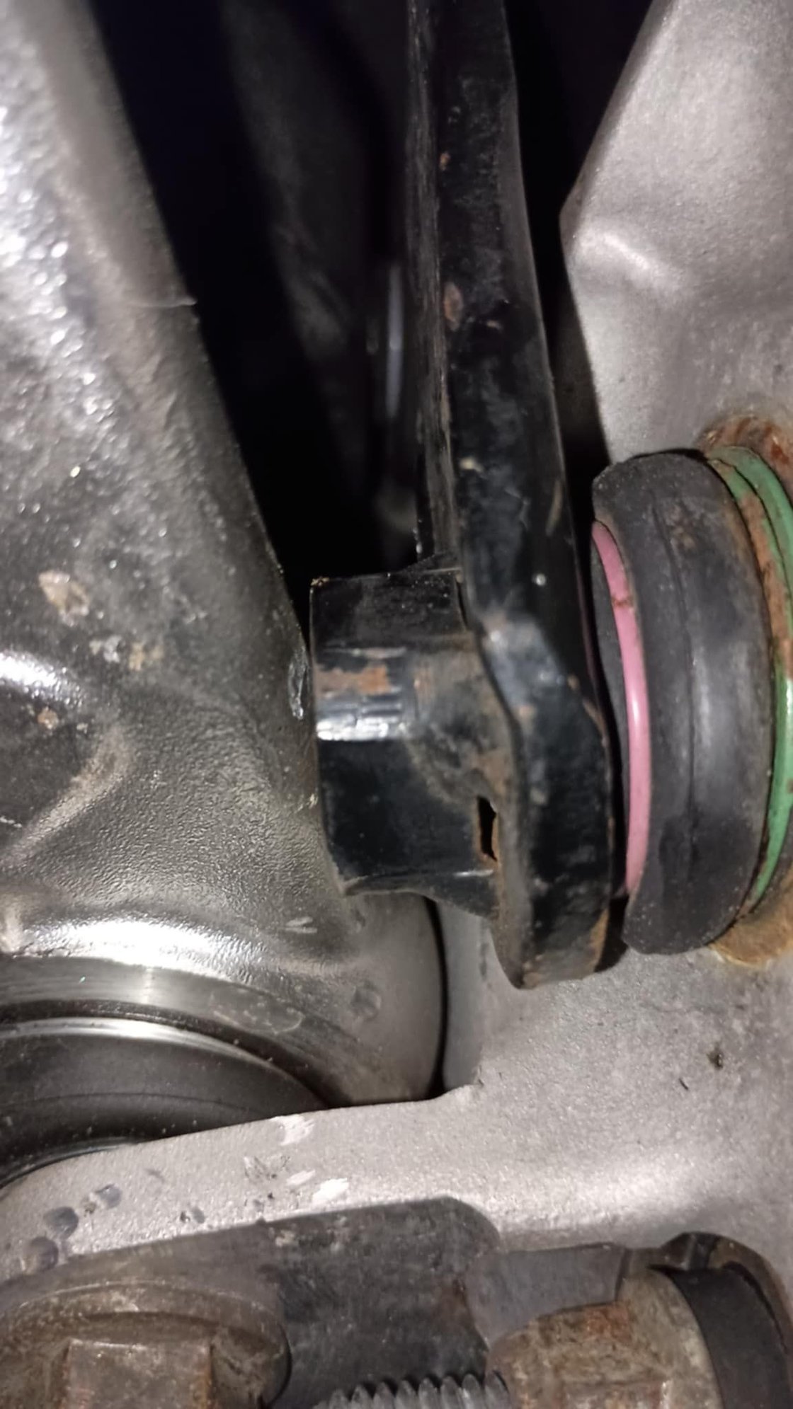

Old Jul 3, 2025 | 11:25 PM
OnebadassXJR's Avatar
Joined: Jun 2014
Posts: 364
Likes: 69
From: nj
Did the same and YEARS later found it was the bottom strut bolt making serious contact with the banana
arms, cut off small portion quiet now.
