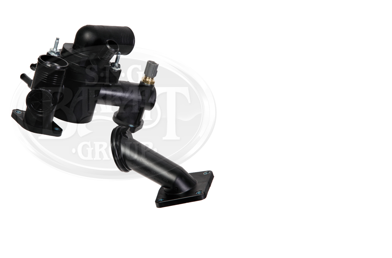

I got the low coolant light and found that coolant was leaking onto the water pump pulley and crank damper. It was coming from the thermostat housing above. I ordered a new housing which was unusually low priced at $58. It comes with the thermostat which appears to be specific to this housing as it is built into the housing cover. The thermostat alone is obviously not replaceable without the housing cover it is in.

I also should mention that the new housing comes with a new coolant sensor as well, an unusual deal for OEM Jag parts. This part is an aftermarket part but is made by the OEM supplier. When I got it, it was identical to the original in every way.
