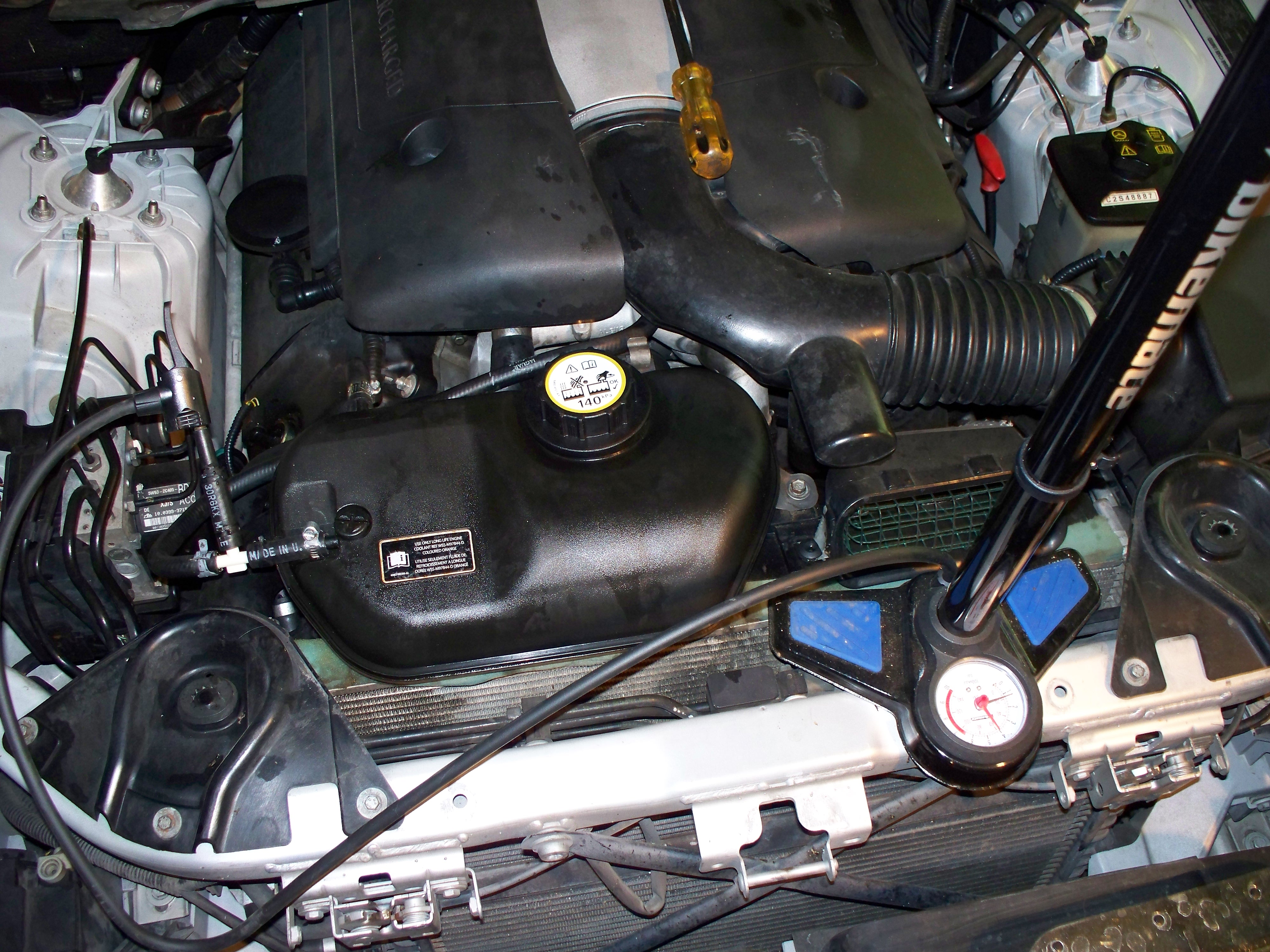

update: 6/15/2017 138,471 (Pressure test at expansion tank; held 120 kPa for four hours)
With the engine at ambient temperature of 78 F, I installed a T between the hose bib on the coolant tank and the overflow hose; the bib on the tank looked OK with no cracks or looseness. I pressurized it with a bicycle pump to just slightly below 140 kPa (20 PSI) on the pump’s gauge; the coolant gurgled in the tank as pressure was added; the pressure would not go above 140 kPa with additional pump strokes so I assumed the new 140 kPa cap was releasing the pressure at its rating.
20 minutes later the pump gage had dropped to 120 kPa and additional strokes on the pump did not raise it above 120 kPa. I saw no coolant around the tank seam, the cap, the bleed screw, or any of the hoses that you can see from the top. 4 hours later the pressure was still 120 kPa and did not increase when I pumped half a dozen more strokes. I could not feel any air escaping from the little hole in the top of the cap when pumping, but it has to be escaping somewhere – perhaps underneath the cap?
When I removed the T and reconnected the overflow hose to the tank, the coolant level had dropped below the min step so I topped it up to between max and min steps; I didn’t measure the amount it took but it was probably about a cup. I had the bleed screw out while I added coolant.
So now I wonder if there might be a head gasket leak adding pressure to the cooling system and causing coolant to blow out through the cap or if it has to be a combination of heart and pressure to make it lose coolant. Any more suggestions?
