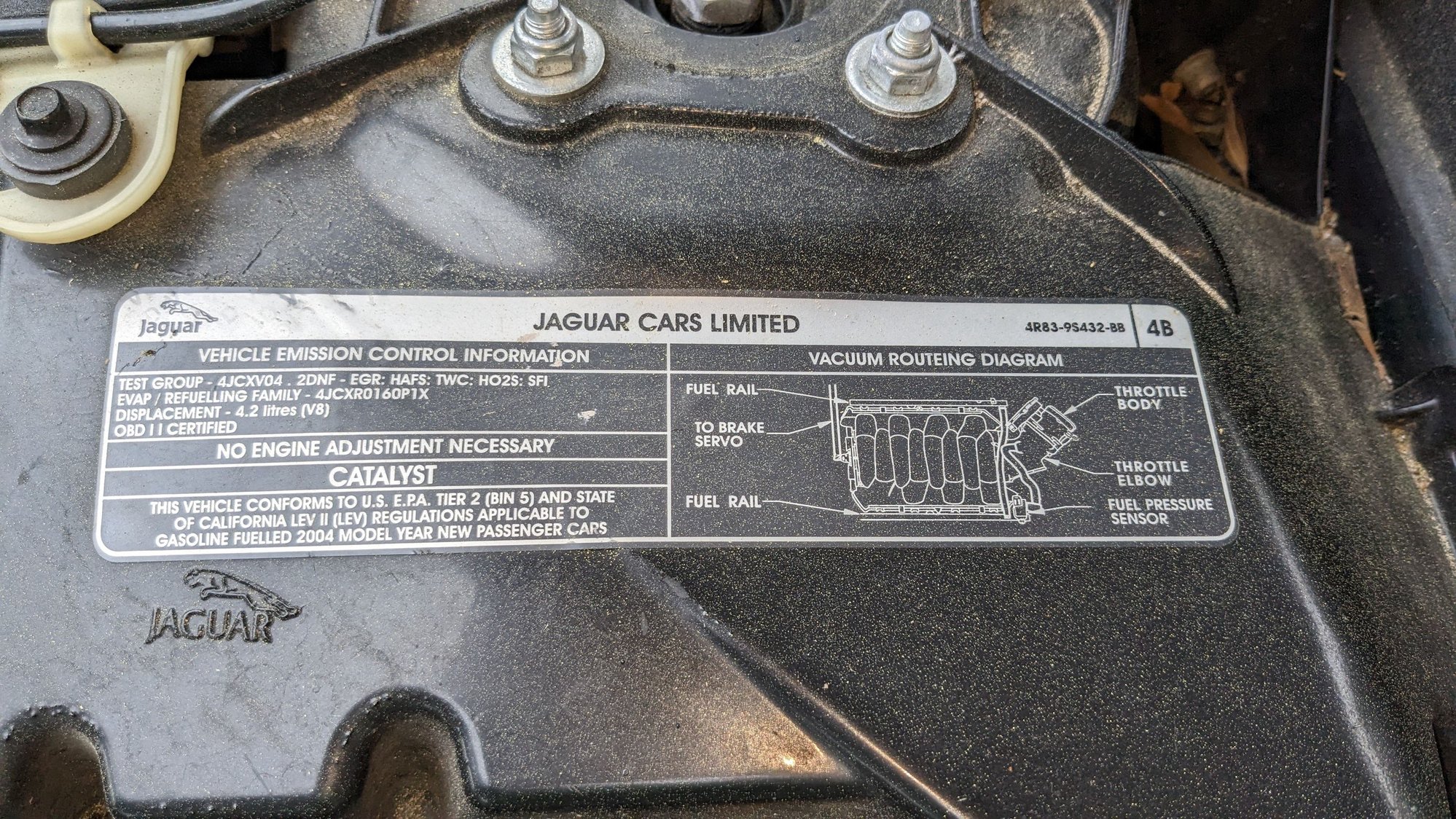

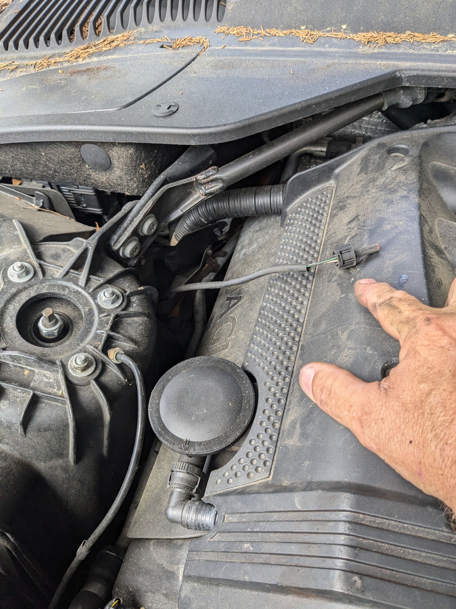

Hello everyone. My name is Greg. I have a "titled" 2005 Vanden Plas that has a VECI label on the driver shock tower that says compatible with 2004. And, I've looked at the Jag site(s) and it seems to be a 2004 not a 2005. Not sure if this has happened to anyone else but I think the title has somehow got a typo on it where someone punched in the wrong year....? Not sure.
Also, I bought the car for 1500 sitting. Person was driving the vehicle and it was acting up so they decided to sell it.

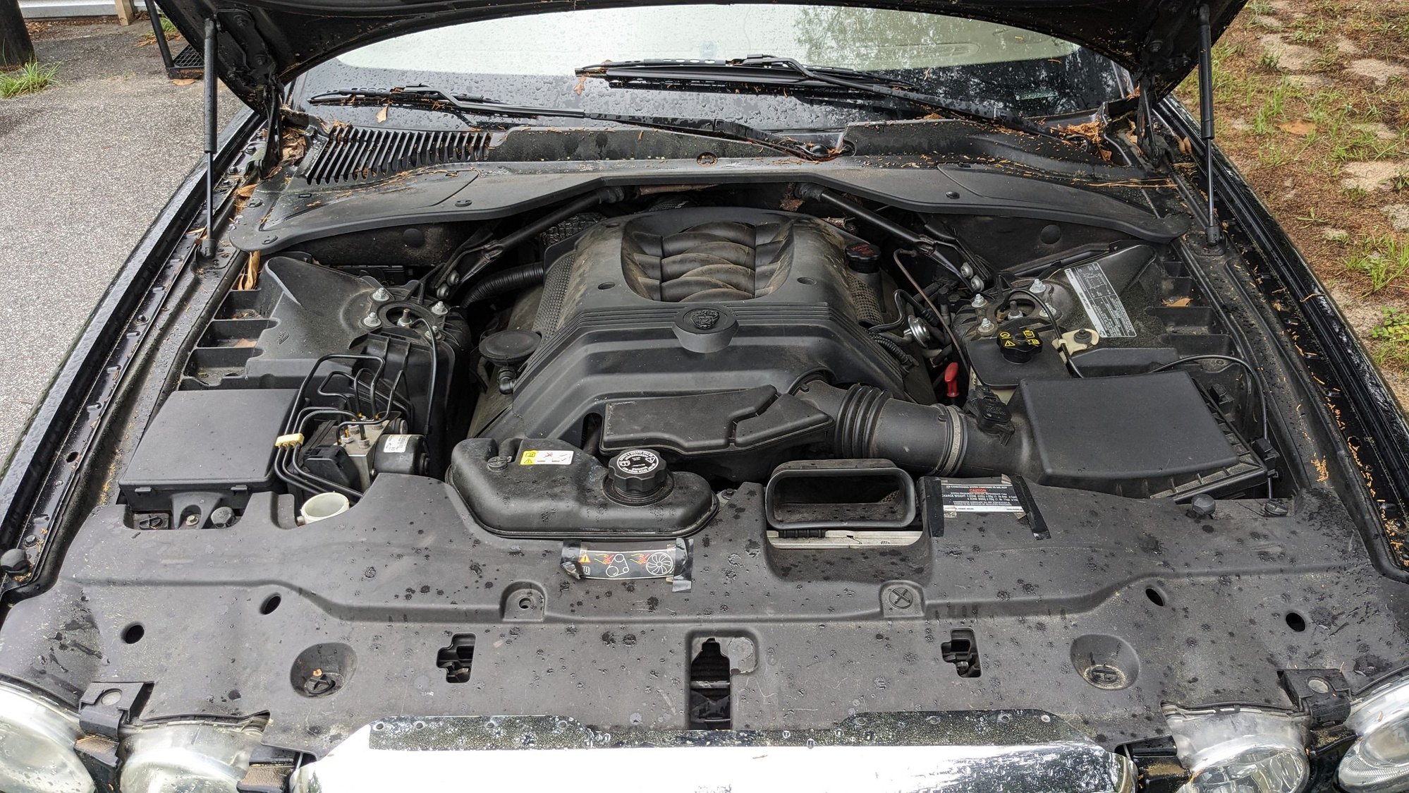

Upon first inspection...the car runs like crap. Won't accelerate, limp mode maybe but scan shows 46 degree advanced timing, is that how they achieve the limp? Not sure. Here are the messages that are displaying over the dash and the codes I've found. The battery is very suspect and I also jump it off (starts and runs) with my little box jumper.

Codes on Foxwell Scanner - P1000? P0332 Knock Sensor, P0117 Engine Coolant, P1642 Fuel Pump Monitor, P1637 CapLink ECM,

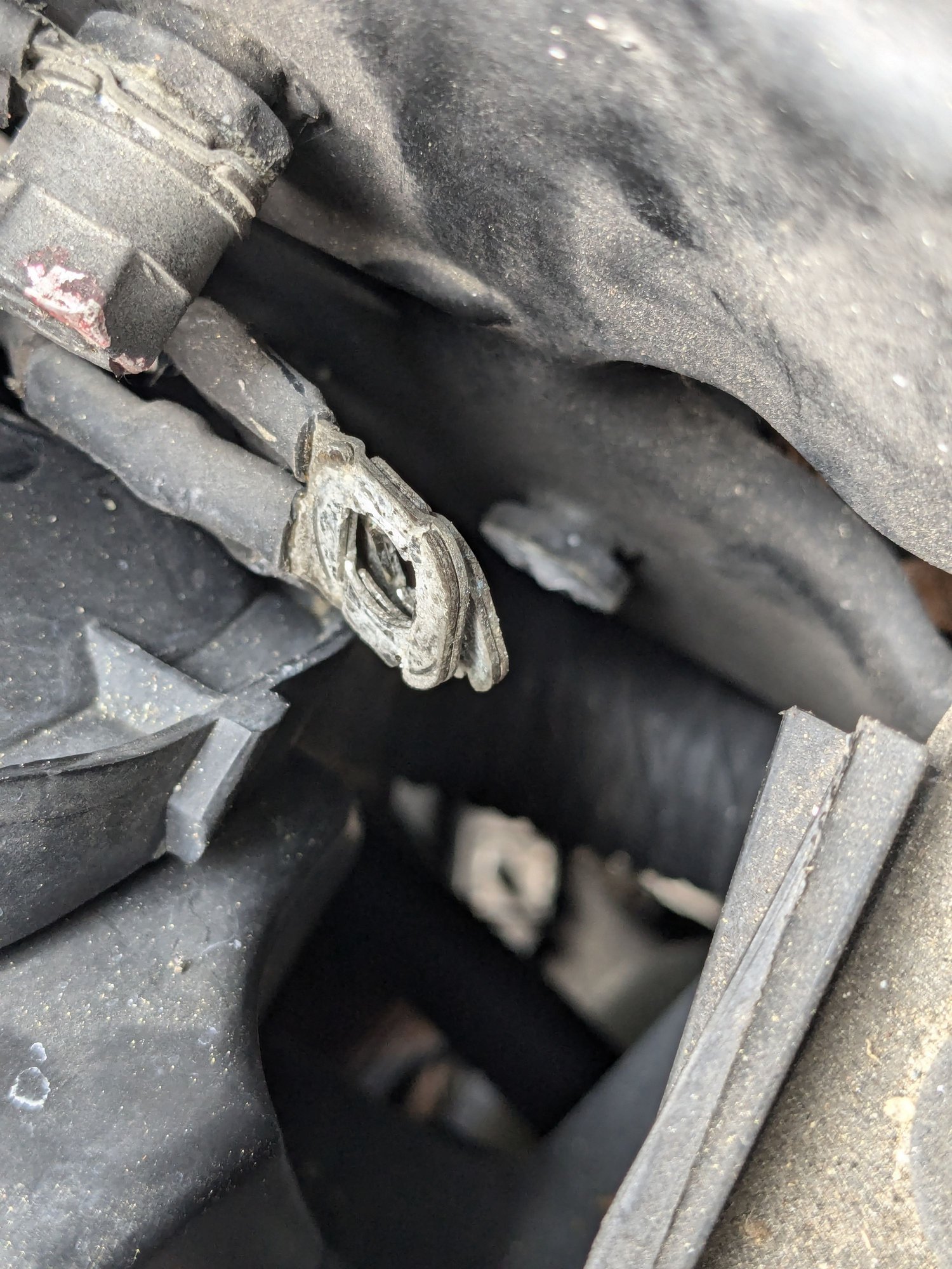

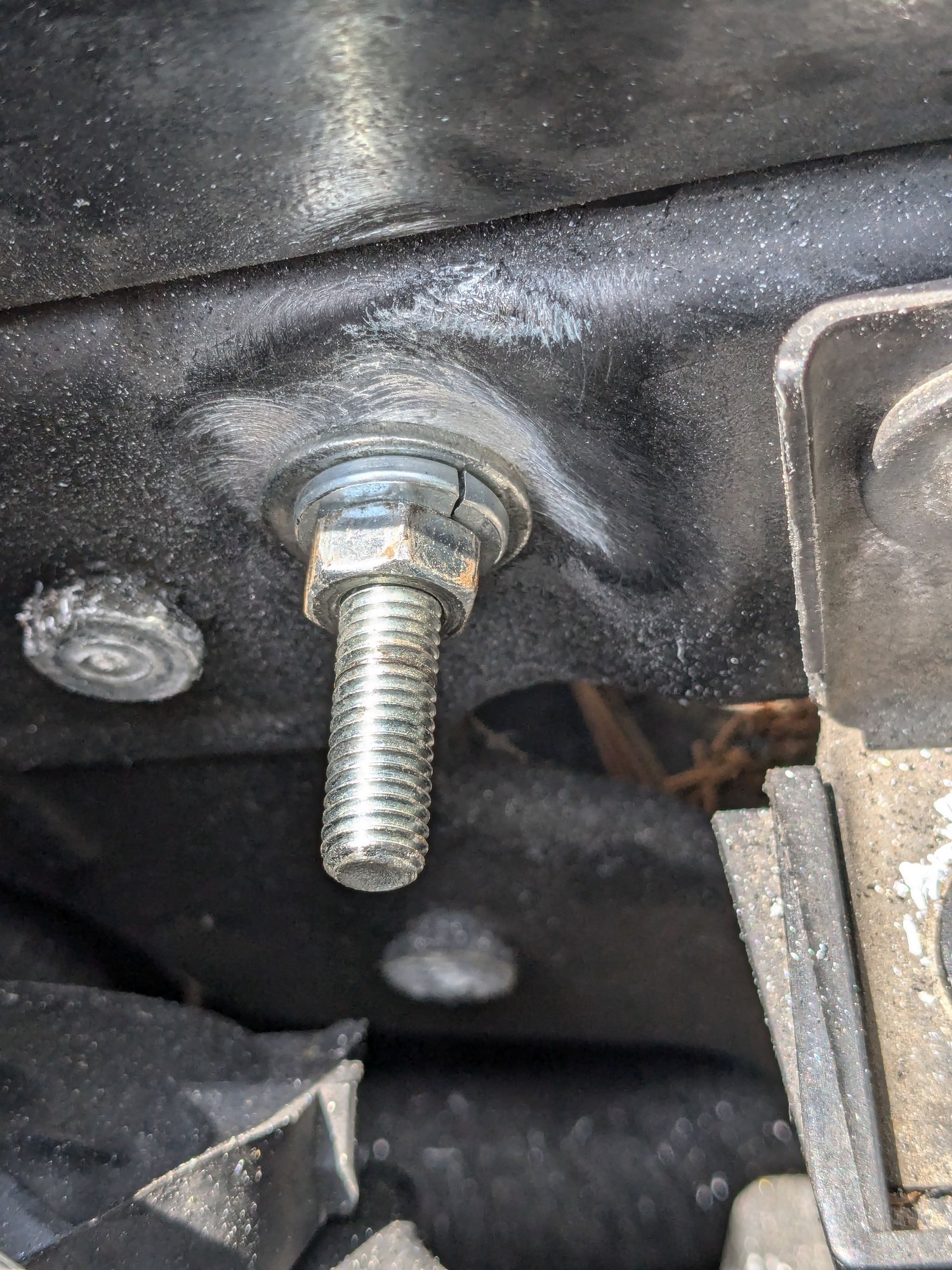

So armed with this information and searching sites I was able to find some information about the 4 PIN connection at the Throttle Body. I used 1 can of carb cleaner on a filthy TBI unit and cleaned/dried and reconnected the connectors. I also after receiving input from the internet checked the ground wires behind the front headlights.....DAMN!!! there are two ground spots on the passenger side and the bottom one (wires) were just handing there with a broken bolt attached. Grabbed the upper wires and gave them a very light tug and they snapped off too. Was able to drill a new hole, attach a new ground bolt point and re-secure the wires.
Started her up, took her for the first test drive and about broke my neck as it was slammed into the headrest. WTH Dang
Then as I reached 2nd the car went into a "rev-limiter" feel and I let off the gas immediately and could feel a 1-2 shift. Got on the gas again and went through second with no problem...got to where the 2-3 should be and same thing, ref-limiter feel and bucking, let off, into 3 she goes and so on. WTH was that about.
I'm thinking that I will/may have to take it very easy as I drive her around and she relearns how to shift?
Open for any suggestions here as this is a very strange beast for me. And yes she is available if anyone wants her.

FWIW..
- As to MY? A VIN lookup will get you the year and month it left the factory.
- An X350 has thirty-six ground points. Locations are on one of the illustrations in the electical manual. Downloadable as a .pdf.
Some are, admittedly, "more important than others", but still...
