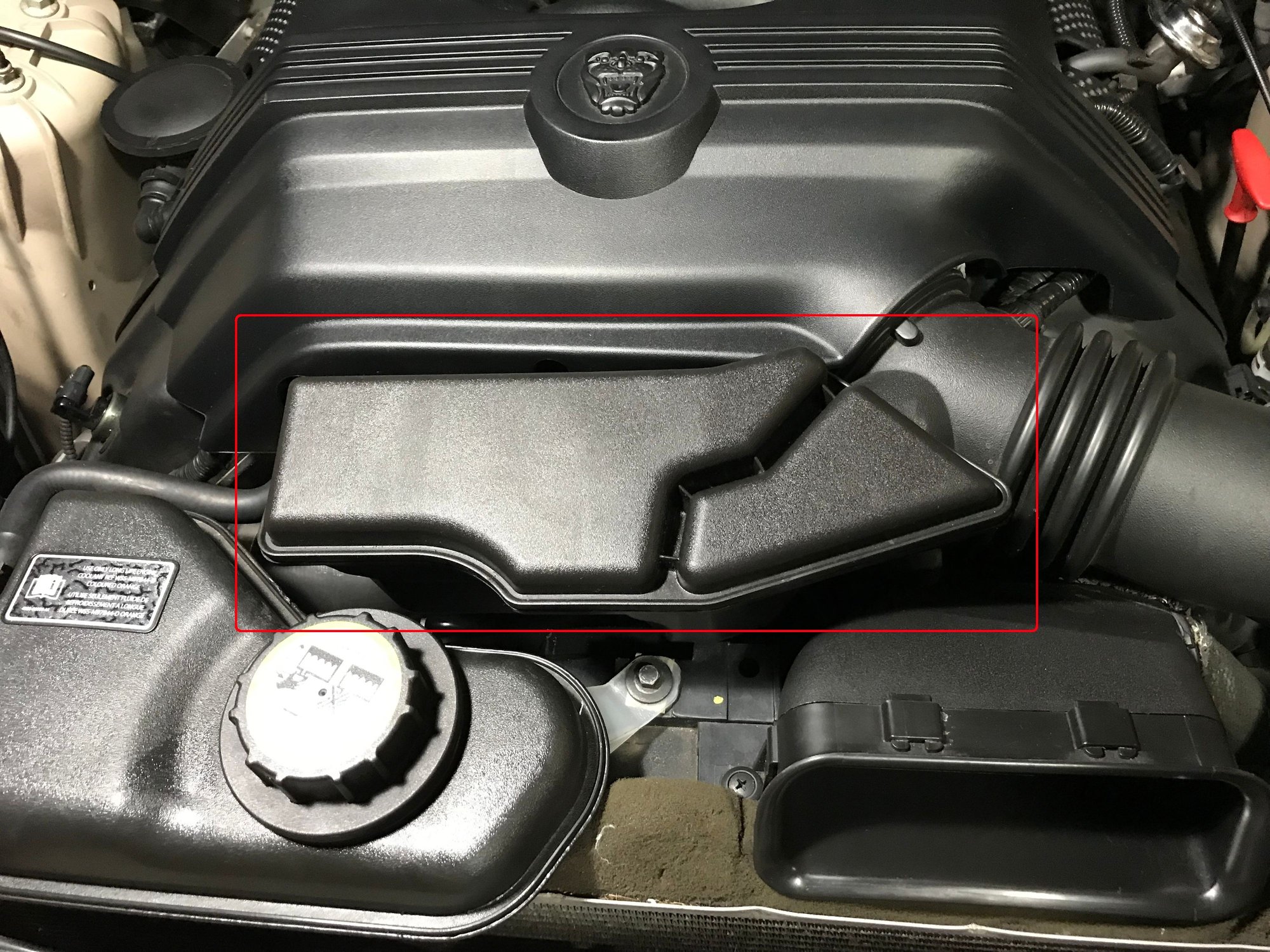

Question, there are two appendixes in the air intake pipes, one post-filter and one pre-filter. I want to get rid of both and picture them below. I want use the space to install a Champion coolant filter and run it for a year or so. I would provide my own hosing preserving the factory hosing to later reinstall it. Promise to let you in on it with pictures. I don't like those flakes in the cooling system, though they seem to have disappeared, hopefully not into the heater core.
what's this mystery box?
and this one?
