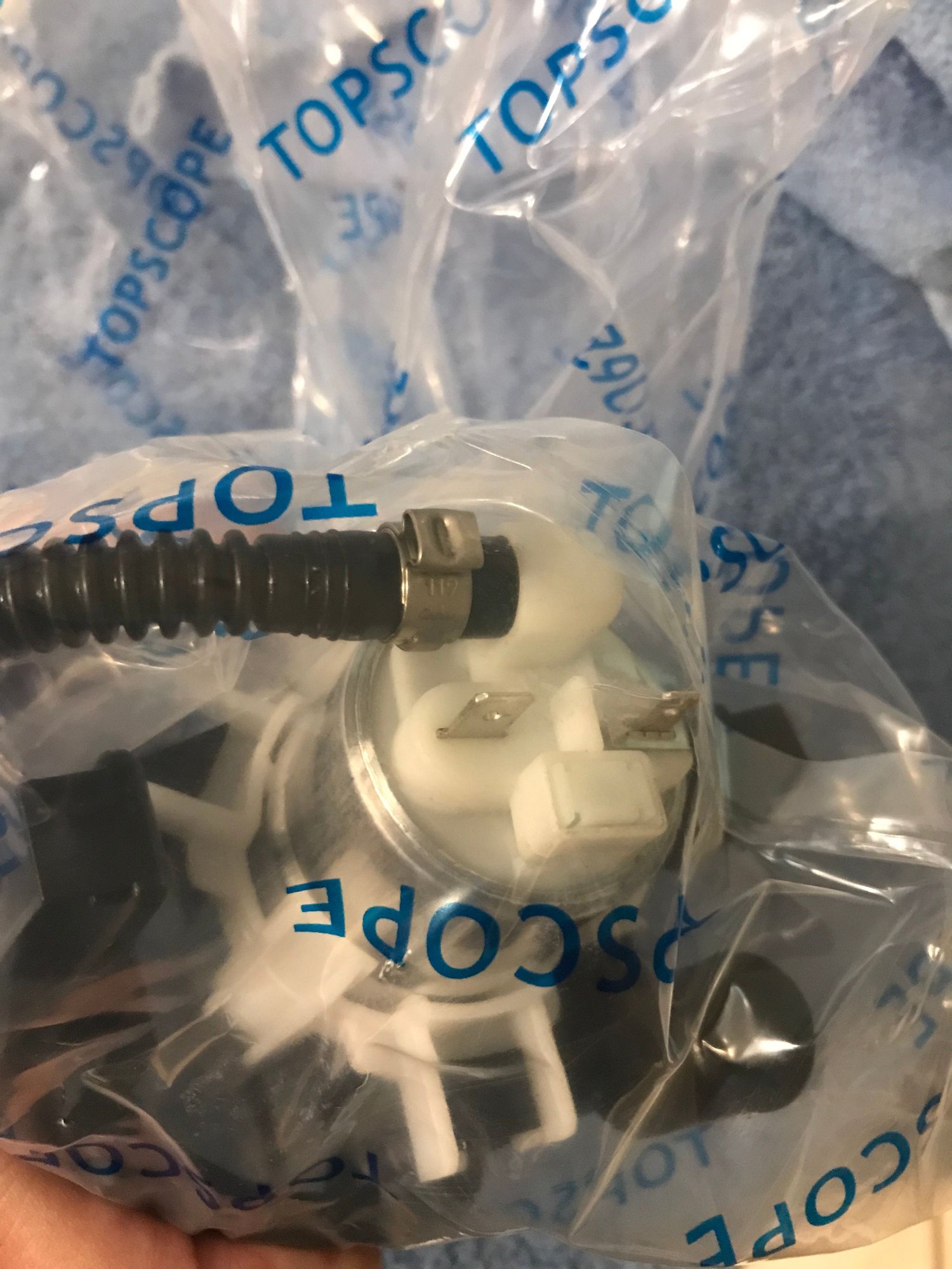

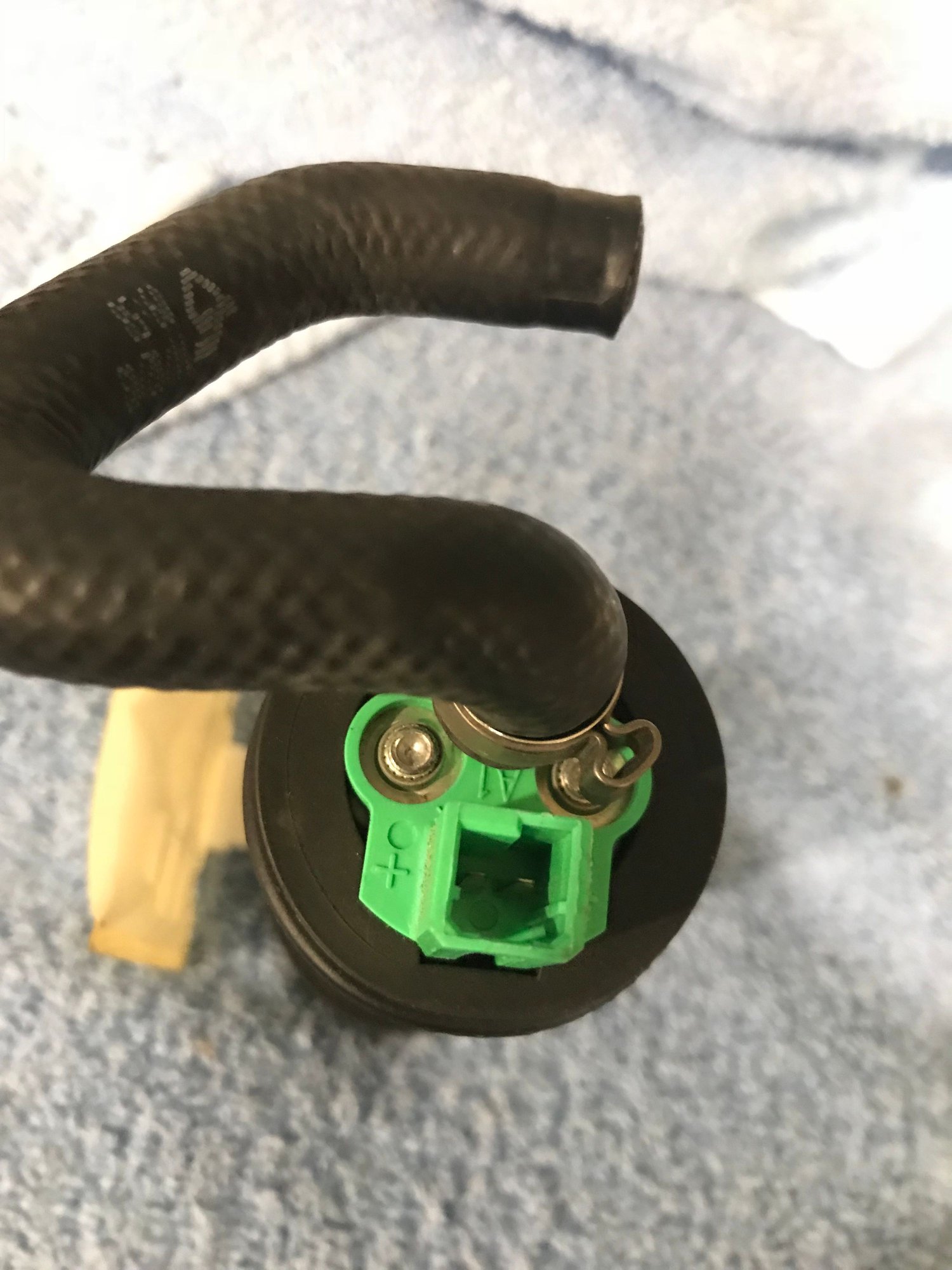

Quick update: I have now received two fuel pumps - one is claimed to be a factory original removed from a 2004 XJ8, the other a mid priced pump that is assembled in a fixture designed to go into a 2003 E39 BMW 540i (4.4L V8). I sourced the used pump on eBay and teh new pump on Amazon (for quick delivery and ease of returns). At this time, I can state that the pumps do NOT have the same electrical connectors on them. Please see below:
Electrical connection of claimed X350 sourced pump.
Electrical Connection of new BMW E39 540i pump.

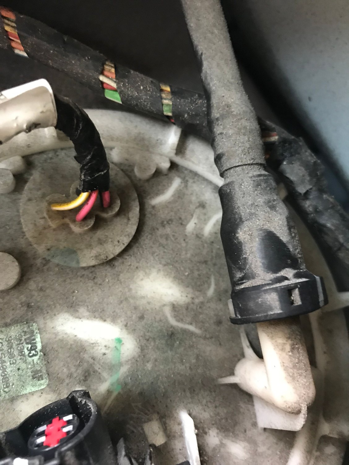

I now need to know the correct way to remove the fuel feed line on the pump assembly as seen in the image below:
Fuel feed line on fuel pump.
I am wary because I don't want to break anything as I want to get the Jag running this weekend. Any help would be greatly appreciated. Thank you.

The top one is not the right pump.
The second one ex Amazon I think is correct.
When you have removed the pump you can compare them.
