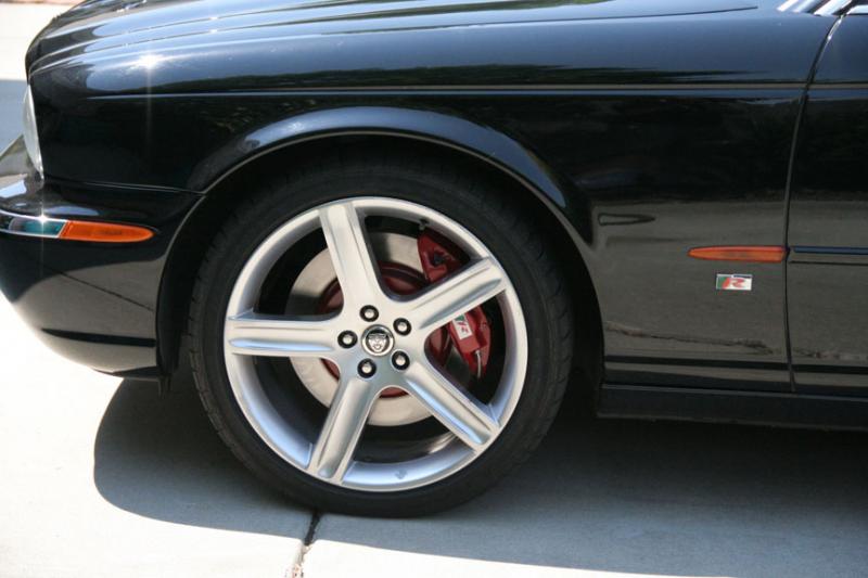

Robert - the job was very easy. No special tools required. You will need a small (approximately 1/8") punch to drive out the retaining pins and some muscles, or in my case, a cheater, to break the two caliper bolts loose. Retract the calipers fully before unbolting.
The front and rear wore pretty evenly, so I would count on doing them all. I did not do the parking brake pads, but did have to remove them to get the rear rotors off. I don't know your level of experience, so don't take offence when I say to be sure to turn the rotors. Any brake shop can do it.
There is a post on this site that warns "do not remove the star bolts on the parking brake calipers" I repeat it here in case you didn't see it. The parking break calipers unbolt from behind. The parking brake calipers are mechanical, not hydraulic, so if your rotors have a lip from wear and you have to retract the parking brake to remove, you are better off unbolting them, then removing the pad retainer pins, then let the pads slide through the bottom as you pull the calipers off. Once off you will see that the pistons have a big notch so you can thread them back into the calipers (this will only be necessary if you replace the rotors or parking brake pads). If you retracted the pistons, when reassembling, simply ratchet the lever on the back of the caliper to take up the extra slack. If you don't do this last step, the parking brake system will eventually take up the slack.
If you have added brake fluid, you'll want to put a tray under the master cylinder to catch the overflow when you retract the calipers.
I painted my rotors and calipers while I was at it (pic attached). That was the hardest part of the entire job. It's been a month and I am still very happy with the Akebonos.
Have fun!
