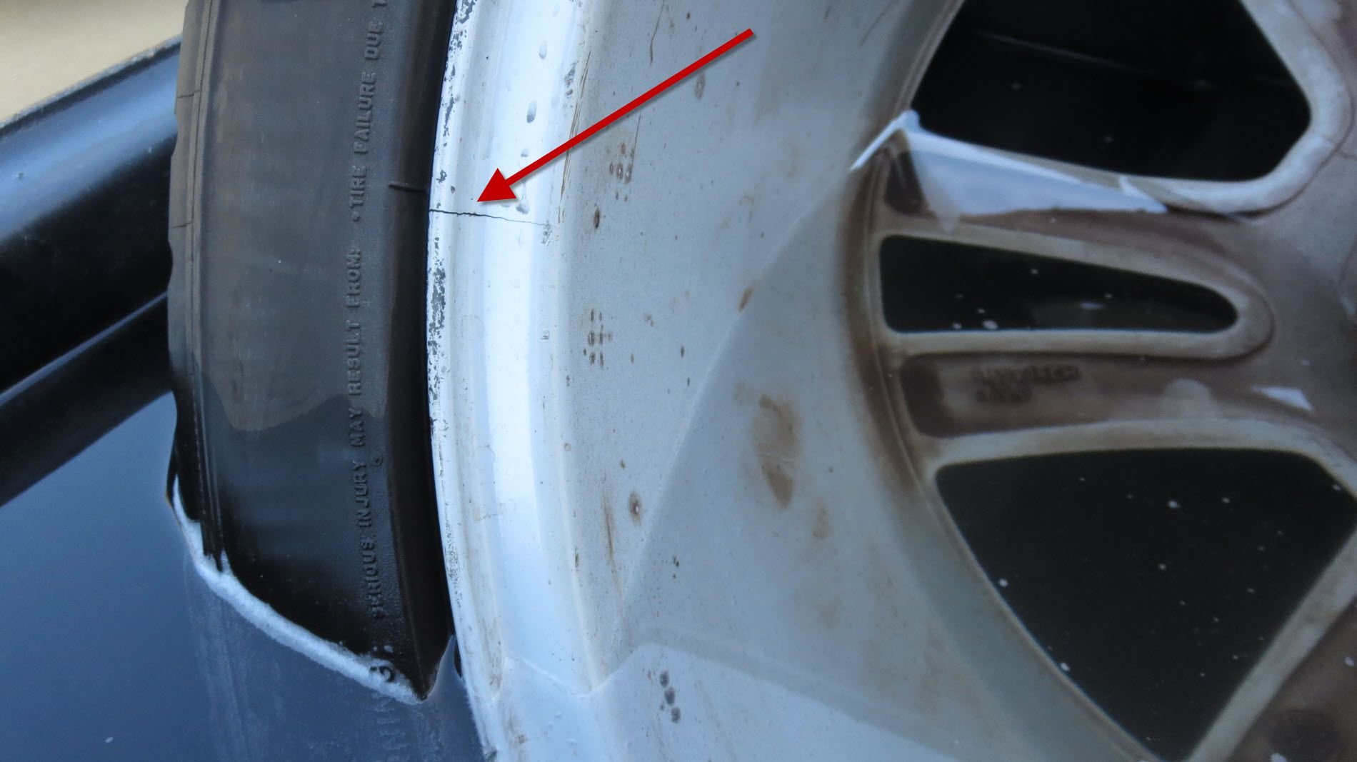

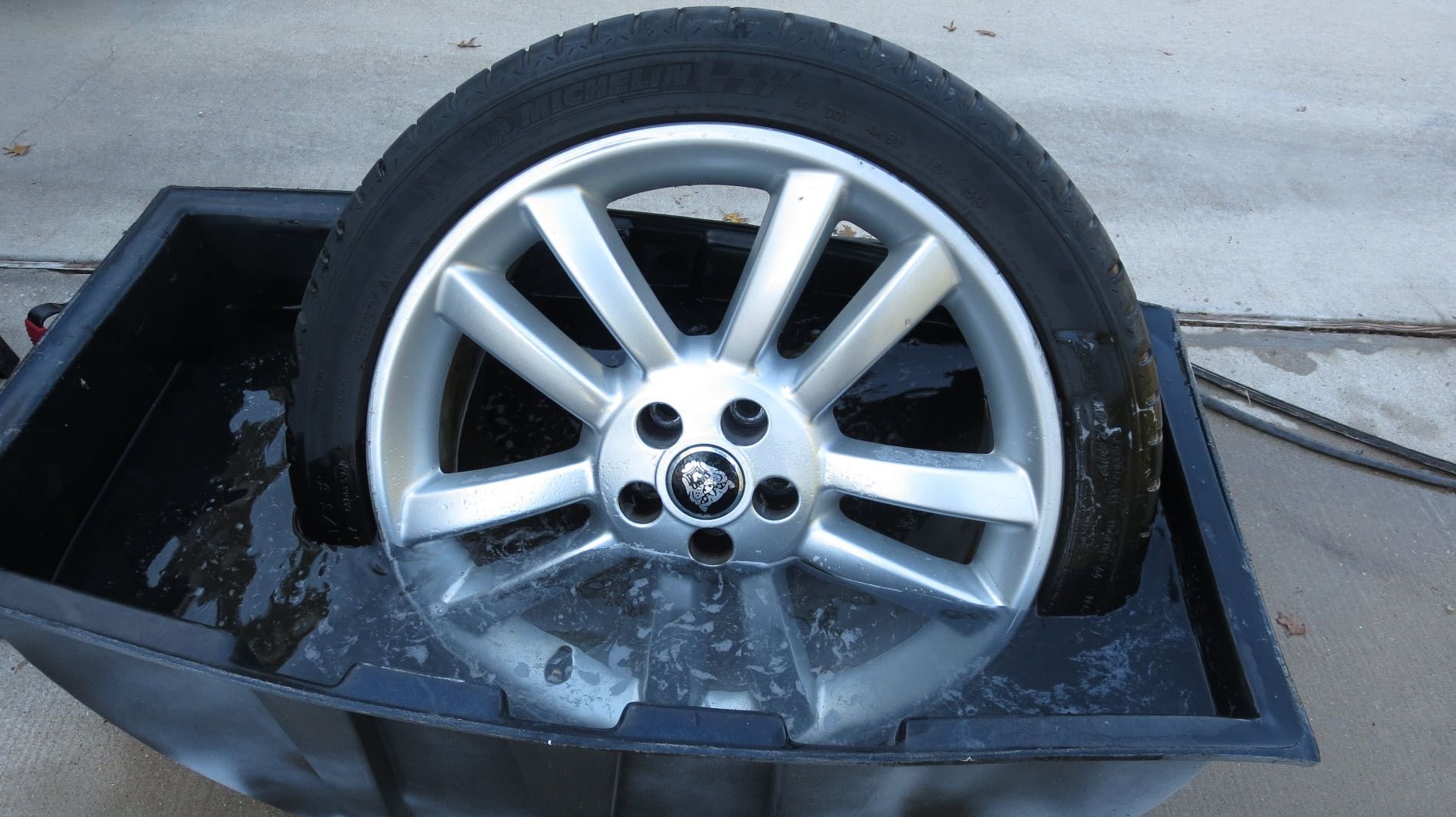

My XJR took a break for the Thanksgiving holiday since I did not have to take it to work. When I pulled it out of the garage to give her a bath and prep her for next week, the rear right tire was *totally* flat. I took the wheel off, aired it up and dunked it in a pool of water to see what the hell was up. I was expecting a screw, nail etc. However, the diagnosis was more dire than that: It leaks from what looks to be a crack on the wheel.
I do not drive this car hard at all, commuter really on toll ways. The question is: Is this atypical or have other folks seen this issue?

Typical location for a dent or a crack - inner side where there is no support from spokes. I don't know if that crack can be welded-up, (it probably can), but if it were me, I'd be looking for another wheel on eBay.

I have had two of these cracks repaired on my 2008 XJR. Find a very reputable welding shop that is experienced in heliarcing and the repair will be stronger than the rest of the wheel.
