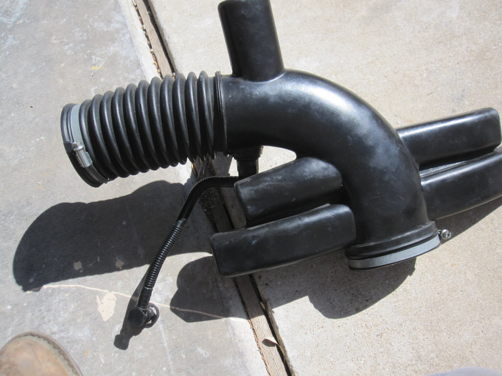

In its relentless pursuit to annoy the crap out of me, my Jag threw P0171 and P0174 codes (both banks lean). Just when I thought all was in order, this thing refuses to step off the lift!
After going through a successful A/C recharge last night, the codes were thrown. Hooked up my SDD/IDS laptop pulled the codes, cleared them and came right back.
There has got to be a vacuum, and a substantial one at that. I must have broken something. Kept looking w/o success until I put my hand under the air box and felt something loose. Yeappers, here's my leak.
Going clean it with denatured alcohol, silicon glue the s**t out of it and hope for the best. Worst case, I will have to replace it.
Truly hoping to put her on the road tomorrow after 4 weeks on the lift.... this is what I have done:

She is *truly* leak free now!!! She never really has been free of leaks since I got her last October.
Off to glue this thing on, put on the remaining trim bits on, wash her and get her ready for tomorrow.

Doubtful that any type of glue will hold in that scenario, joining thin edges of plastic together. Your best bet might be Gorilla tape. Comes in black, very tough and might even hold up longer than you'd think. Clean the surfaces with alcohol as you had planned, and that stuff gets a firm grip. Meanwhile you can pick up a salvaged replacement from ebay or a yard.

check that any silicone you use is 'sensor safe'. I believe all the newer ones are these days, but back in the 80's/90's it was known to kill your 02 sensors if vapor from it was pulled into the intake.
Some call it an urban myth, but there were TSB's on it.
Not worth the risk imho.
*auto store silicone's I mean- I wouldn't use some home use stuff at all.
strange that that resonance chamber cracked, and interesting that there appear to be 5 of them on the R's! The engineers must have spent a lot of time tuning that intake sound.
I am ordering a new one but I did put regular Goop glue on it and it is doing well after 100 miles. The crack is after the sensor towards the intake. I did let it dry yesterday for hours before putting it back on the engine. Hopefully it can survive a few days until the new part arrives from Gaudin.

Ah, well I have no idea if Goop is sensor safe Hopefully for you it is!
(it's the o2 sensors in the exhaust, the silicone goes thru the engine and contaminates them (coats them I recall) so that they stop working very well.

Check around town, You will be looking for a "Process Piping" mechanical contractor. He may be able to "weld" the plastic back together. There are plastic welding rods used with a heat gun very similar to soldering copper pipe fittings.

I have used a product called Shoe goo with great sucess. It is intended to repair shoes but I have used it on cars and motorcycles. It bonds to plastics very well. Fills holes and gaps. remains some what flexible. Easy to apply and fully cures in 24 hrs. Much better than silicone sealant. You can find it on Amazon. Try it and let us know how it worked out for you.

I got a replacement air intake box from Gaudin Jaguar but never installed it (yet, anyway). The glued up air box, as mentioned earlier in the thread, is holding nicely after 800 miles.

After 7000 miles, the glue is still holding on. Got the spare wrapped in plastic tucked away.

The rick with using superglue to do plastic is to bycarb soda
After you apply the superglue and join the parts put a heap of bycarb soda over the top.
This makes the superglue go off instantly not sure why this works Im not a chemist by any means but my understanding is it produces a lot of local heat for an instant which causes the plactic to fuse. So the end result is the the fusion of the palstic not the glue holding the join
I have used this many times in fact I repaired my mirror and inner guard

You may be able to heatweld the broken airbox. If you have a soldiering gun you can line up the parts and carefully melt the parts back together. The plastic is thin so you can easily melt all the way through.

you can also join the parts with superglue and before it goes off sprinkle bycarb soda over the join. This causes intense heat for an instant and forms a plastic weld
