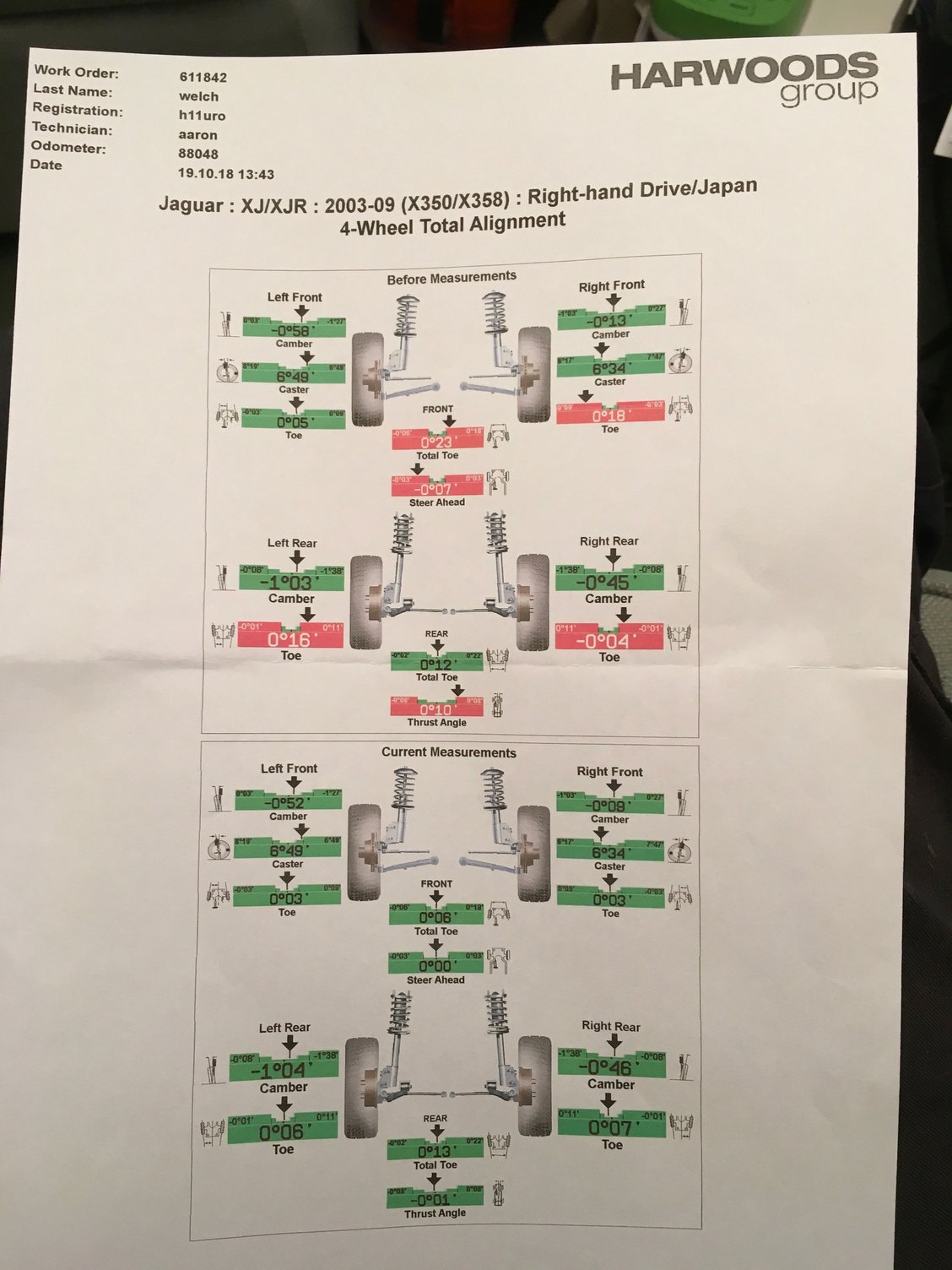

Just had some alignment done on my 2004 Super V8. The picture shows the results before and after. The rear camber figures are slightly different but I dont know if that is because they adjusted the Toe maybe.
I dont know if this may be of help to you.
- Rear can be adjusted for toe only
- Most coil over retrofits put the back axle high (to allow for rear passenger/trunk/fuel load - its a compromise)
- Generally speaking, this should tend to create some positive rear camber
- Worn rear arm bushes = negative camber
- Yours are probably worn out (this applies to most X350's)
- Ditto front bushings, though some adjustment is available
- Here are specs:
