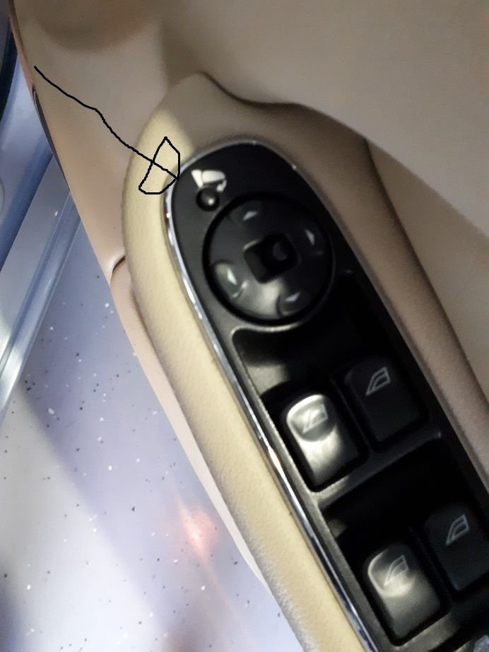

v966732's Avatar
Joined: Aug 2021
Posts: 3
the button is there on the mirror/window control switches so it defintely doesn't have it fitted.
The x-type mirrors look the same but I wasn't sure if the internal wiring was different?
the button Isn't there!!
