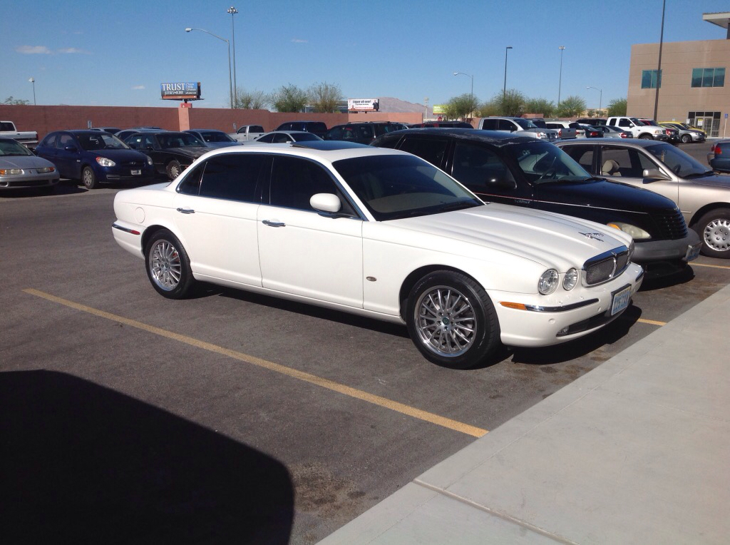

I have Whitleys in 18"s on my car. I thought about going with 19"s but am glad I kept with the higher sidewall for ride compliance.

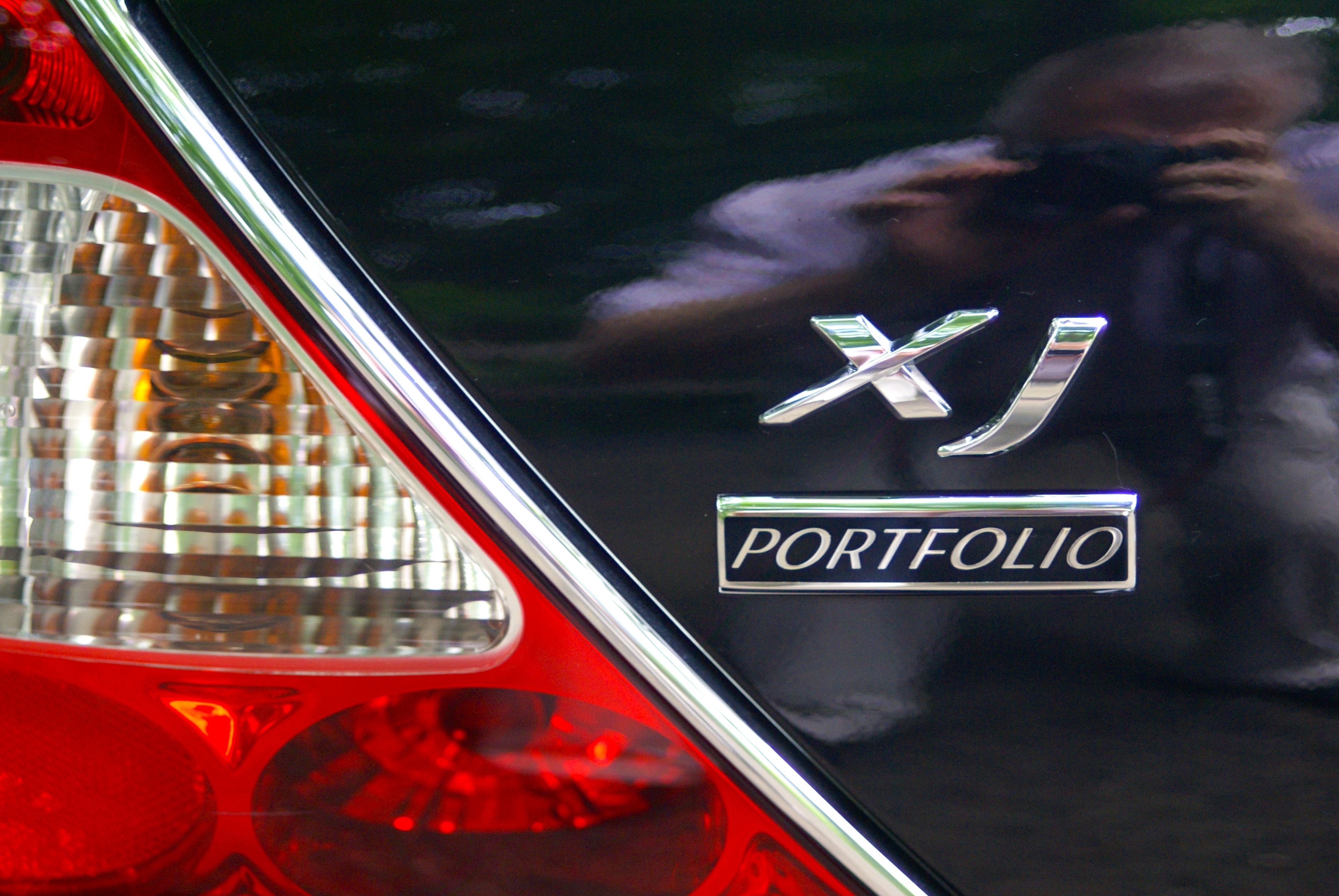

Well, thank you to everyone for the very helpful advice (especially Sean for that detailed attachment). I am now more confident about downsizing, and I'm sure the extra rubber will help the poor car to survive the local roads! My pocket book may cause a delay here, but I will post an update when I have finished the change! Torrid, I think that those Whitleys look very smart. It's great to see a picture of them on the car. Thermite, I'm fond of your home town which is now my home, but will never get quite used to the climate and the roads! I have actually bought an elderly awd for those days when it's -20 outside and the city forgets to plow the streets (the Portfolio is spectacularly uncontrollable down some of our steep hills in such conditions) but there's no point in having such a beauty as this if you're only going to keep it for 'Sunday Best' - life's too short and I want to drive it as much as I can!
Thanks again, everyone.
Kevin
