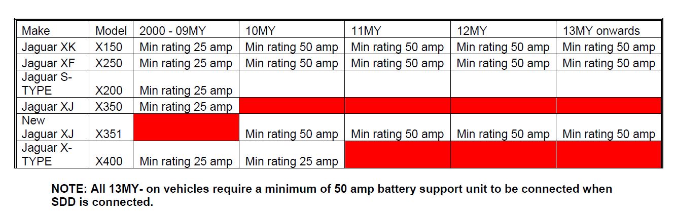

Old Jul 22, 2014 | 11:52 PM
u102768's Avatar
Joined: Jan 2010
Posts: 2,941
Likes: 1,511
From: New Zealand
I had a play with my SDD over the weekend and had left my CTEK battery charger connected for the whole of the previous day. When I started up SDD the battery symbol was green but quickly went to yellow once I started playing.
It would occasionally flick back to green because the charger was still attached but you are supposed to attach a proper battery charger with a minimum of 25 amps output on an X350.
Attached Thumbnails Adaptive Cruise Control Failure Your Thoughts?-chargers.jpg
