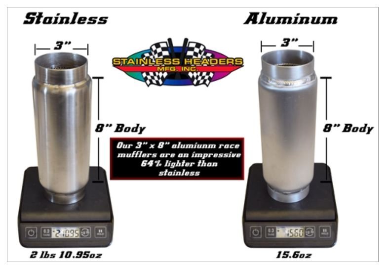

Even lighter and probably only suitable for the tail area of the system, aluminium exhausts - as seen with lightweight nuts and bolts, aluminium is less than 1/2 the weight of stainless steel.
https://www.racemufflers.com/Aluminu...ers-s/1882.htm
https://www.racemufflers.com/aluminu...2.5-8-6061.htm
It would be nice to get it anodised to match your brake calipers
Here is a Nissan GTR rear exhaust section in Aluminium mentioning the weight:
http://www.awdmotorsports.com/STM_AL...st-r35-gtr.htm
These bike mufflers would fit a 2.5" Aluminium exhaust tail section, they're adjustable too if your original system is too loud:
https://supertrapp.com/shop-products...n-core-12-disc
