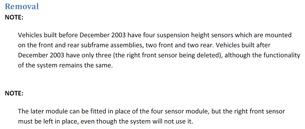

Info from the work manual:
Attached Thumbnails air suspension-suspension-1.png   air suspension-suspension-module-1.png   air suspension-air-valve-block.jpg
