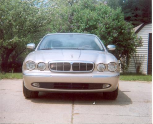

Here are a couple of pictures of my 2005 Jaguar XJ8L with the Arnott coil/spring conversion.

Looks slightly higher but not too much. How would you judge the ride before and after? And if it's not too gauche to ask, did you have someone else do the work and if so, how much did it cost?

Before the Arnott coil/spring conversion, the air suspension was nice, but the suspension seemed to bottom out (thud!)sometimes whenever I went over some bumps on the road. After the Arnott coil/spring conversion, the ride was simply pleasant, comfortable, smooth and never bottomed out. In fact, it was the best riding vehicle that I had ever drove. Trust me, you'll never be disappointed with the conversion. That I can guarantee.
It cost me a little over $1600 for the Arnott coil/springs, and a little over $1100 for Goodyear to do the conversion. It took one (the manager assisted at times) of their mechanics 8.5 hours to do the job that day, but they also had to do an alignment and test drive. The job that the Goodyear mechanics had done was professional every step of the way.

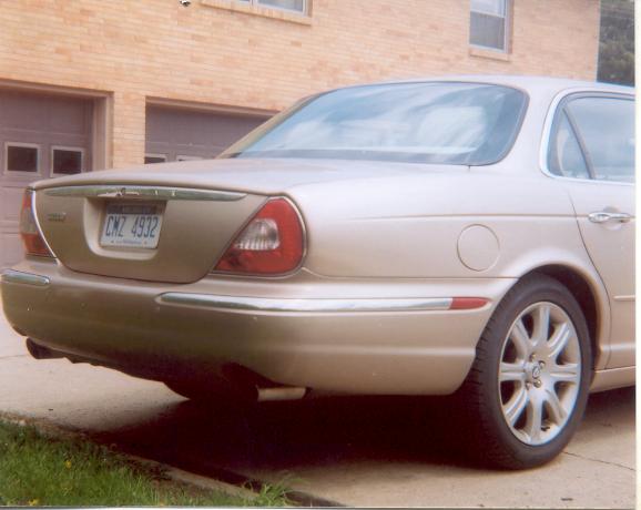

Here is a couple of other photos of the 2005 Jaguar XJ8L after the Arnott coil/spring conversion.

Looks great Rickkk.

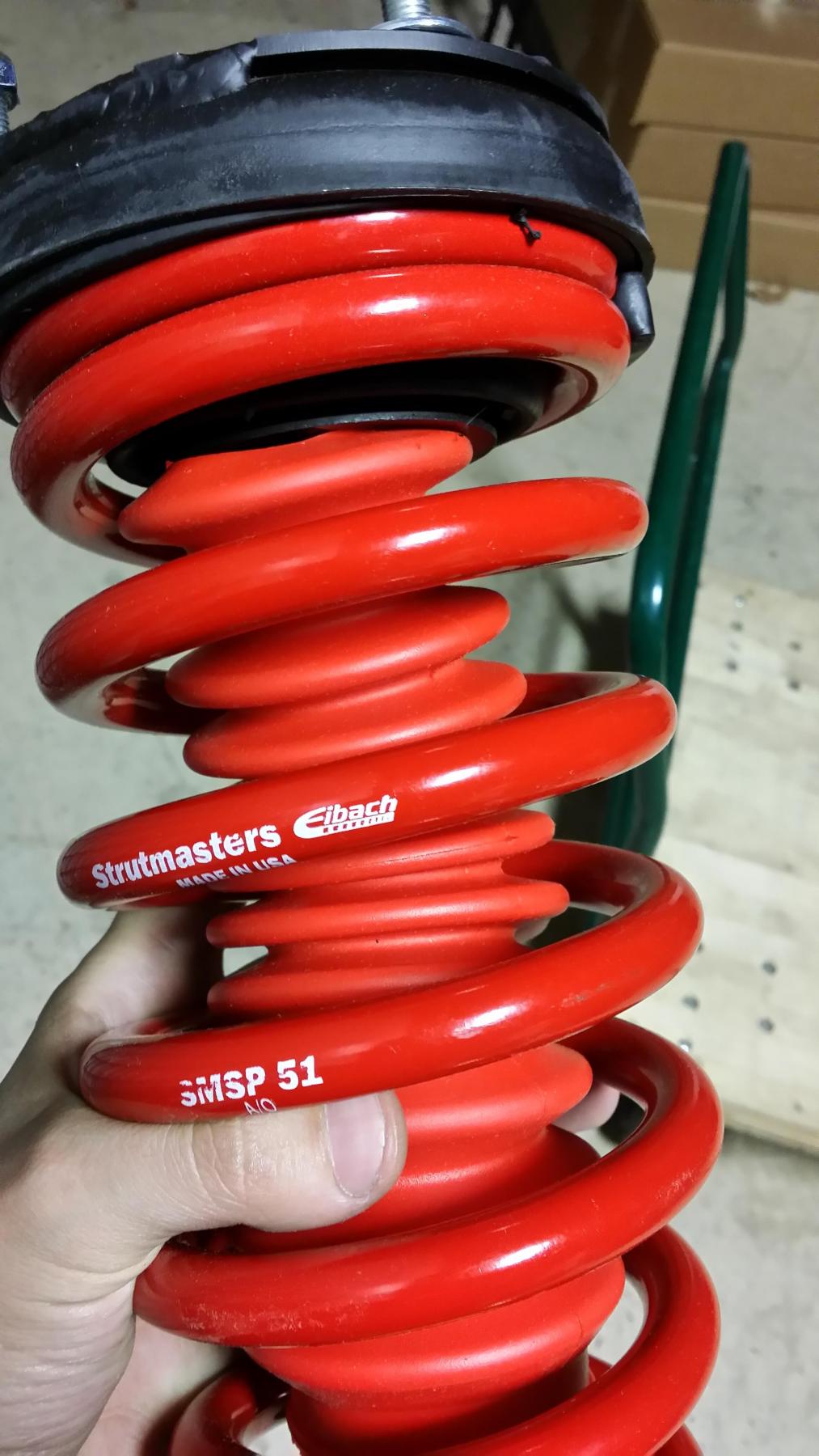

The struts are here already! Unfortunately I won't be able to put them on until this weekend. I want to play with my new toys now!
In case anyone was wondering, the Strutmasters use Bilstein shocks with Eibach springs:
Attached Thumbnails Air suspension replacement-rhqi7ob.jpg   Air suspension replacement-jomw9ot.jpg
