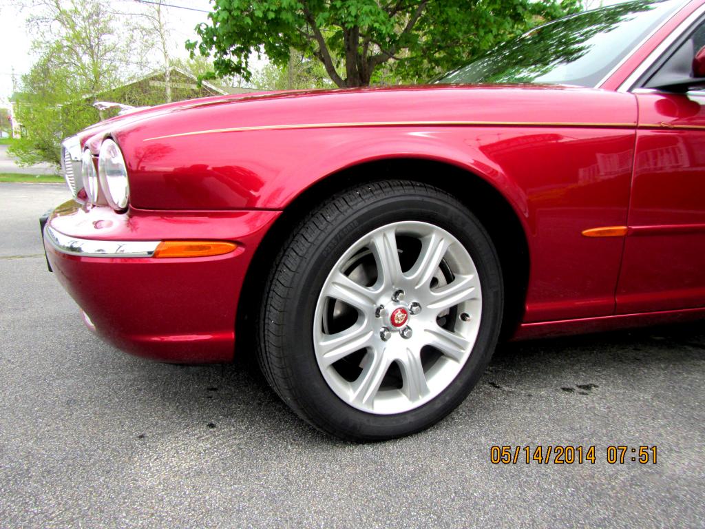

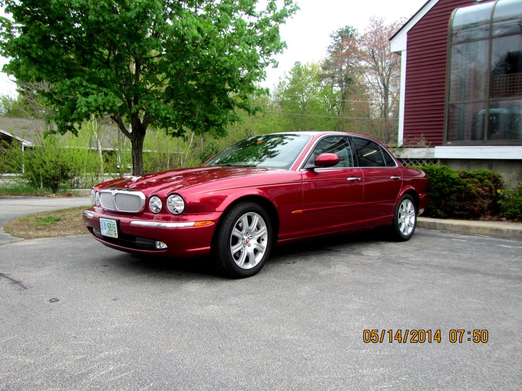

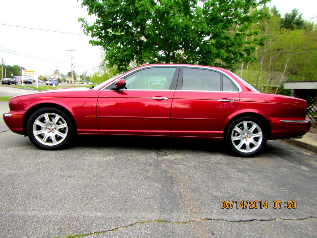

Here are the pics with the new suspension installed. Sorry I did not take pics before to compare.

Bushbuck,
Gorgeous car! Love that color! It's similar to but even prettier than the Flamenco Red on our '93. What is the official Jaguar name for the color of your car?
The front end does look a little high compared to ours, which still has the stock air suspension. Hopefully the bushes will settle in and assume the normal stance.
Thanks for the great photos!

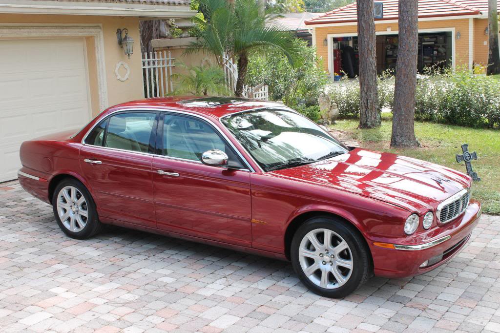

My Mrs BoxxMann has the same color and year car! Good work...I'm thinking the front will settle. I will get a measure soon of our front and rear heights for comparison.

The front and rear heights should be approximately the same. Be aware that the vehicle will now require an alignment (if it hasn't been done already.)
