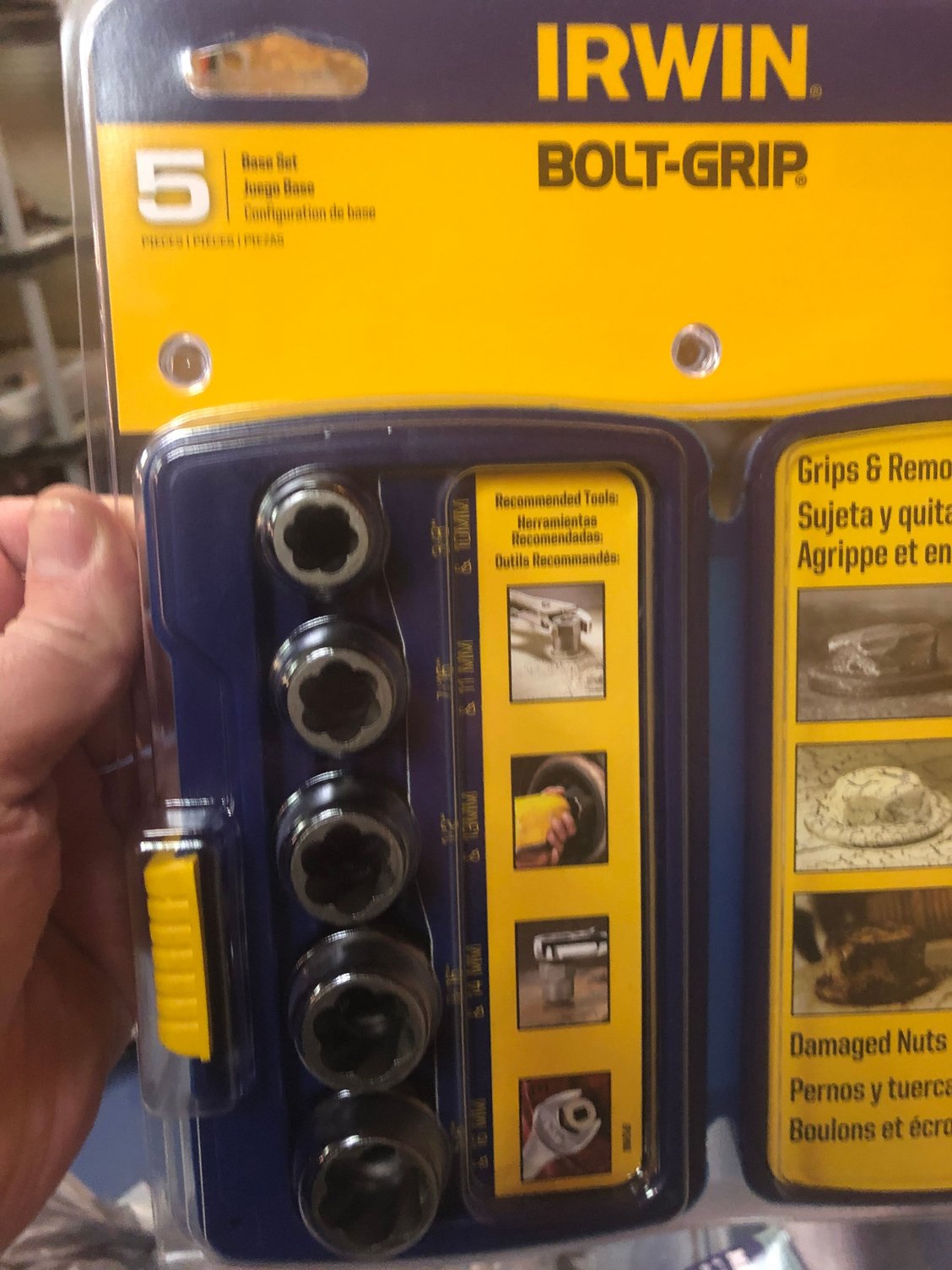

wtbm123
YouTube - Feb 26, 2012

Yep, what Wingrider shares.... I have a set of these sockets designed to assist with this problem that is this dudes left hand. But I bought them so long ago, I do not remember where I bought them. Was possibly Harbor Freight????

Thanks Ill look for Turbo Sockets.

Sears, Harbor, Lowes, Home Depot lot of people have them by lots of names

Lowes for about $20
The offending nut...wont budge. The bolt socket will not grip it and the smallest size is too small.

I would hammer a 1/2 short socket on there and go at it. Those tools dont work.

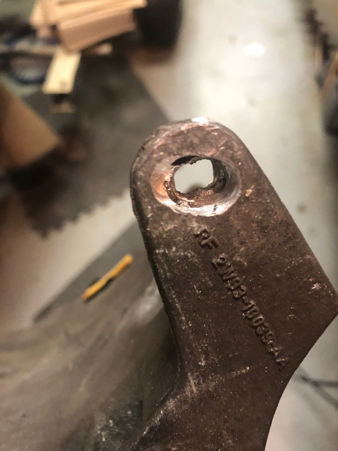

The suggested grip sockets would not work for me, so I proceeded to remove the fans to gain access from the front. The radiator did not have to be removed but it did have to be drained because the hoses were in the way. This gave me access to drill out the stud with my pneumatic drill as its got a short handle. I wore out a drill bit doing this and staying straight in the stud proved difficult as the drill constantly got off the stud and into the softer alloy of the bracket so it got wallowed out. I switched to a pneumatic die grinder with a 3 inch wheel to grind through the stud. This was successful after wearing out several blades.

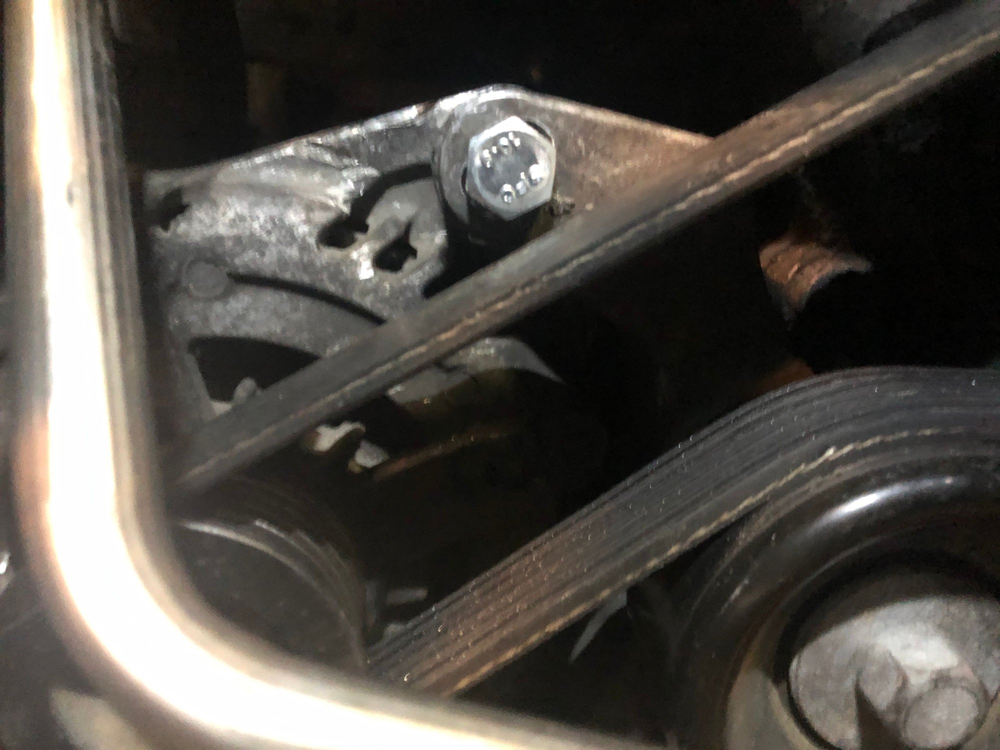

I then had to remove the bracket as the wallowed out hole needed cleaning up to receive a bolt now in place of a stud. I used a 5/16 bolt and nut from Lowes.

Wallowed out bracket

I was worried that the head of my new bolt would interfere with the belt but clearance is good.
Jaguar should have done this in the first place. Clearance is fine.

I would've placed a steel washer under that bolt head.
But all in all nice job!
