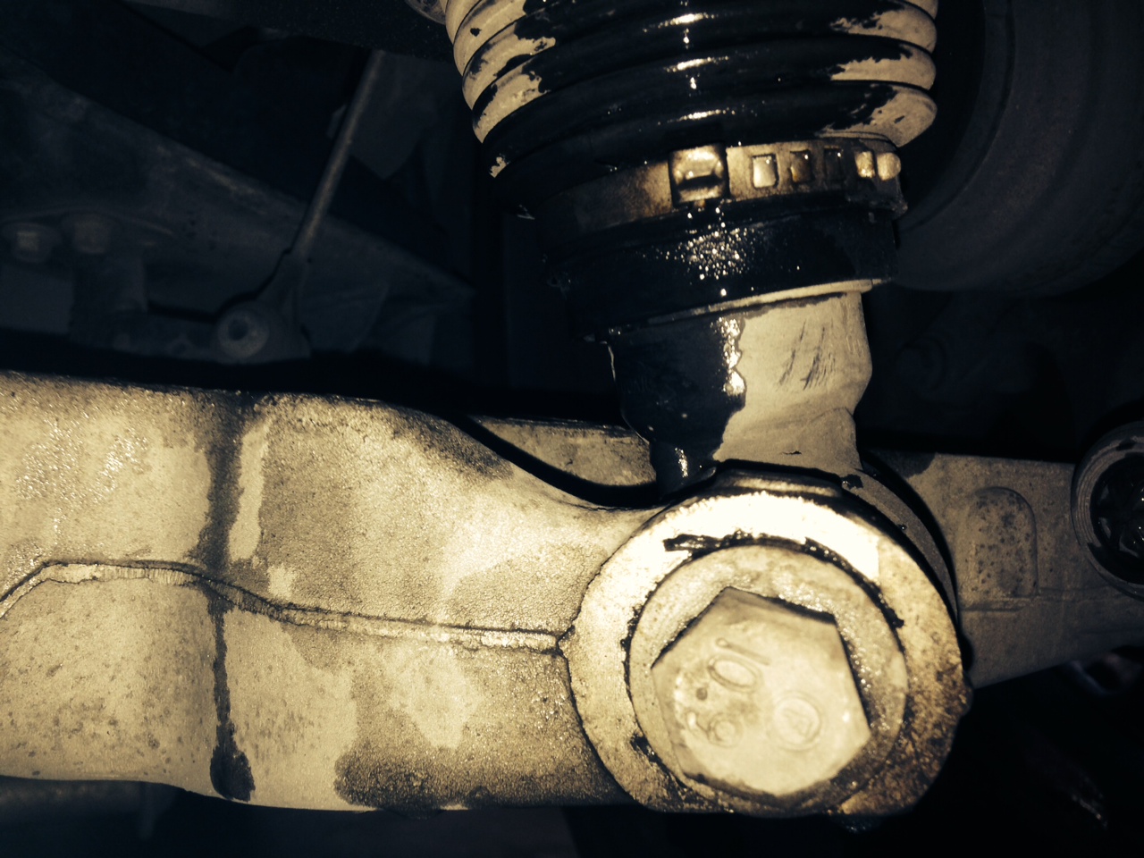

HI, i did the old soapy water test and Ive located my air suspension leak down to the base of the rear passenger side shock. its leaking where the metal band tightens around the bottom. I was wandering if anyone has had luck patching one of these. If not ive heard Arnott is the place to go for replacements. Ive also heard that their re-manufactured shocks could be old worn out ones just repainted and fitted with new boots. anyone had bad experiences with these?

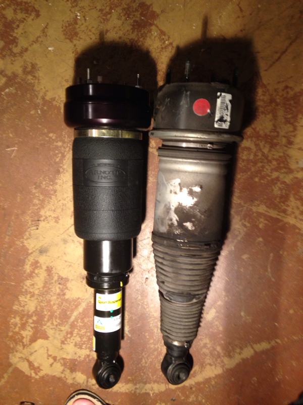

You may have seen my recent posts re air suspension issues. Don't know about repairing a leaky shock, but am now qualified to comment on two variables: Arnotts and Bagpiping Andy. My car is a 2004 XJR with 48K miles.
Arnotts: Suspected a leak because of noises and error signals on dash. Ordered a re-manufactured front shock from Arnott. It certainly has no remote similarity to an old worn out one. By all appearances, it was re-manufactured to the highest standard. Arnott shipped from 3000 miles away and it arrived on the date promised. You can telephone, as I did, and get an intelligent, personable, and helpful person. I give them the highest recommendation! The instructional videos they have are as good as they get.
BagpipingAndy: Since many members had suggested that the compressor frequently gave-out in the 40K+ mileage range, I thought that I should replace the compressor. Dealer had a rebuilt one for $1200; Arnott had a rebuilt one for 499 (same make as dealer); Bagpiping Andy had seals for $60.00. With much skepticism, I ordered the seal from Andy in Scotland (At this point, my wife looked at me as though I had surely gone around the bend.) Andy shipped the seals via the post office and they arrived in just a few days. They installed just as easily as he said they would. I also give Andy the highest recommendation.
Bottom line: Car rides like a new one! Thanks to Arnott and members of this forum, replacing the shock was so enjoyable, I'm tempted to order the other 3 after the holidays.

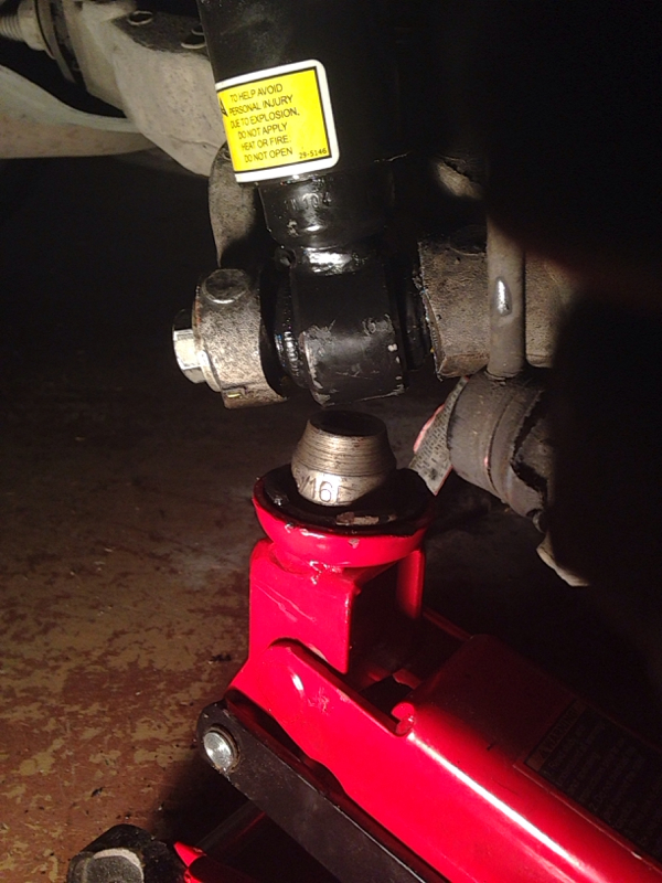

We'll I ordered it today, should be here by weds. Im not driving it until I put the new one on so I don't wear out the compressor with a leaky system. It can't get here soon enough as my backup car is a minivan haha

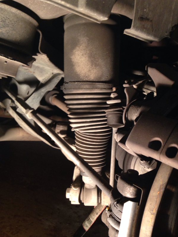

I had the old one off and just as I finished, the re-built one arrived.
The T60 Star Bit will need a long lever to break it loose. I think what I used is called a breaker bar? Might be able to do it with a regular length socket wrench.
Notice on the video the use of an allen wrench in conjunction with the box wrench on one of the bolts.
I use a floor jack with jack stands. I found that a small hydraulic jack that I have had for 40 years and used 3 times, along with a block of wood, was helpful in lifting the assembly up to bolt things back together again.

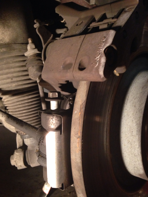

We'll I did it. Unlike the car in the instruction manual Mine has the electronic e-brake caliper which completely blocks removal of the stabilizer arm bolt. After unsuccessfully trying to loosen the caliper I said to heck with it and just wrestled the old airshock out of there. It took some doing but I got it. Then came time to replace with the new one, the base seemed too wide to fit in place at first but Vaseline and wd40 , some coaxing with the floor jack and a wide vocabulary of cuss words and it was FINALLY in place. Topside in the trunk. I re connected the air line and made sure the wire clip was down in there and clicked in. I plugged back in the relay under the hood and started her up. The tail end rose up and the Air Suspension fault lite vanished. And immediately a new one appeared "Cats System Fault"..... Ahhhh. $&@$"/@! What does that mean? Ugh anyway it rides good, maybe a bit firmer but not too noticeable. Any ideas on that cats fault?? It's a remanufactured one which they told me works with cats.

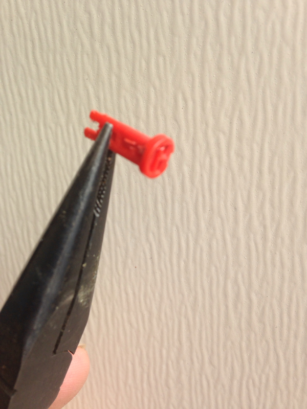

Well it was displaying 'air suspension fault' which was cured by installing the arnott shock. However Now it is displaying 'cats system fault'.
I suspect its either the wire connector (which i checked and seems to be ok) or the system needs to be reset. Im going to mess with it this weekend and if i cant fix it ill call arnott on monday and question them lol
I noticed, quite by accident, that there are two prongs in the electrical plug receptacle into the top of the shock before I was able to do any damage. Perhaps you might check yours.
This is on another thread on our forum in response to a scenario sounding like yours:
"Finally got the car to the dealer yesterday. The service manager informed me that the tech discovered the 2 pins on the top of the strut were either missing or pushed down to the point where the pigtail could not plug in fully. So as I drive home I call armory industries and they inform me that do a 100% inspection on all of these before they leave their facility. So I finally arrive home and plan to call the guy who installed the strut for me and ask him why he jammed the connector in to the point it damaged the pins. I decide to take a look myself when I arrive home. To my surprise I notice there is a red piece on the end of the pigtail on the drivers side that I don't see on the passenger side one. I look into the top of the strut and see the red plastic piece that should be on the pigtail inside the connector on the strut. I remove it with a pair of needle nose pliers and this exposes the 2 pins. I then snap the red plastic piece back onto the pigtail connector, plug it in, start the car and the code is GONE. I,m not sure how a trained jaguar mechanic misses this and I pick up on it. Good news is the cats system is now working as it should. Bad news is I still hear a rattle on that side. It seems to be at lower speeds. On to the next mystery!"

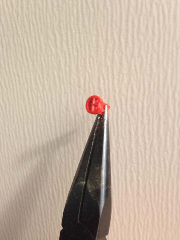

Well i found it, just a little red plastic piece down in the to of the connector, i guess its ti protect the pins in transit. Plucked it out with some needle nose plier hooked it up and all is fixed. Rides like a brand new car! Thankyall for all the help
