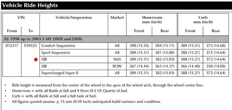

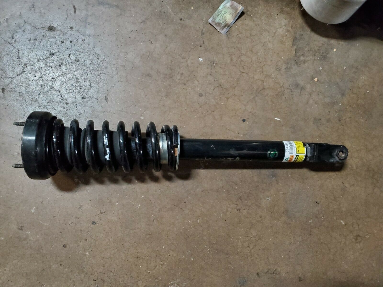

My (US) '04 X350 came fitted with a brand new set of Arnott conversion shocks. I read that they will settle a bit but now after a year, I'm still almost an inch over factory spec. I'd like to lower it really just for looks and plan on taking it to a spring shop to have it done right. Based upon this chart of listed factory curb weight (air system) ride heights at rest, should I just subtract -15mm to get to the air ride's 100+mph dynamic spec? So the 388/372mm spec would then call for 373/357mm for my fixed height Arnott springs?

take a good look at that spec you just posted that seems to be for the x308 1998-2003
