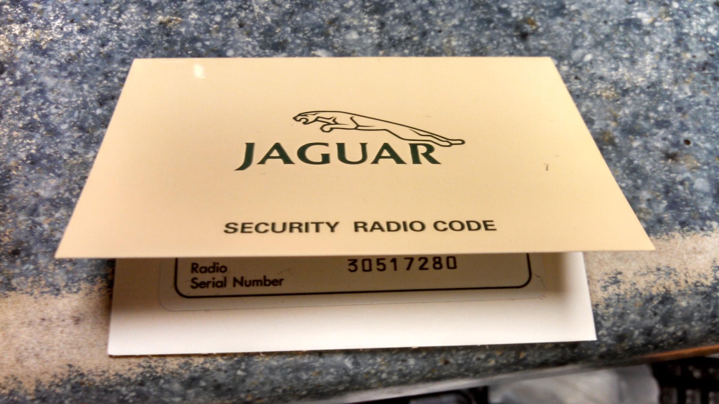

I did look around and I am pretty sure you will need a radio code if the battery is replaced or goes dead. Only way to prevent this during battery replacement, if not already happened since you say the battery was dead, is to hook up a battery charger or jumper pack before disconnecting the battery. Of course you have to be extremely careful as the positive cable will still be charged when the original battery is taken out, and if the positive cable touches anything besides the new positive battery post in the process, you will have major problems.
Below is the radio card and instruction sheet from my car. I also forgot to mention, the dealer may have to take out the some of the dash to get the radio out to get the serial number which could get very very costly so I would do everything I could to prevent loss of power to the car.

As I mentioned, I've disconnected the battery in our '04 XJR twice and didn't need the radio code afterward, I just needed to reset the EPB. I believe this information was in the owner's manual.
I wonder if there was a break in the '04 model year and a code was required either before or after a certain VIN? Our '93 XJ40 radio requires a code (which a dealer can usually provide from the VIN), but our '04 X350 apparently doesn't.

Starting from X308, if the radio is configured for the U.S. it will not require a code.
If the radion is configured for Europe it will require a code. You can get a code from a dealer or there's a workaround - press, at the same time, 3 buttons: A.mem, PTY and >> and it will reset a code
