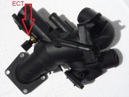

Unfortunately the ECT sensor is on the back side of the coolant crossover pipe (aka thermostat housing)... which means you can't access it without removing either the coolant crossover or the intake manifold. There is a junction connector on the LH valve cover bracket where you can disconnect the ECT and measure the resistance.

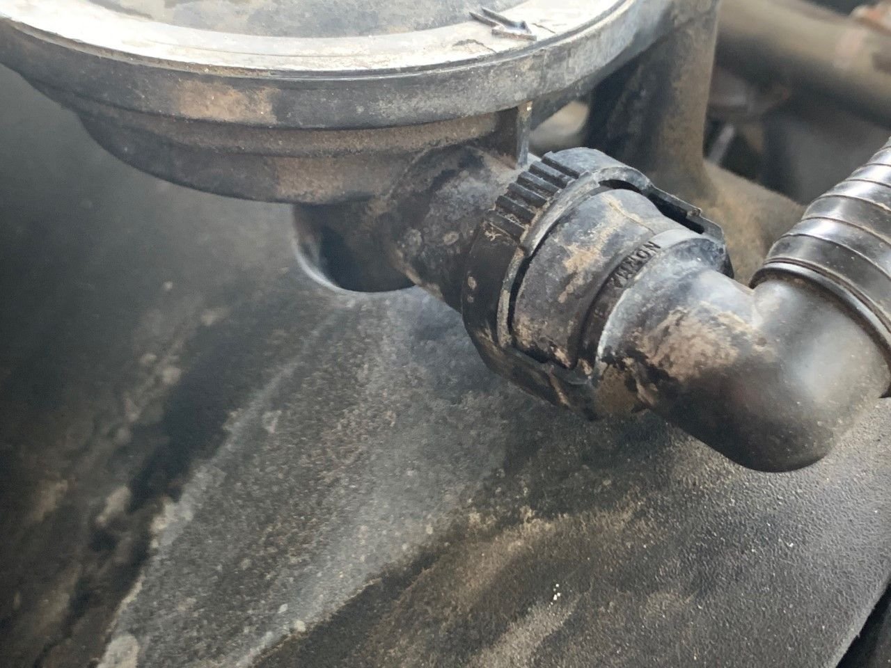

There are many potential air leaks on this AJ V8 that you can check, but those 2 seals pictured are for the VVT solenoids and not likely going to be your issue. They will leak oil and if you replace them only get OE replacements, the aftermarket will not last. You need to thoroughly clean all the oil oil before installing the new seal (read: clean it until there's no more oil, then clean some more).
Easiest way to diagnose your lean condition is with a smoke machine. Some other things to check include: cracks in air duct between MAF and throttle body, cracked PCV hoses, bad PCV valve, leaking o-ring at PCV to valve cover, broken vacuum lines to fuel pressure regulator and/or AIR injection solenoids. Could also be leaking intake manifold gaskets themselves--there are silicone gaskets between the plastic and metal portions of the intake.
Note that the PCV valve on these cars does make a hissing sound normally, which can be confused for a vacuum leak, but it's one of those things you'll have to hear a working unit to distinguish from an actual vacuum leak.

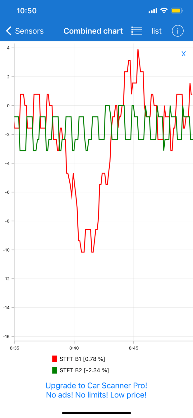

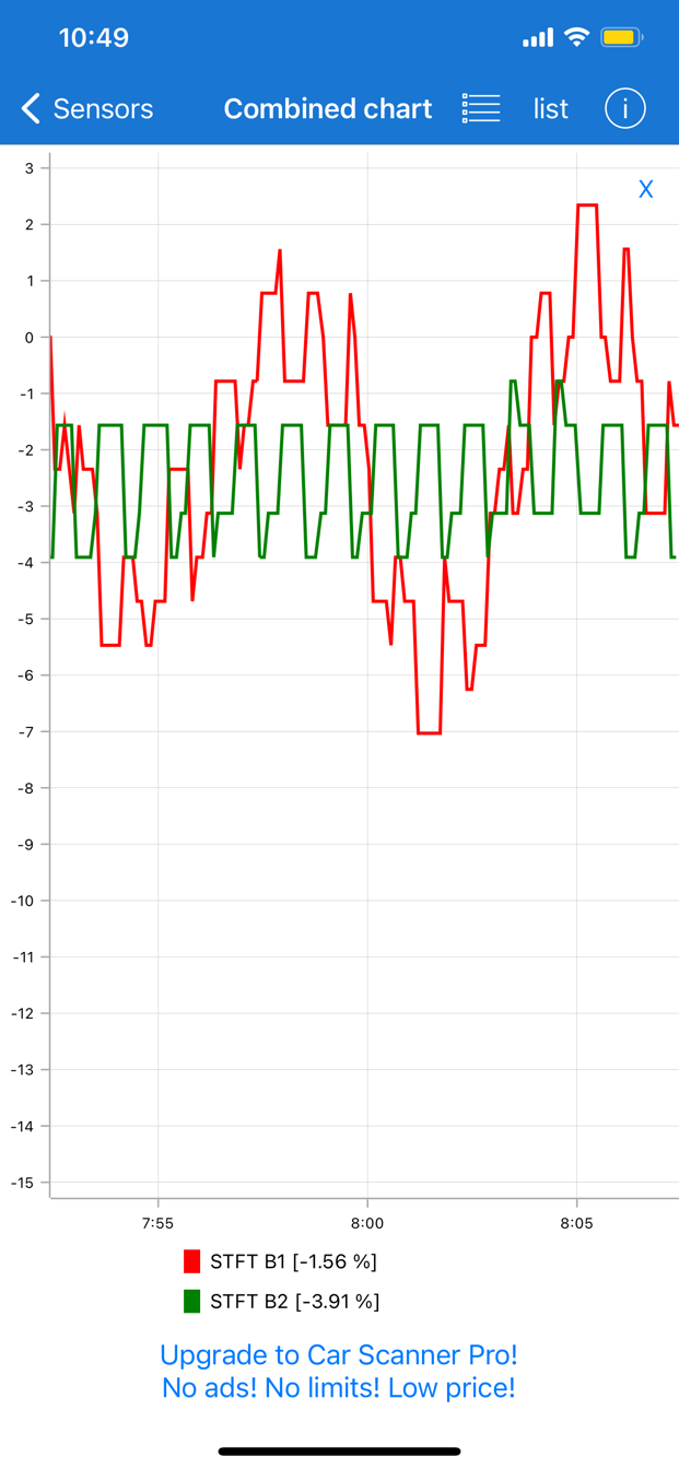

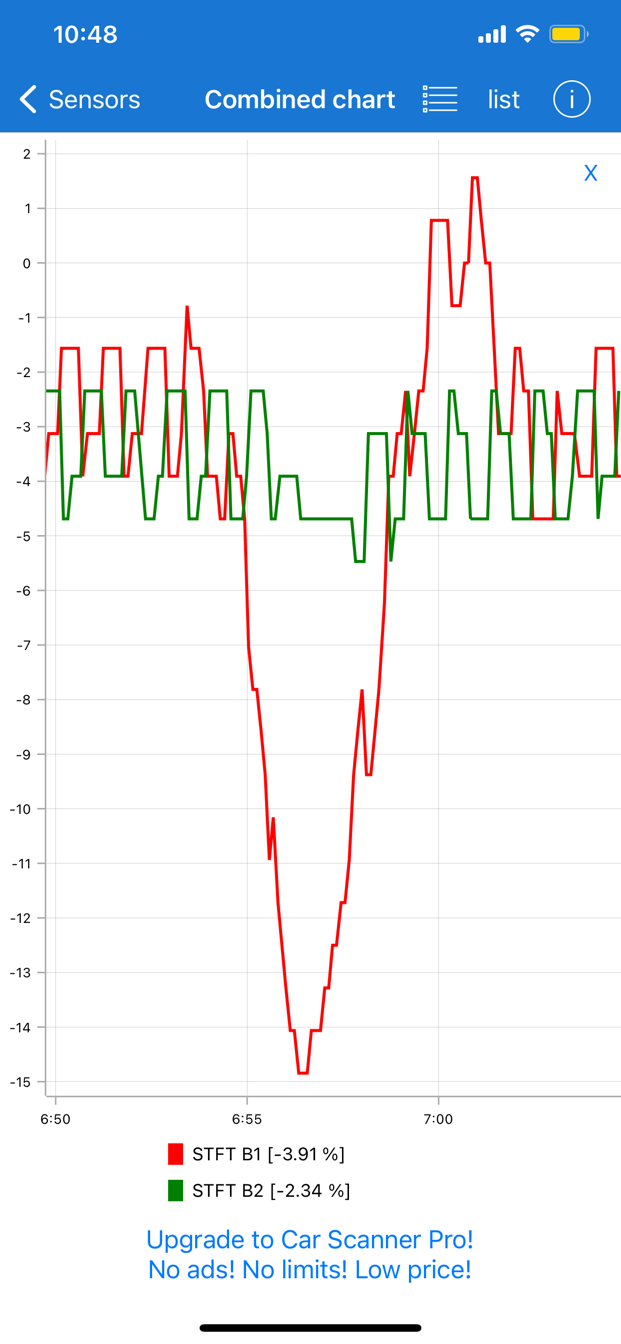

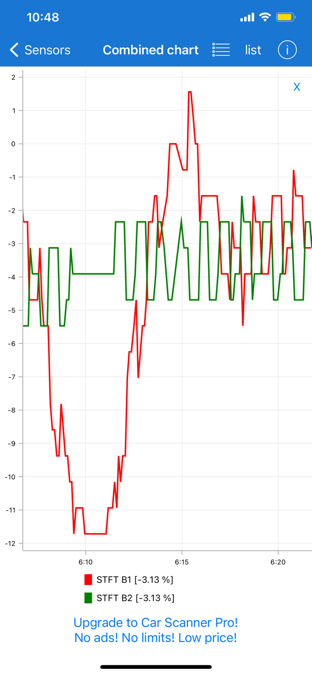

Thanks so much for your continued help. I tried to get a smoke machine but couldn't get hold of one. I also thought about blowing smoke from a cigar in there, but I can't work out which hose I could blow it into without the motor cutting out. I could hear a loud hissing from the PCV valve, and a slight hissing from where the PCV valve connects to the front / center of the engine, so I decided to spray throttle body cleaner around all of the hoses and monitor the fuel trims.
When I spray it around where the PCV connects to the front / center of the engine, the fuel trims go like this
And when I spray it around the PCV valve itself, they go like this
Any ideas?

So the big dips in the red graph line are when you are spraying the TB cleaner? That would be normal--the solvent spray is acting like fuel and the O2 sensors see this, so the ECM tries to pull back the fuel trims (make them more negative) to reduce the fuel from the injectors. If so, you've found (part) of your problem.
The hose from the TB to the PCV has o-rings in those connectors. You can try and replace them if you have suitable sizes, or as a temp repair. Otherwise that PCV hose is available from Jaguar and may be the better solution, since the plastic hose is known to crack with age.
