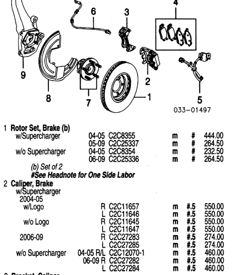

I need new front rotors. I overheated them, warped them, tried having them turned and no luck. I go to AutoZone, they don't have rotors for an 04 xj8, but they have them for 06 & 07. I have the typical Ford calipers. Does the 04 xj share the same rotors with the other models up to 2008?

Is your car a bog standard XJ8, no supercharging etc ?
Have a look at this British website. You'll see there is a lot of variety of front discs for the X350 model ! Many discs also fit other Jaguars.
Brakes | Jaguar XJ - X350 - XJR | British Parts UK

Look at www.Rockauto.com they have rotors and pads reasonable. I believe that our rotors interchange with the 2000+ Thunderbirds and Lincoln LS. I just put fronts on my car a couple of months ago.

You can use this as a reference:
Attached Thumbnails brake rotors-front-brake-parts.png   brake rotors-front-brake-parts2.png
