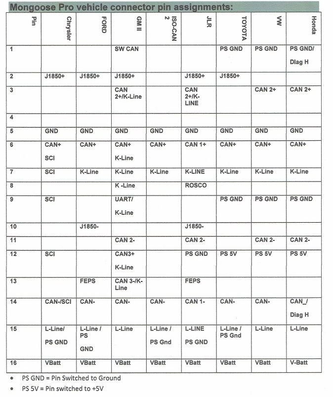

And be aware there were about a dozen variations of the Drew Tech. Mongoose. So another complication.
Here are the wire differences.
They are all similar but not exactly the same.

There are several different DrewTech mongoose cables for different manufacturers. The pin outs are different.
Also SDD 130-131 need to run on Windows XP. I use a VM with on a windows 10 laptop. Works fine.
