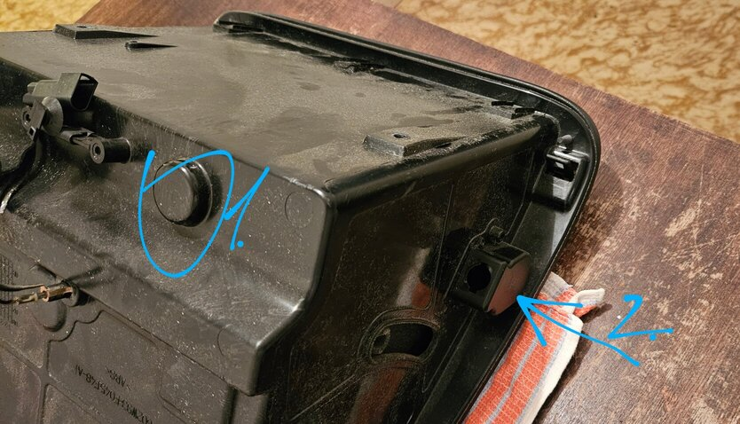

I struggled at two points when pulling the thing out. First was, naturally, the connector, second was something I tried to explain in this post:
Originally Posted by Jaroslav Záruba
Also when I was done with all the bolts and screws listed in the guide the assembly still wouldn't come out, it felt like there must be one more screw hidden somewhere around the lamp. I was almost getting emotional, until I applied some force in the direction hinted above (2.), i.e. where the lamp sits.
