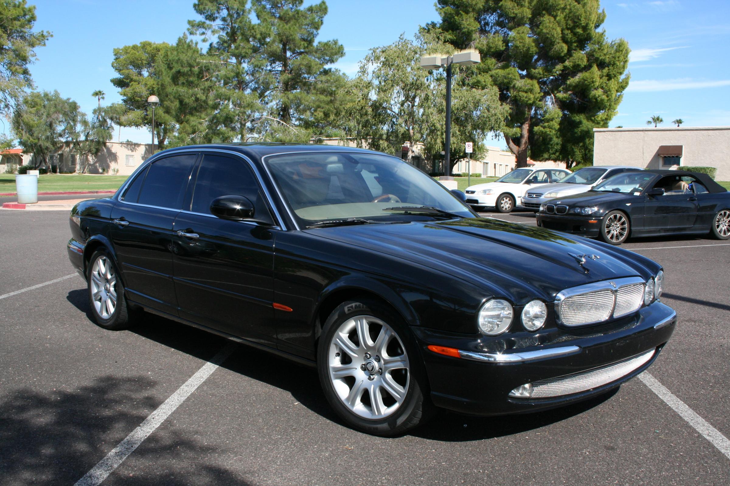

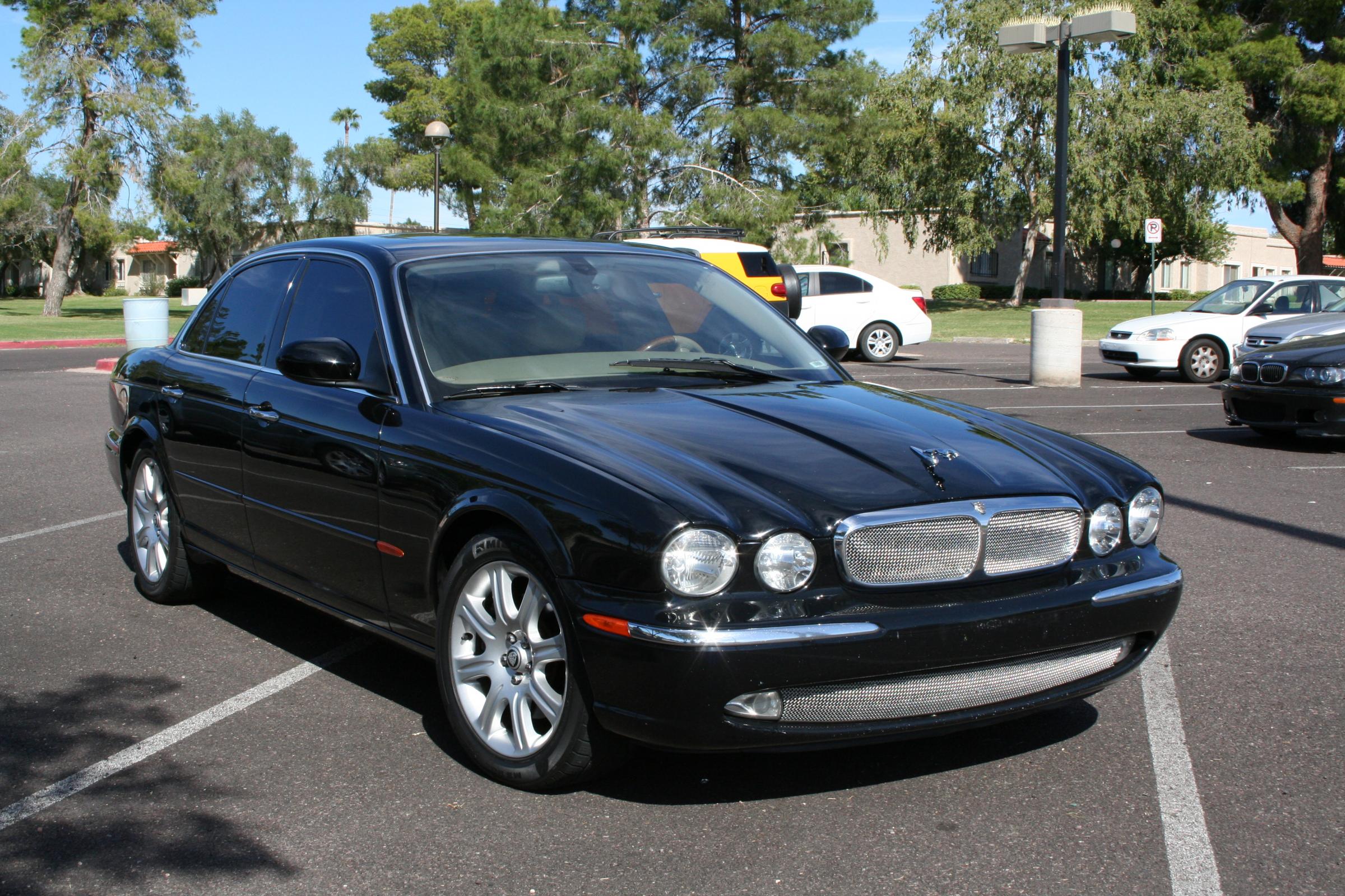

O,k so after installing the s type coil overs , disconnect the back seat module ,.i replace the egr valve cause i was having the p0400 code on the check engine light....(this was done after disconecting tha back module)..
i try to start the car and nothing ,.( i forgot to disconnect the battery while doing all this ) all the lights of the christmas tree came on ,. with all kinds of fault codes from everywere ...so i got scare no crank nothing just lights ,,,, so i disconnect the battery for a good 2 hrs to see if the computer would read that the ASM was deleted or something ...same thing nothing ,all lights again with all the codes that i didnt have before ...,,,,finally i grab my scanner and erase all the codes before atemting to start and vouala !!! it did star with no codes lights or engine lights so i went for a ride a few miles all good so far after 30 or so mnts driving ..thanks forum for all ur help..
the ride its nice felt like my old mercedes CLK 320 with sport suspension i,m gona change the green ones i have to black ones standard ride for a little more softer ride...
