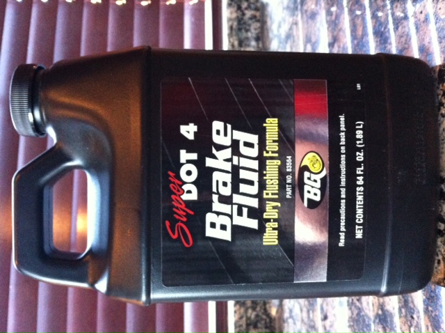

Found a good brake fluid for $70, going to flush the system again tomorrow.
