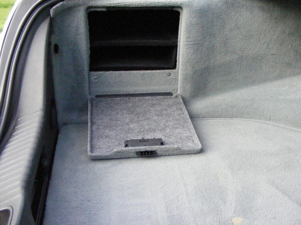

First, in my 04 XJ8, I have the slots in the trunk for extra systems like a CD changer.
Can I install a CD changer? Is there anything else I can install? Is the wiring present by design or will I need to complete that too? What's available and how can I do it?
Secondly, I found these on eBay for a pretty decent price and I want to know if the VDP door speakers will fit my current 04 XJ8? What do you think?

The slots are for cd changer and/or DVD navigation unit. You also need the correct fiber optic cables to install these and for navigation also the screen upfront.
No idea if these speakers fit.
