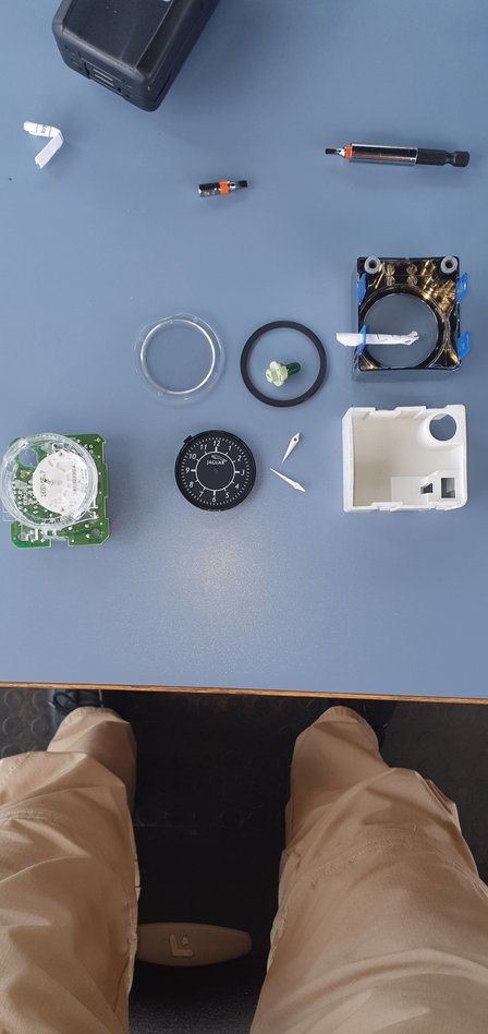

Old Sep 28, 2024 | 08:59 AM
Petz's Avatar
Joined: Jan 2021
Posts: 613
Likes: 141
From: KEHLEN , LUXEMBOURG
took it apart to switch for a daimler clock 12h plate
Old Sep 30, 2024 | 09:21 AM
Wingrider's Avatar
Joined: Sep 2016
Posts: 3,481
Likes: 879
From: Stow Ohio
Looks like a Lincoln clock face to me, both Ford products.
Fits into the space very nicely, & the color match looks good.
