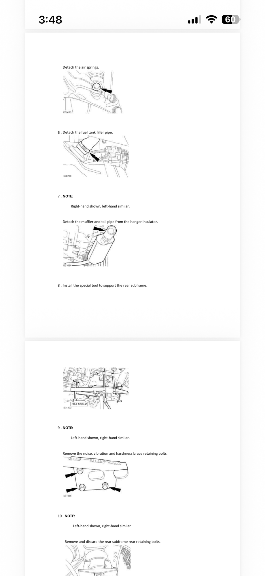

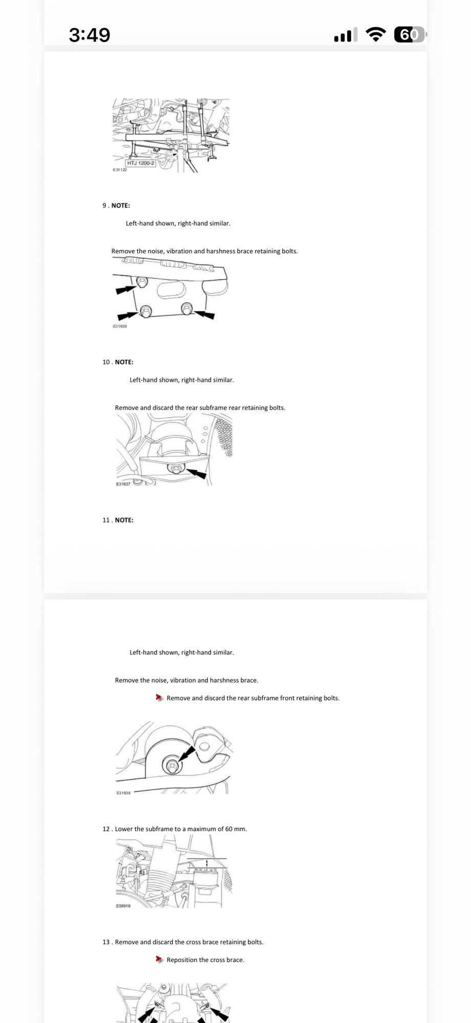

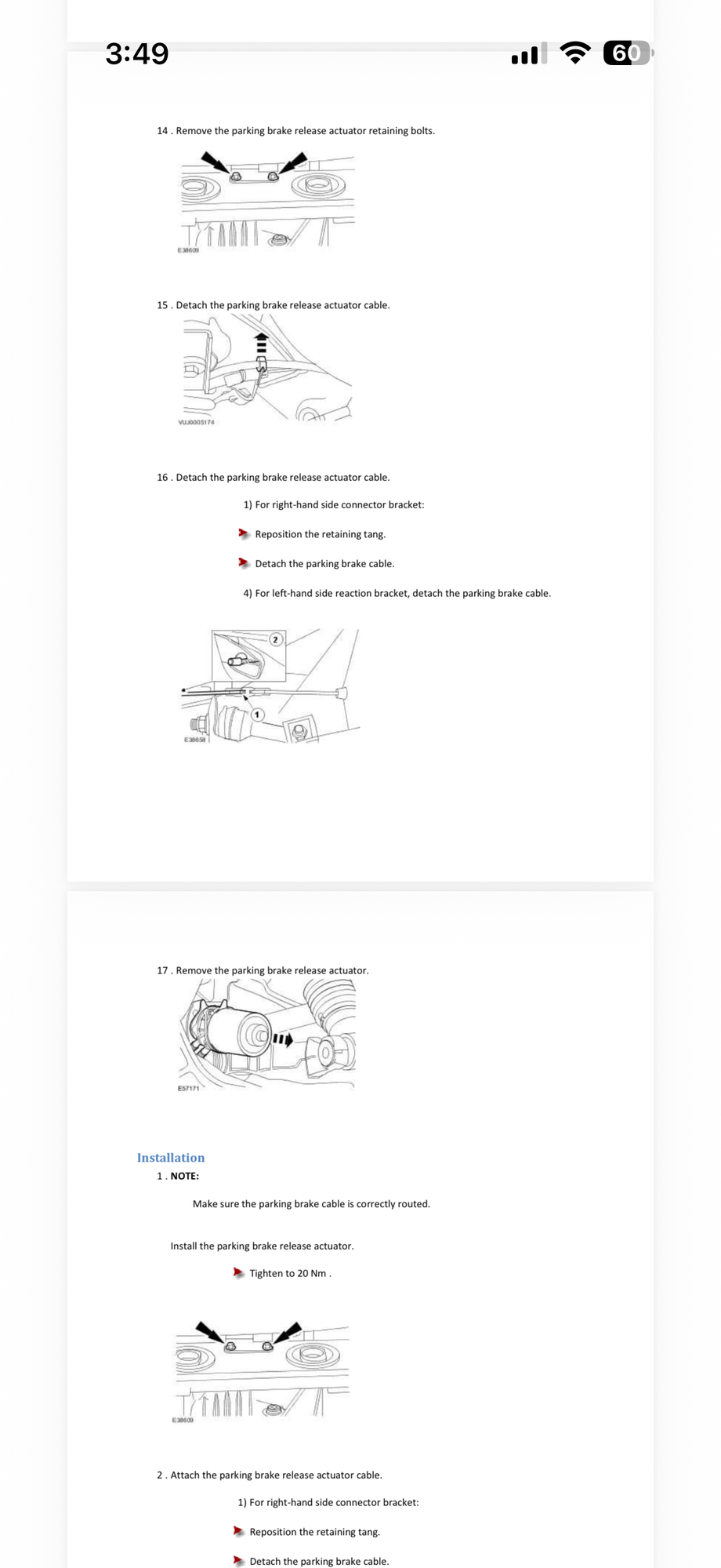

Hello my jaguar xj8 needs parking brake cables and the only way I can see replacing them is too drop the entire subframe has anyone done this job without dropping the subframe?

It says the subframe has too be lowered just tryna see if anyone really had too.

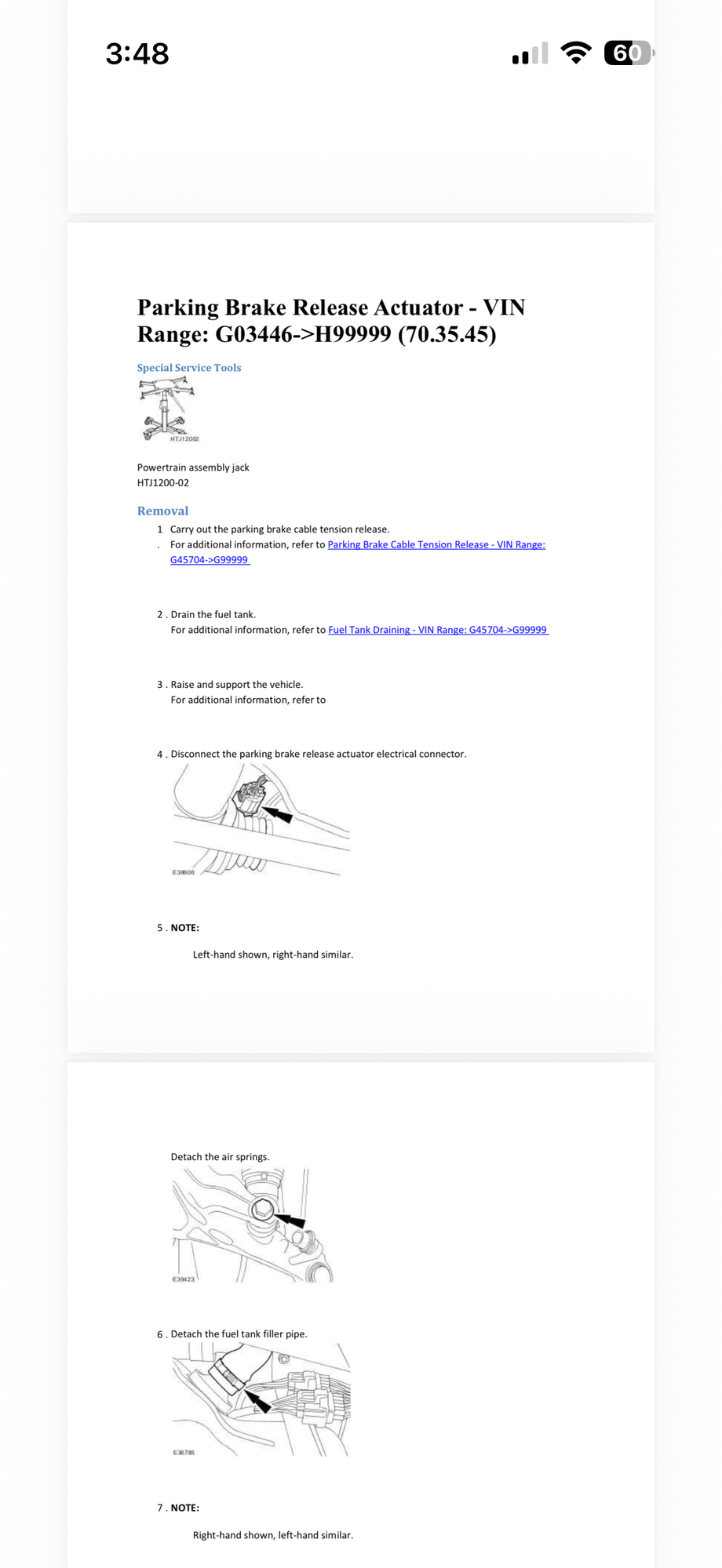

And I can’t find anything about removing the parking brake cables just the actuator

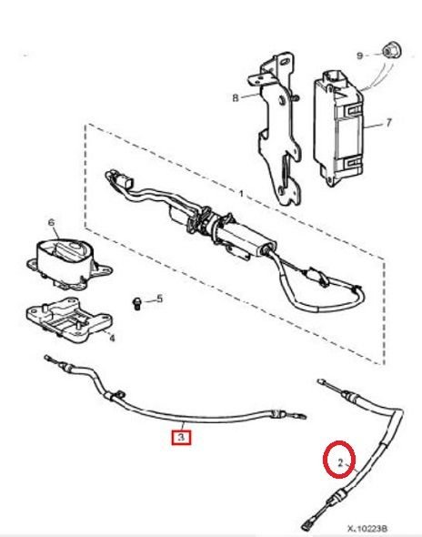

OK thanks much for the car information. The later cars had replaceable cables on each side.
Item 2 and 3 in the diagram. This is from the wonderful JPART.
They could be rusted up too. Just something to check.
The actuator (Item #1) removal depends on your VIN which you did not post? Just the last 6 digits is needed.
If it's between G03446 to H99999 then yes the rear sub-frame needs to be dropped. Big job!
If it's between G0001 and G03445 then no it does not.
