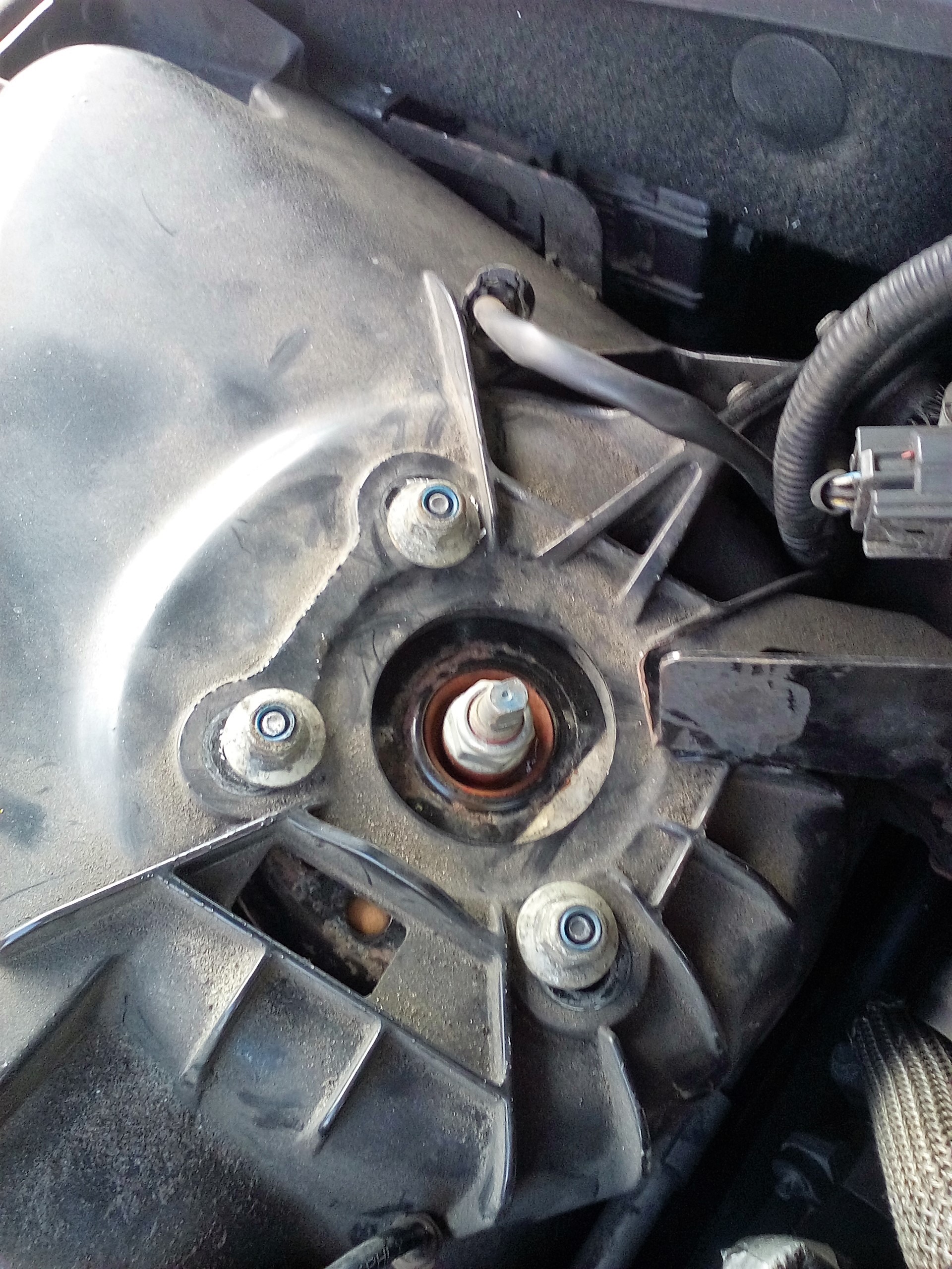

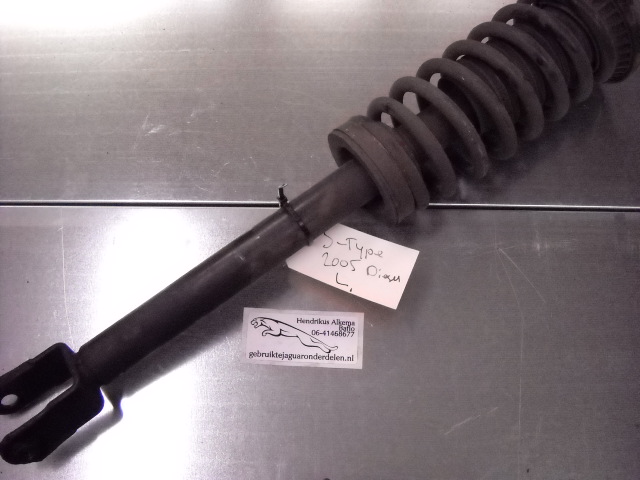

Thanks a lot sexy beast! The air suspension on my car was broken. First i tryd to repair the air pump. That din`t work. Found out that one of the coilovers was leak. After reading the post i wanted to try if it realy worked. Bought the 4 s types springs for 150 euro (i live in the netherlands) first had the springs of a 1999 model. They dont fit. Swapt tham for the 2005 model year springs. my macanic instald the springs. Charget me 200 euro`s. (told me he spend 8 ours) i was supriced how good the ride was. A bit stifer than the air spring. Got the air suspension and the cats sysem defect waring on my display. Ive decided to ignore them. Very happy with my x350 again!!!
Attached Thumbnails cheaper coilover suspension conversion-20170803_155835.jpg   cheaper coilover suspension conversion-20170803_135046.jpg   cheaper coilover suspension conversion-032.jpg   cheaper coilover suspension conversion-sam_4264.jpg   cheaper coilover suspension conversion-20170803_161345.jpg
