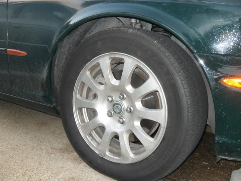

the swapped worked! the ride height and quality is perfect. i actually prefer the ride of the s-type coilovers over the stock airbags because the car felt a little more responsive and and connected to the road. The only issue was the top mounts did not line up perfectly with the stock holes in the strut mounts of the car. Easy fix since my mechanic is a badass and we both agreed to just let him drill the holes to make them fit. As you can see from the picture the holes are about 1/4 of an inch off and he had no problem making them fit. He is a long-time hot rodder and is good at making things fit. He assured me that this did not compromise the the integrity of the suspension system since they are such a tight fit and really have no where to go in an impact situation.
I ended up spending about $460 for all 4 springs/shocks thru ebay and they came from a 2004+ s-type v6. If anyone is in the Dallas area and needs a mechanic that can make this happen then by all means go to City Garage in Euless, TX and ask for Paul. He is the only guy i let touch my car since i'm a bit of a perfectionist and an amateur mechanic myself.
In case you were wondering about the visible pipe clamps on my exhaust.... yes i sawed off my rear mufflers and replaced them with pipe to retain my exhaust tips. I did this because its classier than driving around with my rear sections removed and my car still sounds awesome. I get compliments from my homies at UPS when they hear how BOSS my jag sounds. I've heard a sound clip before of an XJ8 with just the middle resonators removed and it sounded like crap. There is no comparison. If any or you are curious i would recommend you also unbolt your rear mufflers and enjoy the music. Its gonna drone a bit at low rpm's but it only takes a few minutes and it makes driving more fun you can also reduce the drone a bit by bolting on some turndowns if you decide to leave ur car that way.
Attached Thumbnails cheaper coilover suspension conversion-sdc12948.jpg   cheaper coilover suspension conversion-sdc12945.jpg   cheaper coilover suspension conversion-sdc12946.jpg

The front looks a bit high to me.

the ride home from the shop was terrible and extremely bumpy. i took the pics right after i got it back. the car sat for a couple hours and by the time i drove to the gym last night the new/used shocks settled in and felt great. the front looked a little higher because my mechanic ran out of time and my car still has a right rear airbag that he's gonna swap out next week. 1 new shock in the rear and 2 new struts in the front is the reason for the slight lift in the picture. I think the car actually sits a wee bit lower now that the fronts settled in. it definitely drives better and feels more sporty.
What i find odd about the left rear bag blowing is that the previous owner replaced that same bag a few years ago, about 40k miles. i suppose its from my enthusiastic driving style that puts so much pressure on that corner of the car
