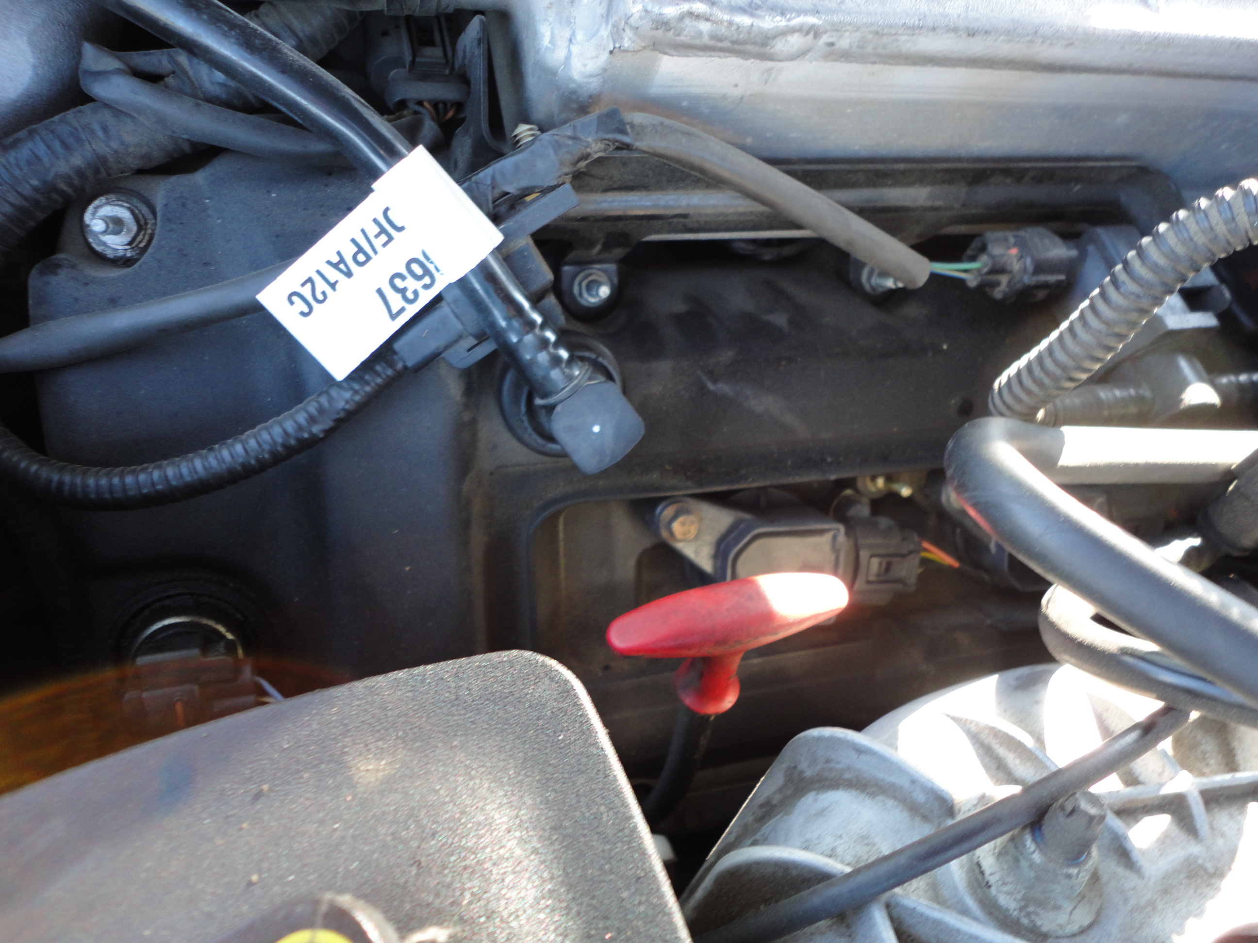

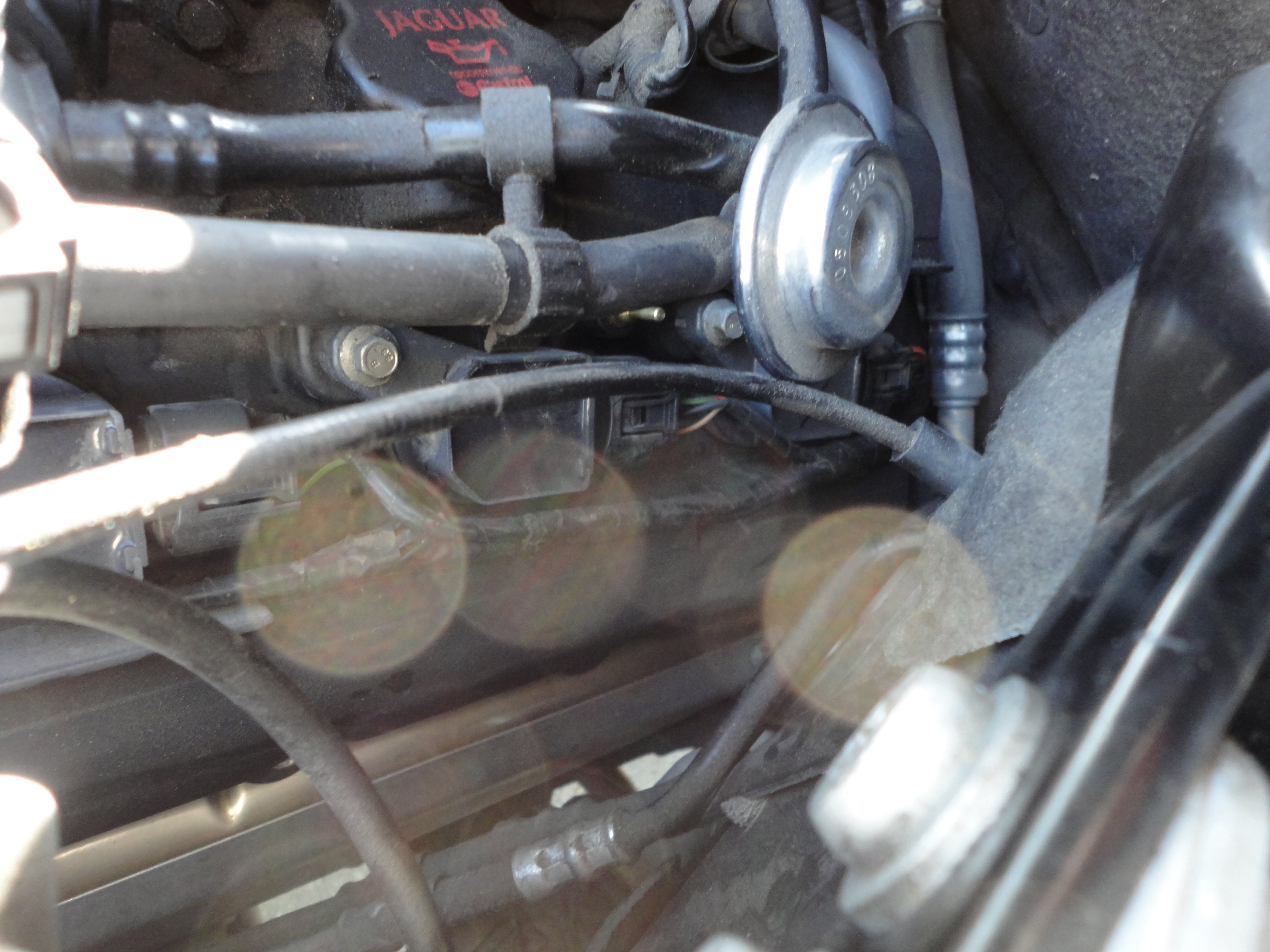

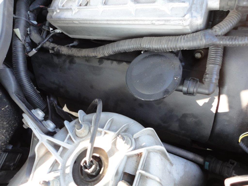

I used a pry bar to pop the covers loose after looking at the ebay link from woox4.
Getting access to the left rear coil looks like it will be tough. I think I saw a post about removing the cover for the brake master cylinder to get room. I will have to search.

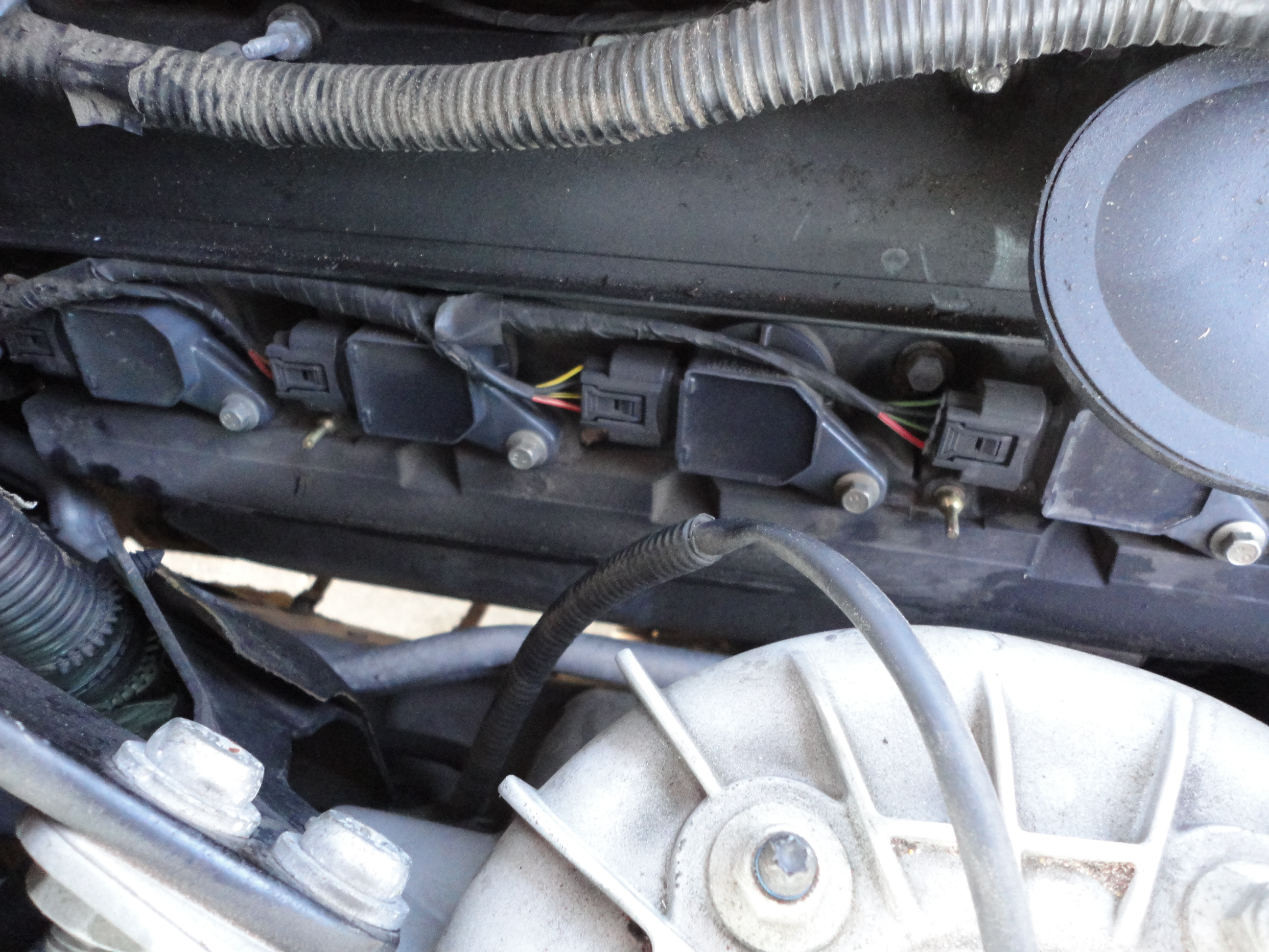

Here are photos

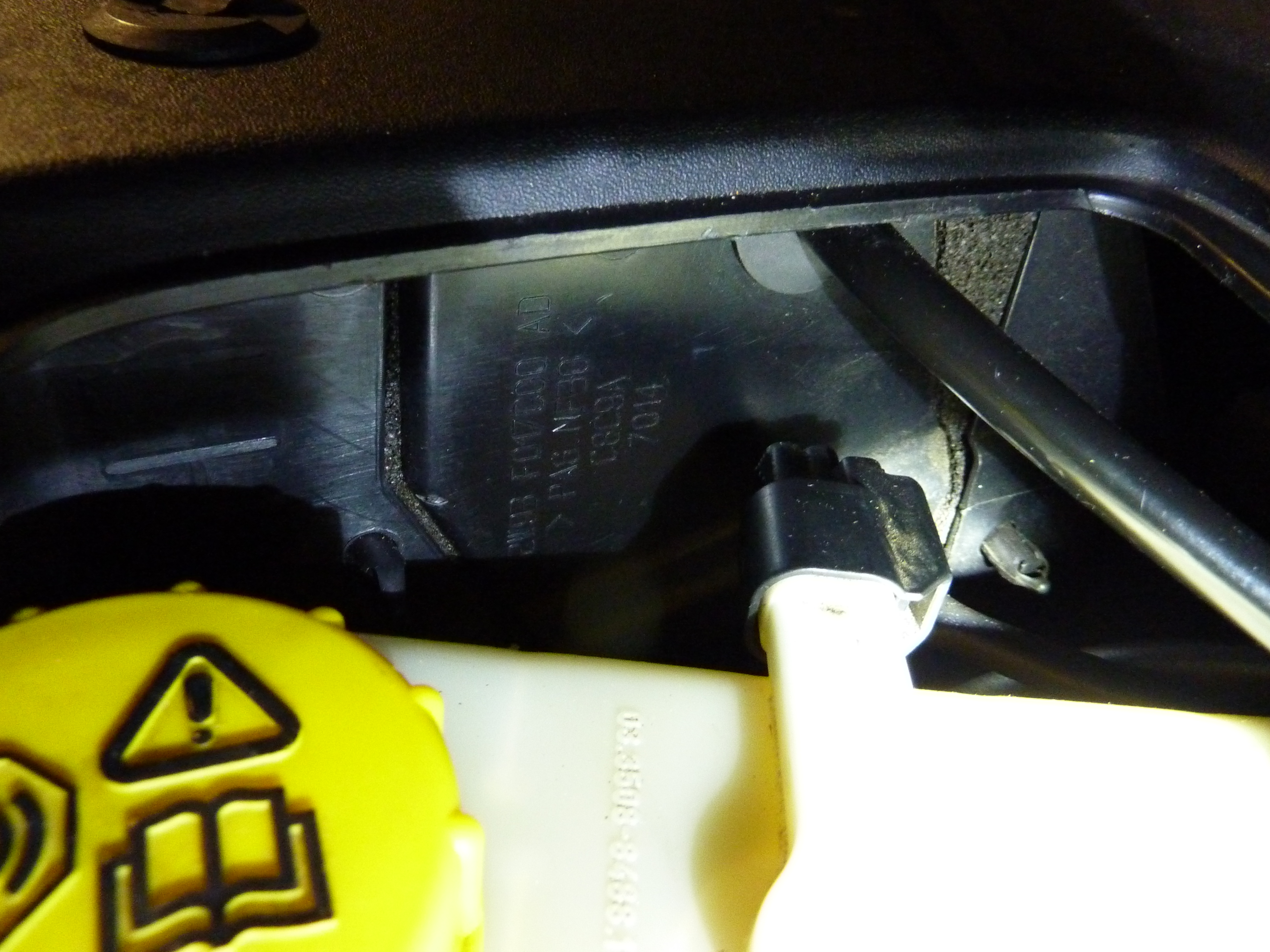

On my 2005 XJR there is such a panel. That is how I gained much easier access
to that driver side rear coil/spark plug.
Getting that panel off however is a little tough.
The black tubing goes thru the panel on my car.
Appears that L-R coil will be an issue, but it is not all that difficult. A little turning, & it can be pulled up and out without much resistance at all. Plug is then removed with same extension, flex joint, & socket as the rest. A little never seize on the threads after checking the gap, reassemble, test drive.
