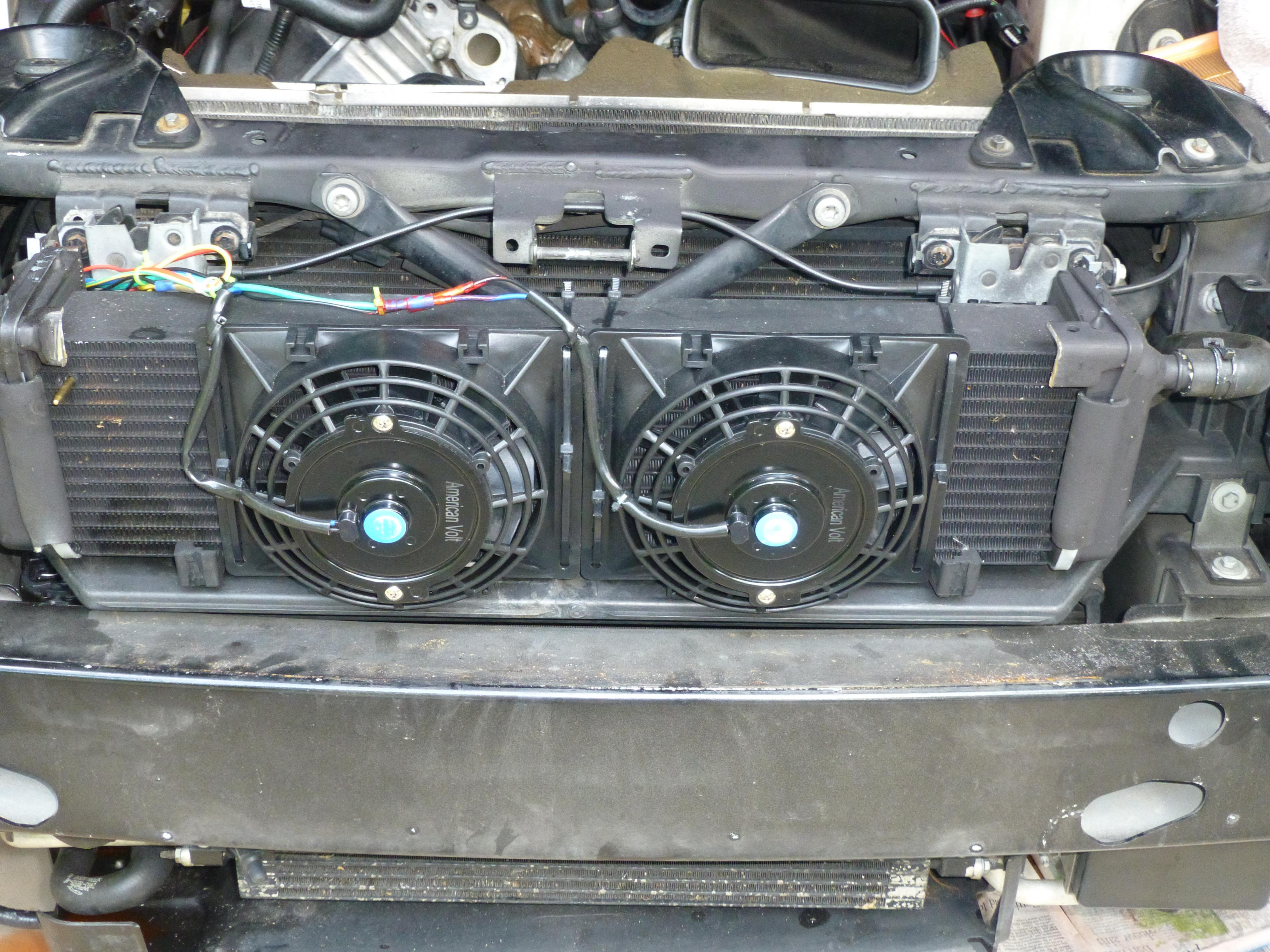

I also installed an additional intercooler radiator to help with extra heat generated by a faster spinning supercharger as well as an upgraded IC pump.
I added two 6" pusher fans on that radiator.
