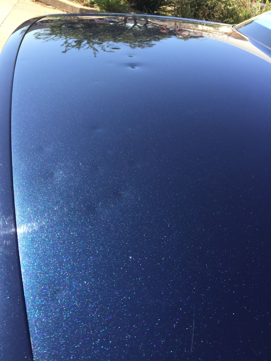

Here are some pictures that I just took of the damage. In the second picture it appears to have scratches, or something. It doesn't, I don't know what that is. I just washed the car and I think that is lint from the cloth, or something, but I didn't see that when I took the picture, weird! Also, in the third picture you can see that a couple of the dents are a little deeper than most of the rest, but there are only a couple of those.

Looking at the photo, I think you might get away with a PDR, but you won't know until a PDR man has had a go at them. It must have been some hail storm to make dents like that !!

I'm sorry about the damage from the storm. The one problem I see from the photos is that a few of the dens may be near a support brace under the lid. If that is the case neither method will likely work. I grew up in northeastern Colorado and hail was very common. The damage could very from what you have to very, very, bad.. We used to have dents like you have on our light trucks and in the hot summer at harvest we would let them set in the bright sun then hit them with cold well water. Some would pop out some wouldn't. Dry ice would have probably worked better but we never tried that. (You should be able to get dry ice from a grocery store, I can here in northern California.) The main problem with the repaint is you will have new paint and old paint on the car and both will "age" differently. The match will probably look very good at first but you may begin to see a difference over time. A good body shop can minimize the appearance difference better than a cheaper shop. Since the entire lid will be repainted you may not be as bad as you fear. Check with local body shop supply.places and see if they can recommend a good shop.

A GOOD PDR should be able to get those dents out I've seen worse pulled out of aluminum bodys. As stated prior, the braces might be in the way, but many times a good PDR can get around most of them. When I had PDR done on my car right after purchase, I was worried the aluminum wouldn't hold the repair like steel. But 8 yrs later none of them came back.
