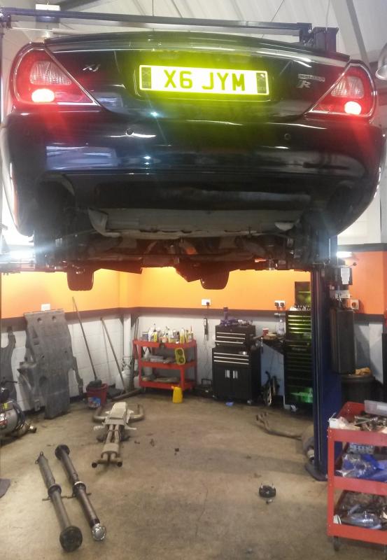

Car on the lift....looking a little bare

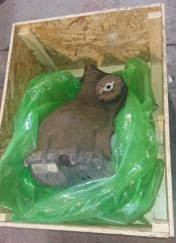

Old diff removed.....

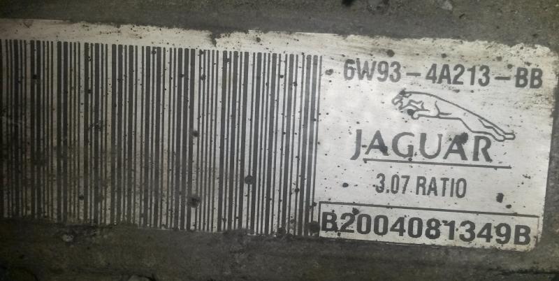

Old diff details....someone asked ratio's 3.07

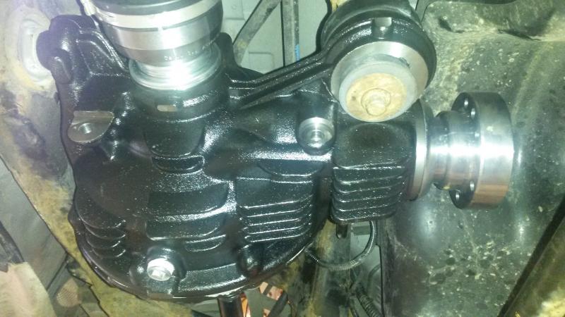

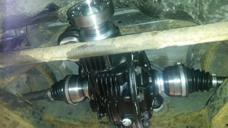

New diff installed on the car....
New diff c/w drive shafts installed.....

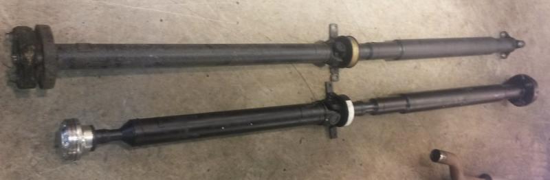

Prop shafts old v new.....

What was the condition of the rubber Jurid on the prop shaft? It looks a bit worse for wear in the photo.

The rubber jurid / doughnut wasn't great I was told. I was also informed that the new upgraded version does away with this and is a direct bolt on assy iirc

Originally Posted by JimC64
I did ask if they could open up the old diff to have a look at, see where the issues are, take some pics etc but it is a no go I'm afraid.
Does the reason for the "no go" due to restrictions related to exchanging the old diff for the new? Just curious.
Also, in the photo below, the left end of the new propshaft has a bright metal fitting that is different from the Jurid flexible coupling on the old propshaft. Are you saying that the Jurid will be eliminated altogether with the new propshaft?
Yes, I'm told that the new upgraded / superseded version has this fixing as opposed to the jurid flexible coupling.

Can you get a close-up of the replacement for the Jurid?
Difficult to tell on the old/new prop shaft comparison photo but it looks like a stainless/rubber sandwich construction.

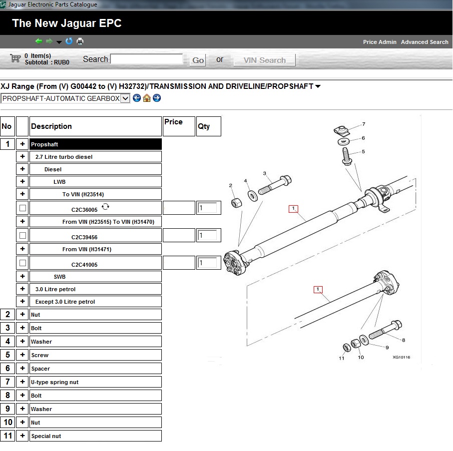

My JEPC from Nov 2013 shows three changes of prop shaft for the 2.7 TDi LWB.
Also be interesting to see how the Part Number on your replacement matches up with these P/N's.

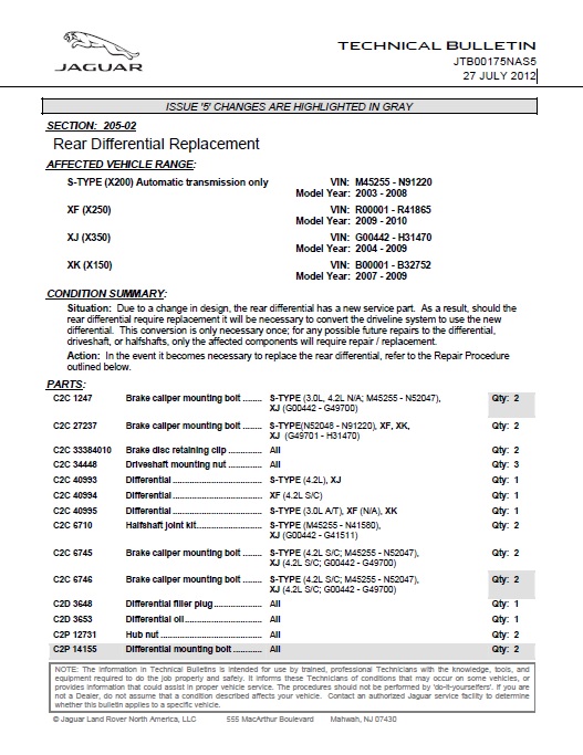

............ Prestige have the tsb ( all 57 pages or so they say ) relating to this, if I can get in to see them to get it, I'll post it to the forum. Jim
Jim,
If it's this TSB JTB00175NAS5 - Rear Differential Replacement, I have it as a PDF.
